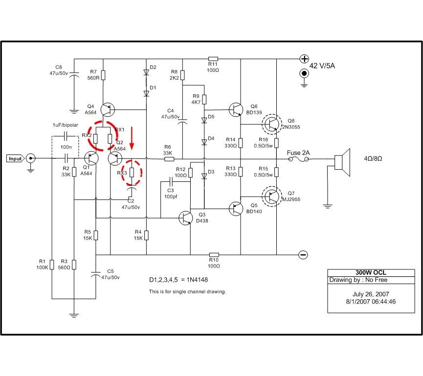

Anatech u mind i should add the series resistor like this ?{attach image}

Hi Bee C.,
Oui!
That's what I meant. The degeneration resistors may not be required. That is fine tuning. Get it working first and only change one thing at a time (so you know what worked and what didn't).

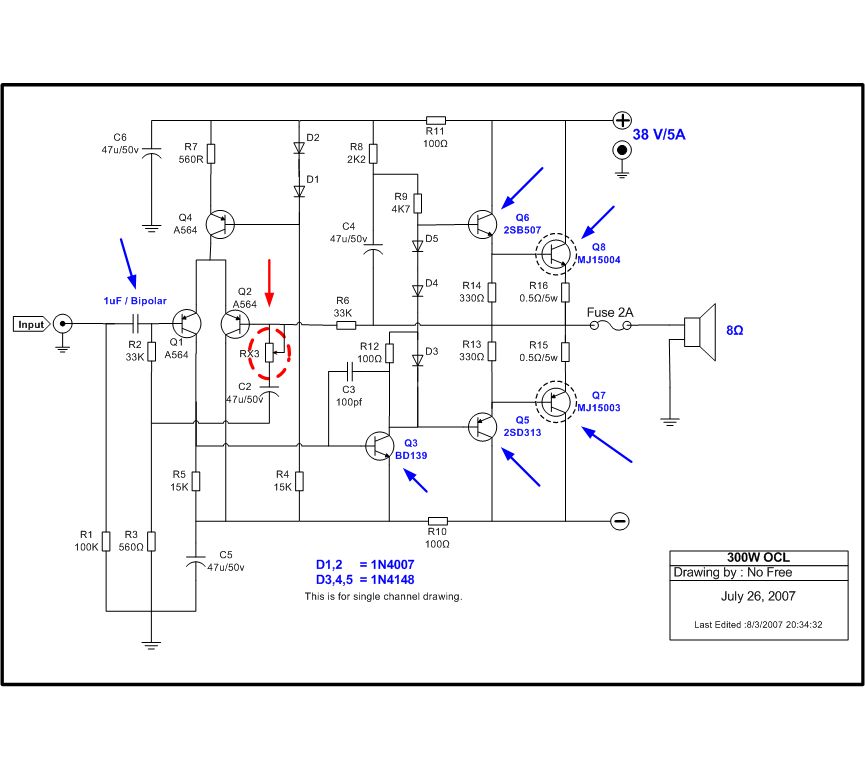

btw the scheme be like this one ?!

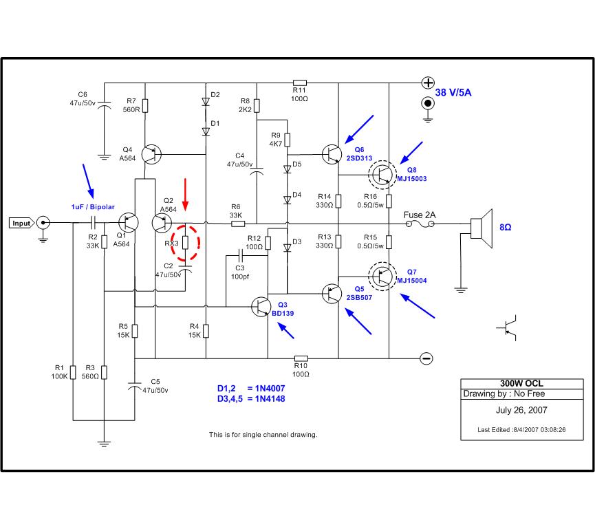

Hi Bee C.,
Q5 and Q6 need to be exchanged, Q7 and Q8 should be exchanged also. They are the wrong polarity for their position. That is to say that MJ15003 and 2SD313 are NPN while MJ15004 and 2SB507 are PNP. They would surely blow if connected the way you have shown.
Use a fixed resistor for RX3. Remember this sets your amplifier's gain along with R6.

It's good enought to have 100w at 8ohm if I give 30v ?
How exactly I can get current an or the voltage for the driver ? How if the final Tr I use TIP41C/TIP42C ?
Is the R6 as "bosstrap" ?

Hi Bee C.,
You need approximately 50 volt supplies to deliver 100 watts into 8 ohms. You would also require two pairs of strong output transistors such as MJ15022 and MJ15023 or MJ21193 and MJ21194 to safely deal with out of phase current and stay winthin the SOA of your outputs. Your drivers needs to be stronger. TIP41C and TIP42C are extremely borderline there, more like MJ15030 and MJ15031 for those. I have not checked your VCE specs on the rest, but they should be rated for at least 120 VDC.
R6 is the resistor that provides your feedback signal, it's a series loss element to drop the voltage along with R3.
