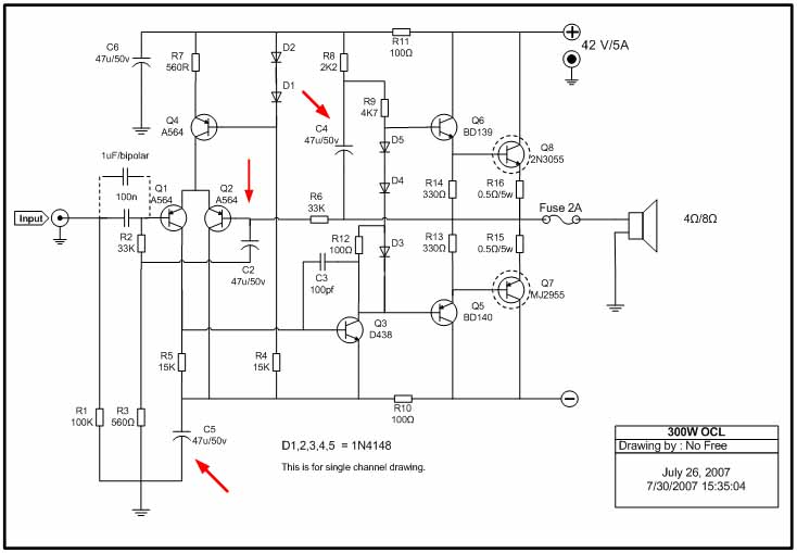

Please I've get burned the Final Transistor ( 2N3055 / MJ2955 ).....had 32V at output ( SPK ) whit input dc +/- 38V.....
It's an old stuff at my junked......i tried to rebuild but keep burn the C2,C4,C5 (47uf/50V) :hot:
I'M CONFUSED................
Please tell me what I've to do ?!
Many thank's

BTW, those outputs transistors are normaly only good for 60 VDC C-E. Therefore a maximum supply of + / - 30 VDC, 25 VDC to have some headroom. There were some that were supposed to be good for 100 VDC. I don't trust them.

Well, 38 VDC X 2 is 76 VDC. If you have an original 2N3055, it will only be guaranteed to withstand 60 VDC, or + / - 30 VDC supplies. Use MJ15003 and MJ15004 for replacements, or if you had 2N5631 and 2N6609 you can use those.
Also, check the driver transistors and also the resistors, especially the low value ones.
The problem is that many people don't understand between the 60 V parts and the 100 V parts. Therefore it's best to simply avoid them all together and use parts that are well known.

It's a Visio schematic. You would have to save it in a jpg format to post it here. I only have the viewer. It's also 193 KB, so too large to post.
C2 requires a resistor in series to set your feedback ratio. You should have zero bias with a three diode string across your driver bases. This design is beyond what a pair 2N3055 compliments will handle. It's pushing MJ15003 and MJ15004. With a 0.5 R emitter resistor you really would be better off with two pairs of outputs.
Is this an existing amplifier, or are you trying to build one from scratch? You should have a look at the SymAsym if you are trying to build one. There are some good clues there as well.

Hi everyone,
Attached the schematic finally.
-Chris
Edit: The 4148 diodes are the wrong type. The voltage drop may be much higher here and they may easily short or go open. Use 1N400X types.

For the Di and D2 I some agree whit u....
Some friend here give me another clue :
Change the driver whit : BD131/B507(original is BD139/BD140) and the protection TR ??? 😕 change from D438 to BD139 ....... the final tr is used MJ15003/MJ15004....?!
Right now your gain is attempting to be infinite, or open loop with only DC feedback in practical terms. In any event, it's not going to be a happy amp without some gain here.
I haven't looked that far into your amp. I just know there are some very basic things you need to get right first. Run at a lower voltage until it's running, then reduce the bias current and raise the voltage. Reset your bias current at this new voltage.
