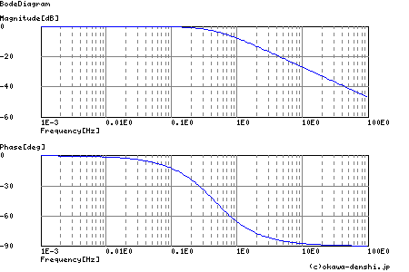

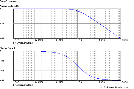

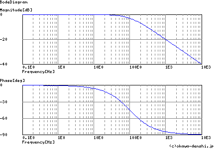

Could I just up the 10uf to 1000uf leave the 0.1uf in and leave that 160ohm in on each output. I'm told that should get the corner frequency down. I just put it through an rc calculator makes sense.
