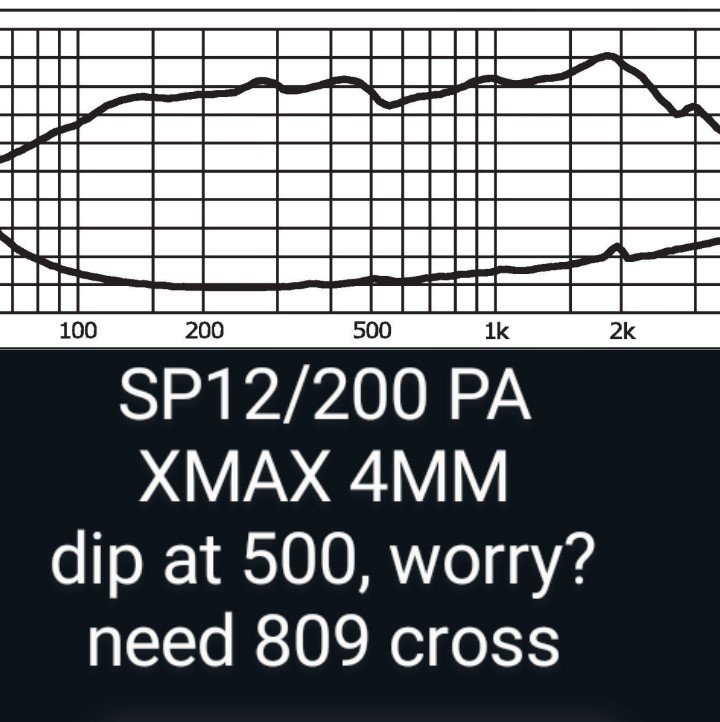

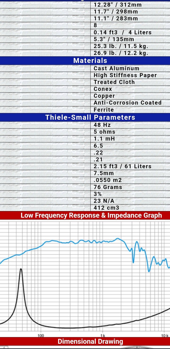

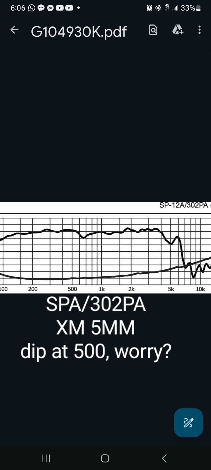

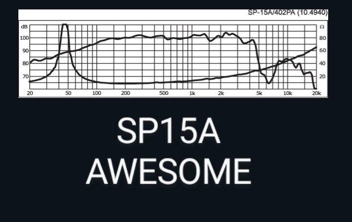

These Monacor woofers below are all good candidates for crossing to a 1.4CD at about 700-800hz. For both 12inchers there's a 500hz dip that worries me because of my intended crossover point. Might they work a little higher in cross? Would hope if the 12 can work...smaller cabinet. The 15 does look like the right deal though. Problem overall is they all have limited x.ax, which bothers a bit because I want to take a sealed/smaller volume and do an LT and eq to achieve lower bass.

If a 12" find a good condition, light used JBL 2206H, consistent and well proven.
Cheaper then a new Monacor.
Easy to use and cross over, smooth and well behaved response. More xmax, enough power handling.
For the money ca 150$ each, used they can hardly be beat for the price.
Beyma 12P80FEV2 is a well proven and high quality option too. takes some EQ well.
Eighteensound 12W750 delivers good performance for the money.
I'd choose either before the Monacors.
That's 94.5 dB. Trying to cross to a 1.4CD
You will never find woofer that meet the sensivity of a CD, so you need to tamper the CD anyway with an L-pad to meet them. Those Monacors you mention won't meet that sensivity neighter. Even that SP15A is only 97dB in reality (Monacors specs are not very accurate). And the limited xmax make it unusable to go sealed and eq the bass you want. You won't get it louder than the xmax limits it.
And if you want to do that, you will need dsp or at least an active analog crossover for that eq, so sensitivy does not matter anymore, You can't boost the bass with a passive one, you can only cut, so you loose that sensivity anyway. You're better of with a lower sensivity and more basss capacity than reverse for this.
Also, those Monacors start to resonate and beam fairly early in the spectrum, i would not use the SP15A above 500Hz for that. The drivers that Arez mentioned are all way better in that, but don't go that low as the Faital. So chooise what you need, they are a good option with a wanted FS arround 50Hz or higher. You can also check the Beyma 12BR70 and the Faital 15BR400 (also higher fs). Both are often used for this kind of setups, even with passive crossovers. The Faital 15BR400 is in the sensivity range of the SP15A, but a lot better in response low and high.

Significant xmax. . Wanna do it in a 1.25cft, sealed and since it's domestic use, I wanna use a LT with some eq from the Crown, and a hp somewhere about 45, and an f3 of 50. Can it be done?can I take it lower in 1.5 sealed?

Yes, that is true, but you try to push it to far. There is a phisical ilmit to how loud and low you can in a small space and that 1.25cu is to small. I can recommend a 10" woofer for it (Faital 10FE330) but it won't have the spl capacities and xmax that you want. But that is the closest i can get to what you want.
A bigger cabinet (double size) would make it a lot easier. then 12" can fit sealed and have space for eq on decent sensivity. But not in 1.25cu. That driver that you posted spec of won't fit certainly, you need a higher q and a lower vas for that.
