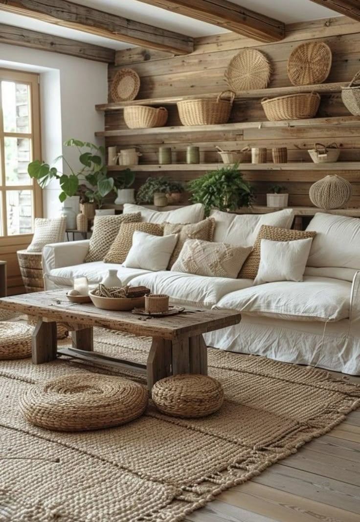

@WhiteDragon Thank you so much.
And for the wall behind the couch (facing the speakers), I'm doing a wooden wall similar to the photo attached, I believe this will also help with the acoustics, what do you think?
So I'm getting a big carpet for sure, I'm also doing a natural wooden floors they should be arriving next week but I don't want to have a very big carpet that'll just hide all the beauty of the wooden floor.The carpet should just extend larger underneath the speakers.

Floor will be wooden, do you think it will help a little? I have no experience with acoustics :/ but my plan is bigger rug, wooden floors and drapes on the glass for now.Seated close to the source not as noticeable.
The main concern is floor reflection = rug
What do you think of my wooden wall idea? would it help?Whatever wall the speakers are pointed at in a large room, is the first to address.
That is the" slap back" late reflection wall hit with most energy, off axis less concern.

Just having the wall made of wood would not help, but shelves on that wall that are randomly filled with a variety of things, books of different sizes & depths, etc will help diffuse the reflections rather than reflect them geometrically, which adds to standings waves & resonances.What do you think of my wooden wall idea? would it help?
