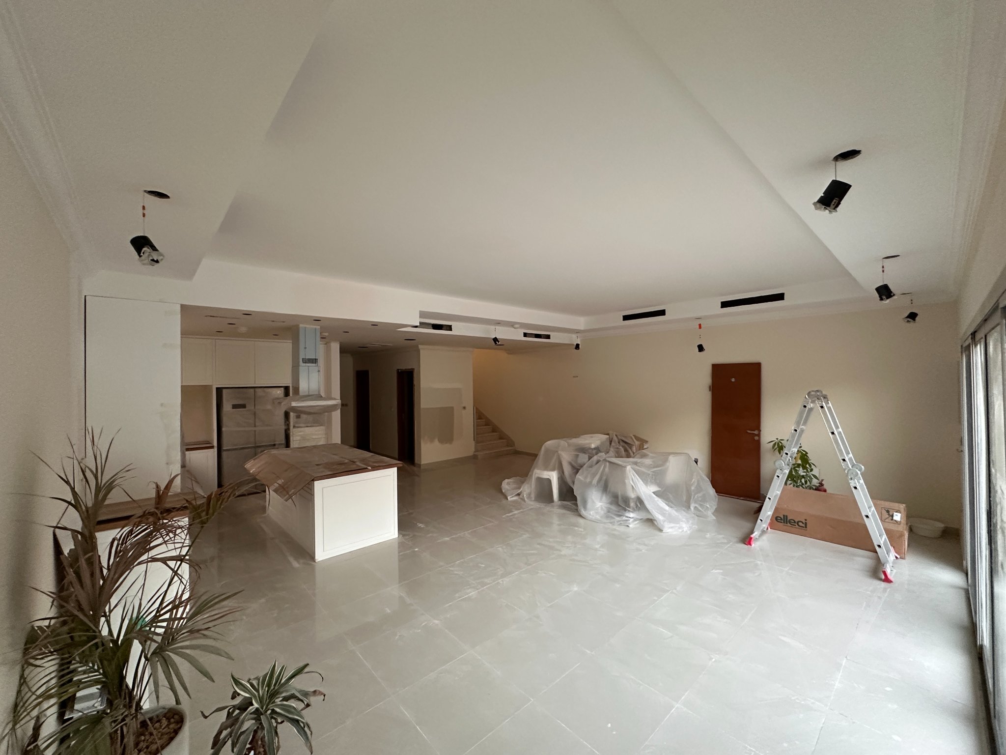

Attaching a photo of my living room, which is currently under renovation. there’s no door on that wall, it's just being repainted but the speakers will be placed in front of that wall basically.
Reactions: Endycia
One: I envy you that large room!
Two: the large windows and the stone floor are both very hard surfaces that needs to be taken care of regarding reflections.
