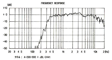

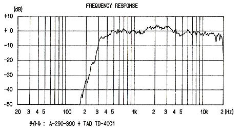

Here are the data sheets for the TAD 4001 and JBL 2441. I also included two pix of those drivers and in real life, the 2441 is dead by 10khz where the TAD is good to 18khz.
I run the 2441 on my system but only up to 5khz then I cross to the big *** Heil. I like the open sound of the Heil as it fires front and back.
