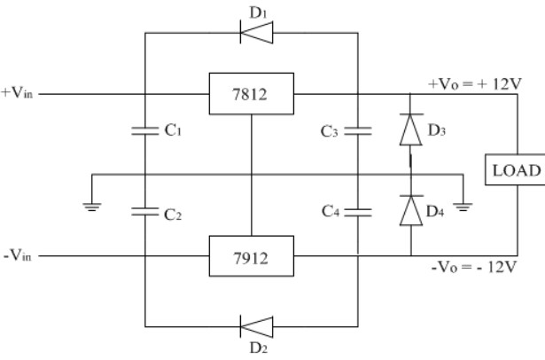

One point to note, the 5532 could (will) have a very significant DC offset when used in the circuit as drawn due to massively unbalanced input resistances.
Also the 78/79 regs can suffer unpredictable latch up under certain conditions which cause the voltage to be incorrect, easily fixed by adding inverse parallel diodes across the regulator and also the stabilised rails.
Edit... And the image from the web is wrong... D2 should be the other way around.

Thanks Mooly.
- Can you talk more about the "massively unbalanced input resistances" and how to correct them?
- Are you saying that in the image you have posted up in the last post, the D2 diode as shown in that image is incorrect? i.e. it should be the reverse of D1?
D2 is wrong in diagram.

Thanks Mooly.
Yes, D2 needs turning 180 degrees. It is drawn the wrong way around.

Yes, since the current flows the other way in the negative regulator.
Good news - it's all working. Did some fault finding, installed protection diodes, earthed the centre point of the 20-0-20 toroid. No hum, music coming out now. Now I can start optimising the setup.
