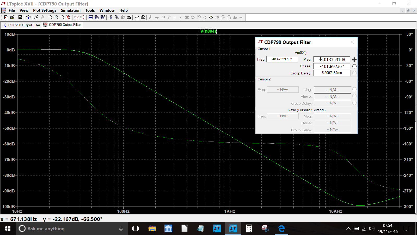

Can you please help me figure out what's the cutoff frequency of this filter? Should resistor R209 be included in the calculation? If yes then how?

So its a low pass filter. The standard design method doesn't seem to have been used here as C207 should be twice the value of C208, and R210 and R211 should be equal.
Normally you need to know the value you want the response to be -3db down and then begin by picking a suitable (ball park figure) for cap C208. Make C207 twice the size and calculate the resistors from the formula:
Calculate R210 and R211:
= 1/(2 * 1.414 *pi *C208*Frequency)
Having just thrown those values into a standard LPF simulation we can see the response is -3db down at around 48Hz.
Putting 48 Hz into the formula gives 23500 ohms for each resistor. That is for the standard LPF version where the resistors are equal.
R209 has no effect because it is always assumed that the filter is fed from a low impedance source (such as another opamp output).

It is a Sallen and Key second order low pass filter. Lots of info on the web. You can independently choose corner frequency and Q.

The HPF has the following response. There is an overall gain of around 3db in the passband.
The additional AC coupled inverting stage on the LPF modifies the response as shown here. You can see the two output voltages marked on the diagram, Vout1 and Vout2. The -3db point as simulated was around 40 Hz.
