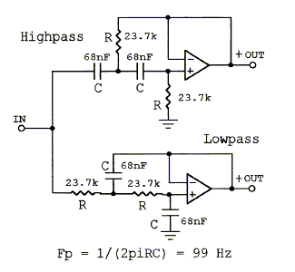

It's difficult to design passive filters with high order slopes. Over 6dB would be best as active.
Active Filters
