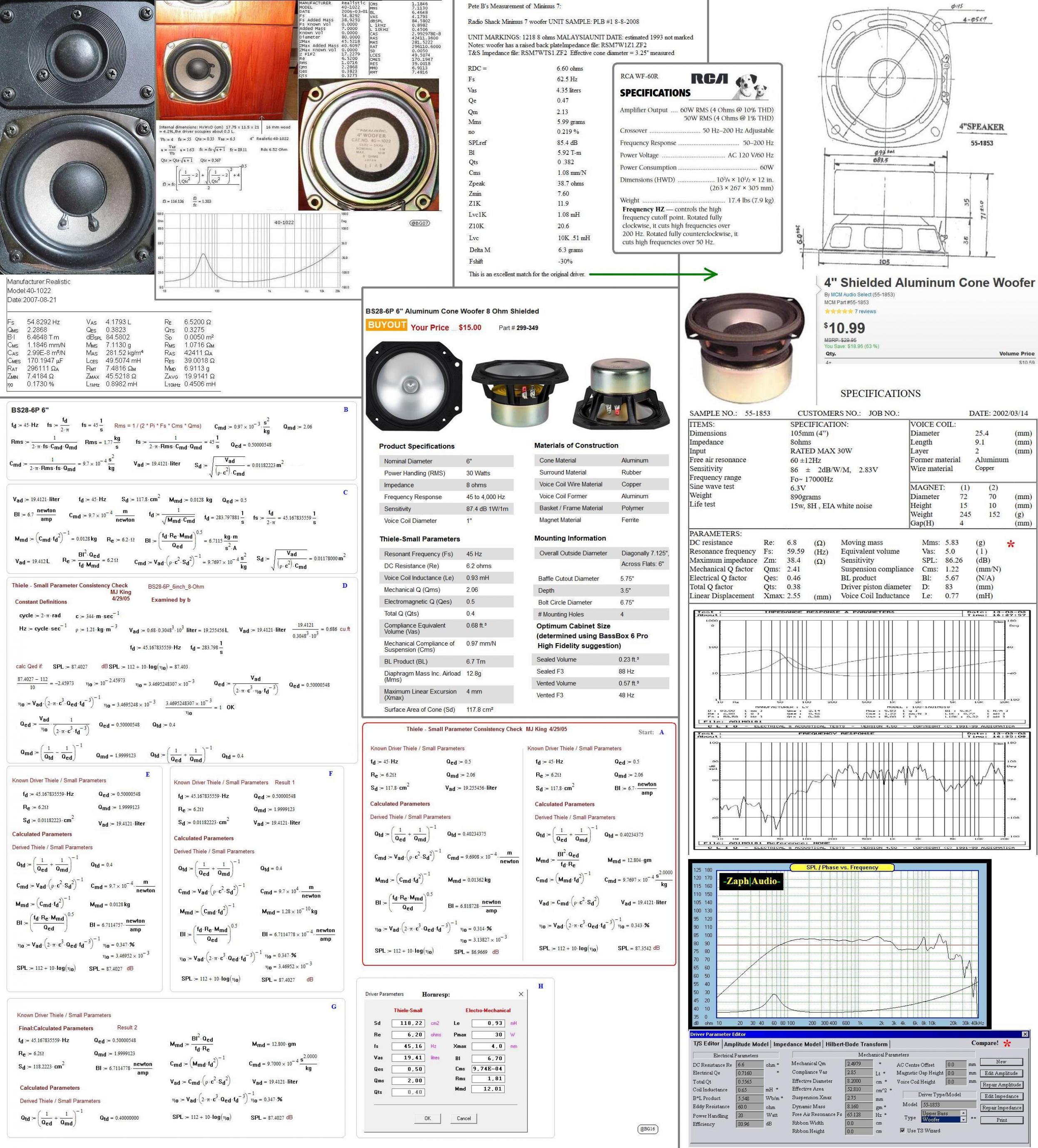

FYI:Checking Rulo's initial pick of a .1 Driver for Sub use = RCA WF60R:
b🙂
Hi All,
b🙂
😱 Correction: All Credit should be directed to sreten who suggested the $15.00 6 inch BS28-6P Aluminum Cone 8 Ohm Woofer-Driver for to be used in a 2.1 System.
The RCA WF-60R Amplifier mentioned by Rulo would (IMO) provide more Dynamic-headroom than necessary, as only 11 W Rms is needed to reach x-max.
As seen in the second of the submitted Pictures: In case of 2 Drivers if using the same Volume as for one Driver tuned to ~40 Hz:
This configuration returns a more sloping FR that is adequate if the Sub is placed near a Corner, i.e. in PI (Sr) where the Room boundary-Gain would improve the lower cut-off Frequency,too.
b🙂
b🙂
True in a sense. But subwoofers don't only reproduce sine waves.
What about 10W low down and 40W higher up at the same time ?
That can be 50W without exceeding the excursion limits.
