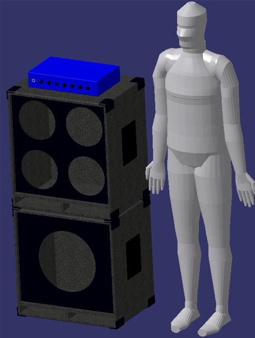

Has anyone had any experience in designing bass guitar cabs. I'm having my first go atm. I currently have a 4x10" Sovtek commercial cab and its not bad but it could be better. I want to get a better amp, atm I have eyed off a SS600 labsystems . Unfortunately my cab wont handle it and i decided after building my own HT suby I'd give the bass cab a go. :)
Atm i have ordered a 15" driver and have plans for that extension cab. I went with an eminence driver (been happy with them in the past for my bass) a Kappa Pro 15. So we'll see how all that goes.... I'm pretty confident that that will sound pretty good. However that's only half the stack i want. :(
I'd like a nice 4x10" cab with a horn to sit on top. Atm I’ve found the eminence gamma 10's to be the best option I can find. If anyone has a better solution or suggestion please help me!!!! Further more I know bugger all about horns so if anyone has a good suggestion again can you help me out.
Eminence also makes a range of crossovers to suit their drivers. They also come neatly packed for mounting in the box and all the appropriate connections as i would like them. However they are rated to 400Wrms. The amp i want is 600Wrms into 4 ohms (each cab will be 8ohm), and can peak at 1050W. From what i understand i'd want a cab to handle around 500Wrms?? Corerct me if i'm worng. The drivers will easily handle the 500Wrms but the crossover at 400Wrms might be a little small, and i reallly don't want to blow the cab up... any opinions????
Attached is my cad models of the boxes i have designed so far.... I did it in CATIA V5 and it looks kinda kewl.... O and if you are wondering..... no I don’t look like the mannequin in the picture :)
any help is appreciated thanks

You might want to look at the Eminence Kappa Pro 10's. They are a cast frame, where the Gammas are stamped. They handel a bit more power also. With the cast frame, you get a tighter low end, better power handling, and a more rugged (read won't break as easily) design. I've had a lot of customers that are very happy with them.

A 2.2 uF film cap rated at 1000 volts will be a nice 6 dB/octave XO for the horn, even at many hundred watts. If you're only playing bass on the rig, not much chance of blowing up the horns because HF content will be very low - just finger noise if at all - unless the amp is oscillating.
Inductors in a Passive XO for bass rated at 1000+ watts is ridiculous. Bass boxes don't need that - actually a terrible idea since bass runs closer to rated RMS ratings than a full music spectrum - a 600 watt RMS amp is some sort of a minimum for gigging, specially with a lot of drums and distorted guitars around... Enough to melt a coil or a dozen of them.
Maybe a steeper slope for the tweeter can be used 12 dB/ 18 dB, but the natural rollof of the driver at the top end should be used if pairing with a tweeter - no series inductor is necessary. If you're really worried about frying a tweeter you can add a fusible R in series, rated to blow at tweeter overload...

I would recomend goind without the horn. The frequency of the bass guitar only goes so high anyway. Also, are you building a full range PA cab, or a bass cab? A lot of the sound of the instrument comes from the cab. If you add the horn, you will hear a lot of string noise, hiss, and electronic garbage. There's a good reason that most bass amplifiers don't have horns. They just sound better without them. BTW, the last time I saw the Flectones, Victor Wooten didn't have a horn in his bass rig.
As for as the Kappa Pro's go, try tuning the enclosure higher. You've already got that big 15" doing the low end. Let the 10's handle the mids and highs. I haven't run the numbers on them yet, but it should work pretty well. In my eminence book, I have a volue recommendation between 5.6 and 8.5 liters. For 4 speakers, that would be between 22.4 and 34 liters. Give it a try with these volumes, and don't worry about making the cab go down to 20 Hz. You should be pretty happy with the results.

To be honest the only reason I suggested that particular value was that that was exactly what I used for building a little home practice rig for my Bassist. I haven't the calc here, but I guess the XO point would be somewhere near 5 or 6 KHZ, which gives the horn some relief from handling very low freqs. I also added a 10 ohm resistor in series to tone down the high end - this is to taste, YMMV.
I find the bass sound to be much better with the horn. There is definitely an added flavour by bringing in some some string noise. The overall impedance of the box does go a little haywire but the Zobel is pretty heavy duty (It's an amp based on TDA 7294 non-inverting config of course) so the dips and nulls in the impedance at higher frequencies are well taken care of - also because it's PA the Zobel (1 R/ 100 nF) can be a little 'stronger' to cure instabilities of long leads, etc.
This also takes care of the rising impedance of the woofer. The advantage we guitarists and bassists have is we can concentrate on 'tone' rather than 'hi-fi' so some speaker non-linearity may not really matter too much - I have unfortunately no way of telling you about the impedance curve - the entire setup was made with parts I had left over except for a transformer - and I have no measurement gear at all.
I know the horn will never get damaged because of the huge attentuation - it barely gets any energy anyway - except when my stupid little pianist plugged his yamaha into the amp one day. The tweeter wasn't damaged, but it was about 110 dB sensitive. The pianist suffered quite a bit of damage.
Again, I think the most sensible suggestion is to build without the horn - save the money, then add it and see if you need it at all, especially for the tone you want. That's more important than theory and guessing. Tone is everything when you're making music, and only you know what tone you want...
