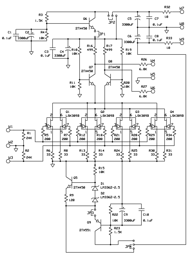

I want to build a phono amp for my system and so far the Pearl seems the best choice for me. The only problem is that it is a single ended circuit. So, I converted the circuit to the balanced one, based on several schematics posted on this forum.
By no means, this is an attempt to improve the amplifier performance. I just wanted a balanced phono amp because all the components in my system are balanced.
The schematic is for one cascade only. I want to make a PCB for the circuit which is shown on the picture. I will use two modules connected in series with RIAA network between them.
I really do appreciate if you guys look at the topology and point out if there are any mistakes there. I don't want to order PCBs and then discover that I made some stupid mistake. I am not worried much about component values at this point, because I will tweak them later.

Today has been a rather trying day, so perhaps I'm missing something...or perhaps several somethings. Can you explain how you see the circuit working?
JP2 turns the circuit off? Allows for regulated/unregulated rail comparisons? Changes the rail voltage?
JP1 probably relates to JP2 I'm guessing, but again it depends on what you intend JP2 to accomplish.
It appears that Q9 (should Q9 be a ZTX550?) is intended to be a regulator for a negative rail...but there's nothing that needs a negative rail. Assuming that Q5 is intended to be a current source, there's a problem in that it dumps directly to ground via the connection beneath R6. For that matter, it wouldn't hurt to have a cap to ground at the emitter of Q9.

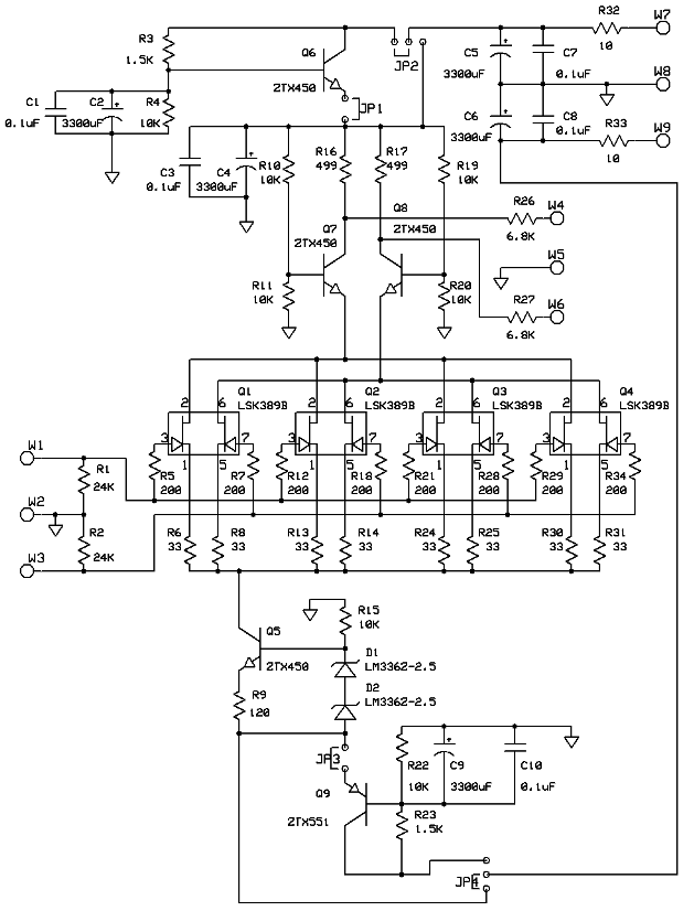

Thanks Grey.
I guess I was tired too when I was drawing the schematics. The ground simbol below R6 should not be there and C9 and R15 should be grounded of course.
Nothing special about jumpers. I just wanted to have an option to disconnect Q6 and/or Q9 capacitance multipliers and use circuit without them.
I'll post corrected picture soon.

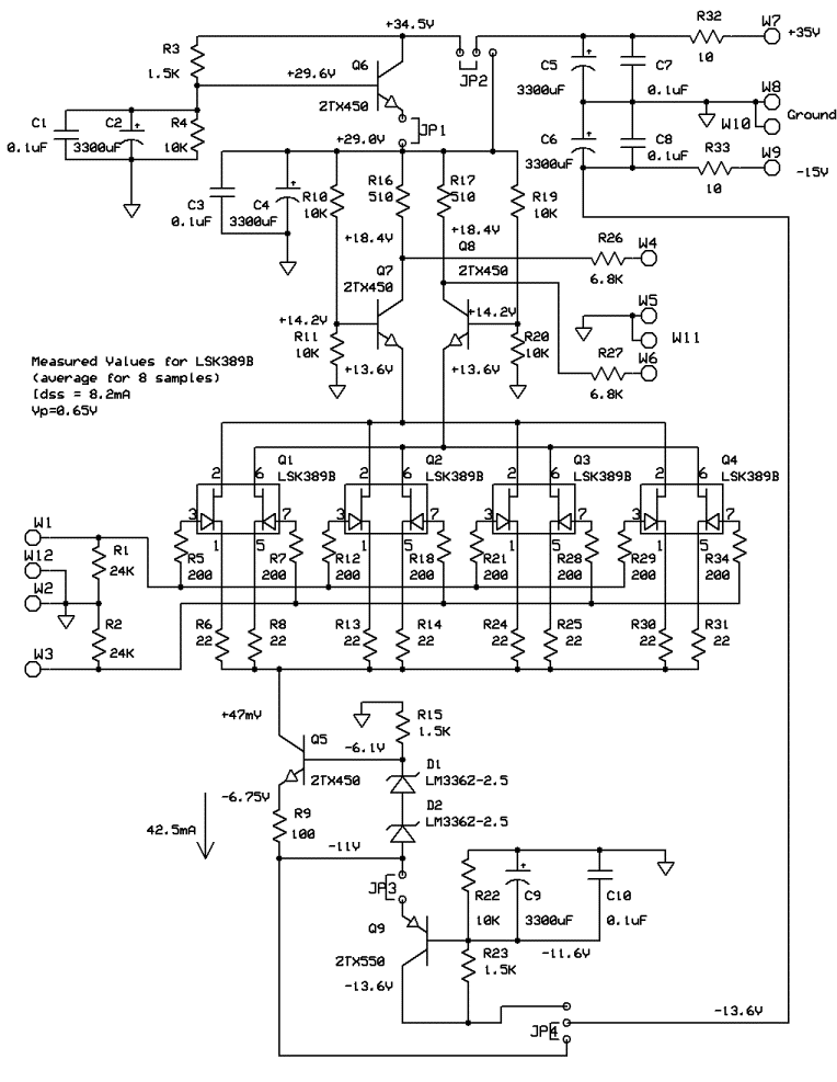

I am listening to the Pearl Amp second day now and I am noticing that it distorts sound little bit. :bawling:
For the lack of the better word, it sounds very “Transistor-like”. I suspect that THD may be high, but I have no means to verify that.
I measured all DC voltages and they seem fine to me. These voltages are shown on attached picture. I am using two cascaded identical sections with RIAA network between them. Measured Gain for each section is 27 and Vout (between hot and cold) is 11V before the clipping. Such a high output voltage looks strange to me because Q7 and Q8 should saturate well before the output reaches 11V. Nevertheless, that’s what I see on the scope.
I really do appreciate if somebody could look at the voltages on the attached schematic and recommend any changes. Will it help if I reduce the current and bring collectors of Q7 and Q8 at +21V?
Thanks a lot

Little experimentation helped. I reduced the total current to 29.9mA, by increasing R9 from 100 to 142 ohms (see picture in a previous post). This way each FET is running at 3.74mA.
Now the amp sounds really nice and I have no complaints whatsoever.
