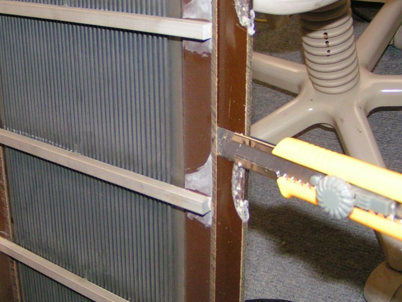

Can somebody guide me to take the electrostatic panel out from the frame?
I have taken the bottom, upper and electronics mdf parts, but I have a problem when I tried to take both side mdf frames apart.
It looks the electrostatic panels glued to the both side frames.
Should I just force it or is there any other way to take the panel out from the side frames?
Thank you in advance for your help.
Peter
Yes you have to apply some force here to break the glue bonds. Try to push (hammer) a long small screwdriver in between the panel and the mdf and use it as a lever. Should be fairly easy to separate them that way. They are glued together with dots of glue every 10 cm or so, but the glue is not very strong.
Same applies for separating the two stators, they are glued together as well using some kind of silicone based glue. Just put a thin but strong knife in between and push it all along the perimeter of the panel.
good luck!
like this
You can also see some of the glue here that held the stator glued to the mdf dframe
Done it.
I have managed to take the panel out and also take the panel apart with a little bit tears and blood. (tears because I managed to create scratch mark on the mdf frame and blood because I also managed to cut my finger.. lucky it wasn't deep 😉 )
next challenge.... to clean the panel.
Do you know what I can use to clean the panel from glue residue? alcohol?

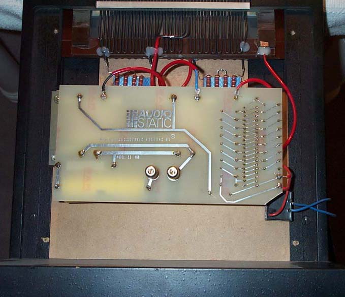

hey Martin, haven´t You seen the 0-Ohm resistance in series? 🙂
How could it be wired different?
The HT-Strip is wired directly, the midlow-strips to the left and right of the HT-strip are wired via resistor. Can´t see anything strange here.
jauu
Calvin
Nice joke about 0 resistance but I think you simply didn't understand my point.
I have seen the audiostatics from the inside myself, there is only one wire per stator (no split-up), so the different sections of a single stator are connected in series, not parallel as in the picture. I have not talked about the HT-strip. Hope you understand my point now.
