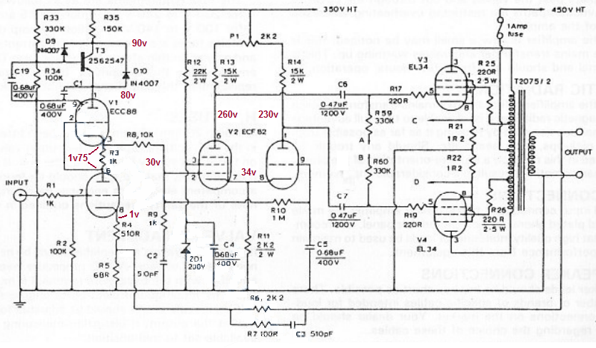

Help and suggestions for my project based on the Radford STA-35 schematic
The triode is acting like a folded cascode with no voltage developed at the grid and cathode, only currents. So it has a high output impedance. the pentode has the grid as input signal and needs the extra pentode grid to increase the output impedance to make it more symmetrical to the triode.
The triode is acting as a grounded-grid stage. The whole thing is a conventional Schmitt long-tailed-pair phase splitter, the difference from convention being that the LHS is a pentode, not a triode: this was done to extend HF response, as stated by Bailey when he described it.
The equations published by Schmitt show that it can never be balanced with such a low value of Rk and equal Rp values without a balancing pot. Leak in the Stereo 20 used Rk=23k, Rp1=91K, Rp2=100K. Mullard in the 5/20 used Rk=82K, Rp1=Rp2=100K which was still out of balance by 3%, which was less than the best resistor tolerance available in 1954: they only got as close as they did because Rk was already so high. The original 'real' Radford circuit as designed by Bailey uses Rk=8k2, Rp1=33K, Rp2=39K, taking into account that the pentode and triode sides may have different values of mu.
The missing pot must definitely be restored (or the original values above used, but this will change the grid voltage which alters the requirements of the previous stage).
With the ECC88 you get a better first stage, -Vg=1V (with ECC81 -Vg=½V). The rest is the same, 30V out and a phase splitter out of balance.
The 2k2 trimpot is to use for AC-balance, is not the same as DC-balance.

Hello everybody,
I managed to do a few things:
  • I unsoldered the coupling capacitors (C4, C4A1, C9 and C9A1).
  • I replaced the 1 ohm resistors with 10 ohm ones (R8 and R10)
I installed the EL34s and turned on the amplifier, as soon as the tubes go up to temperature the fuse blows ...
without the el34 the fuse does not blow, I took the opportunity to measure the voltage in the previous stages that I reported in the diagram.

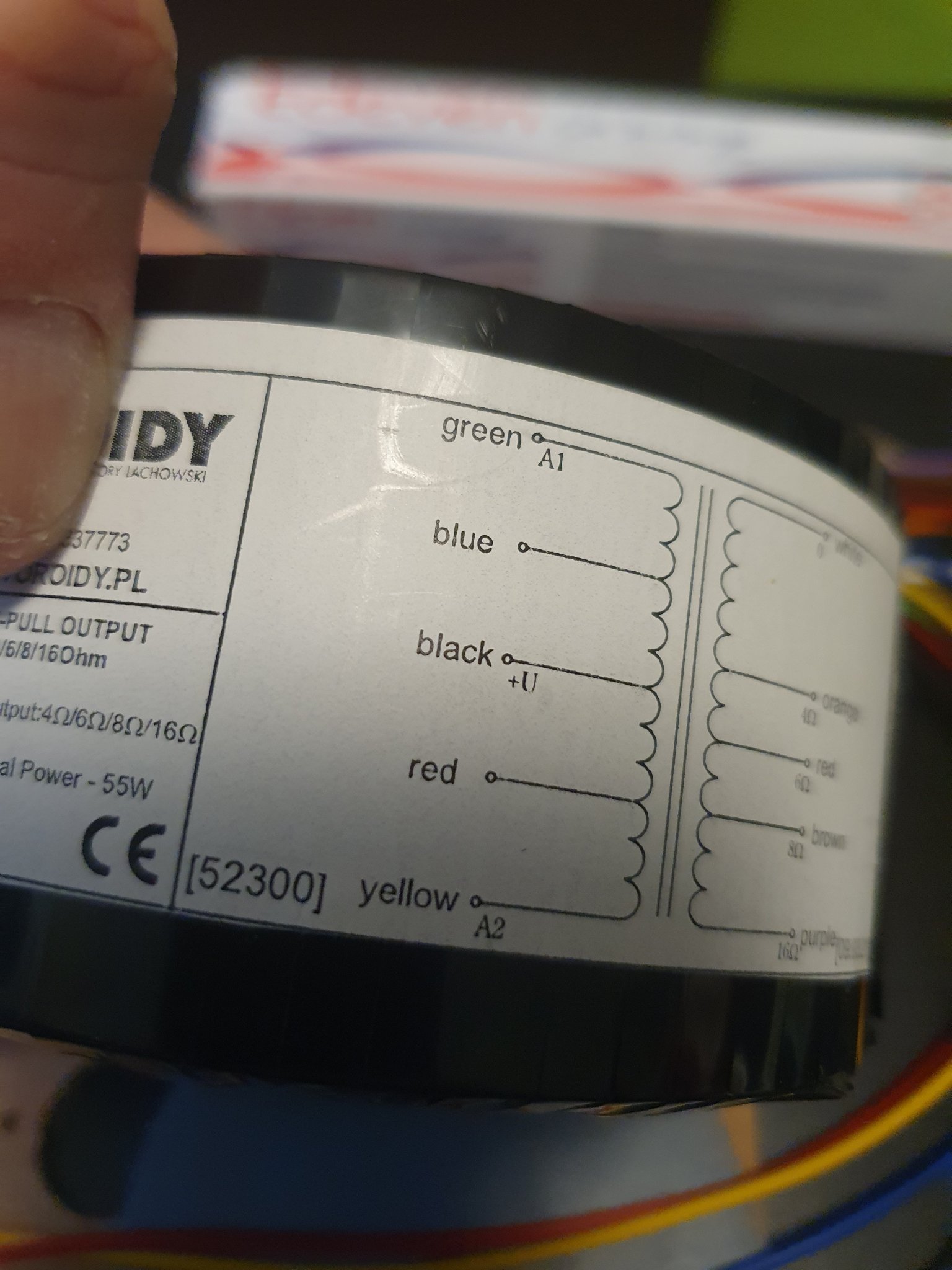

In your schematic the colors of the taps of the secondary of the output transformer don't match the colors of the leads of your output transformer shown in some of the pictures you linked to in post #1. Are you sure you correctly 'translated' the colors of the schematic to the colors of the output transformer?
I agree. There is a problem with the circuit not corresponding to the schematics. The neddlessly
complicated startup obscures the problem.

The Toroidy transformer has different primary colors than those I had indicated on the diagram, following the conversion schematic / O.T. :
  • A1 blue / green
  • green / blue
  • VAA red / black
  • yellow / red
  • A2 brown / yellow

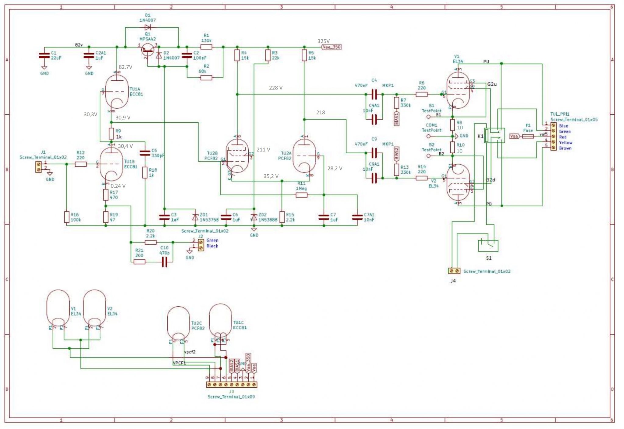

Hello to all, the values published the other day they should not be considered because I found a wrong connection.
I have now repeated the measurement and these are the DC values measured with respect to GND.
V1
Pin1 0.120v cold, warm 0,38v
Pin2 6.3v
Pin3 cold 450v, 405v 350V-hot
Pin4 cold 450v, 350V-405 hot
Pin5 -56v cold, warm -48
Pin6 0v
Pin7 0v
Pin8 0.120v cold, warm 0,38v
What was connected wrong than? Since you are using circuit boards, there can't be that many possible wrong connections.
I tried to do a ignition without the NFB connected and without the ECC81 and PCF82 tubes, so with only the EL34s mounted, in this case the fuse did not blow.
This is puzzling to me since it seems to indicate a problem that is not directly related to the EL34's.
Also puzzling to me is that adjusting the bias trim pots seemed to work in post #46 (adjustable from -57 V to -15 V) but that adjusting them in post #57 didn't cause any voltage drop over the 10 Ohm cathode resistors.
In your post #1 you wrote that you designed the circuit board(s) yourself and had them made by JLCPCB. Could you post the gerber files and/or clear and detailed pictures of the circuit board(s) so that they can be checked by forum members?
It works!!! I was able to adjust the bias.
with hot tubes I set the bias to 0.385 V (B + 408V) and at least by ear it seems to sound very good, what measures do you recommend me to do with the oscilloscope?
if instead I set the triode mode it starts to oscillate voluntarily, suggestions?
What was the problem? the real thing is that I'm an idiot and working on PCB has deceived me;
I made a mistake during the mirror phase to move the component from the bottom to the top side and the pins were numbered backwards compared to those of the el34 so it was all upside down (I started to burn the tubes)
