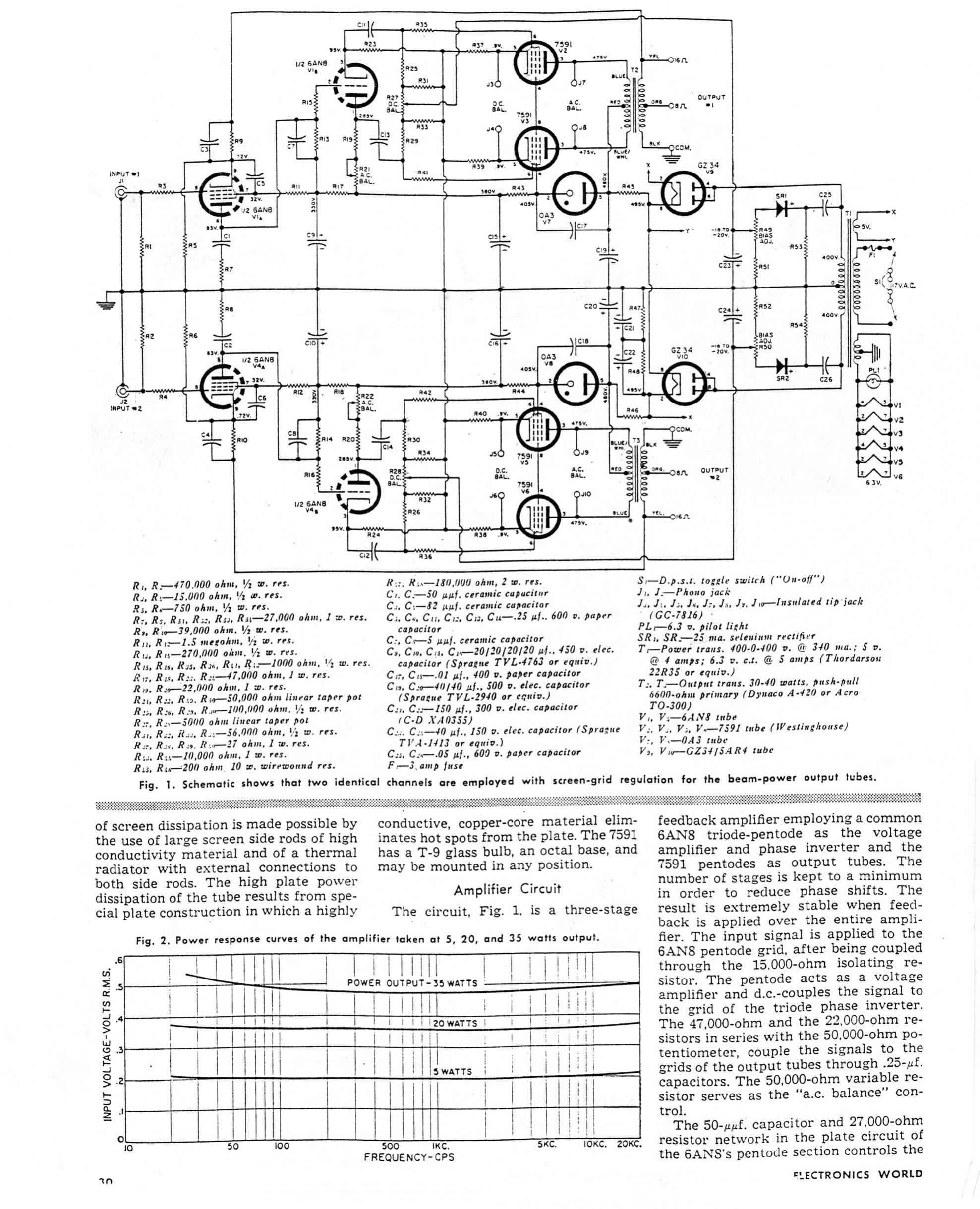

So I am ready to build my first tube amplifier after years of MOSFET's, IGBT's and other silicon new-fangelry.
I always liked building things with CRT's, VFD's and nixies and the like (even a Crookes tube or two..) so now I am ready to build the amplifier linked below.
So my question is this.
If I were to replace the selenium rectifiers with silicon (maybe Cree Schottkys), how can I calculate the new voltage required from the transformer to maintain the correct voltage after the rectifiers?
I'll be getting the transformer custom wound, so I may as well get it wound to suit silicon rectifiers.
Here are the specs of what is specified now:
Transformer: 400 - 0 - 400V @ 340mA (I'll probably spec about 500mA to give some headroom).
Rectifiers: 25mA Selenium
Can someone help me to work this out? 😀

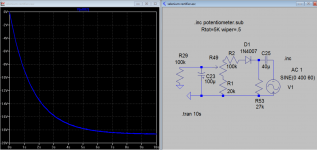

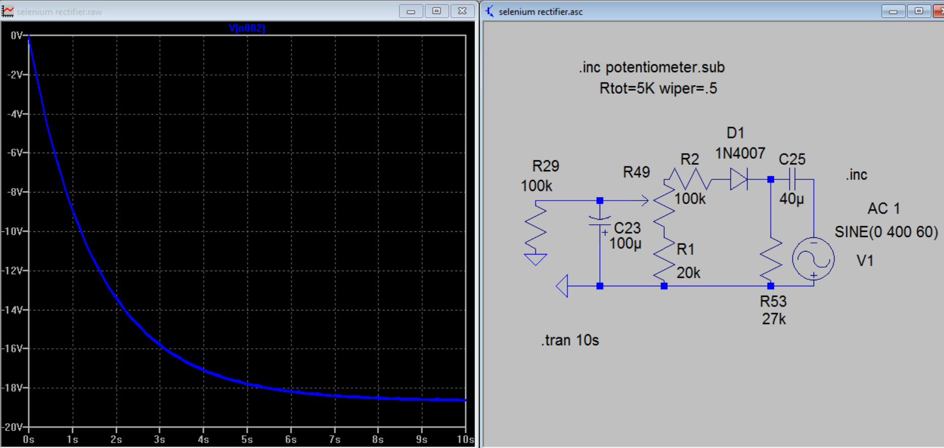

SR1 and SR2 appear to just derive a bias supply. Reducing C25/26 and/or R53/54 would trim that voltage (if needed).
Short answer: You don't have to change the transformer. Change filter components instead. It's my understanding that when guitar amp techs replace dead selenium rectifiers with modern silicon, they just add a series resistor.

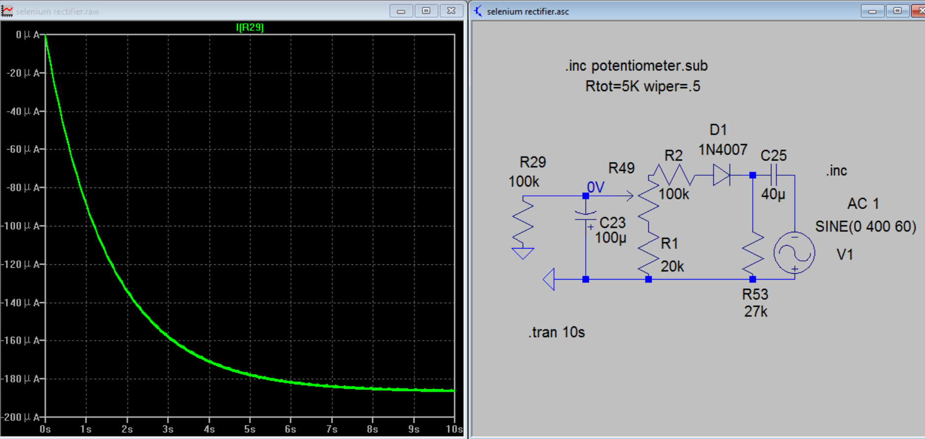

Also, simulate it in PSU Designer 2:
PSUD2
I was hoping to do away with a resistor so things were kept cooler and more energy efficient, seeing as I will have the transformer designed and built to my exact needs anyway.
I had a look at that PSU designer, but it won't allow me to design the PSU section of my schematic, it's really clunky and difficult to use...
To avoid confusion, always mention selenium is used as **bias** rectifiers only; plain "rectifiers" are GZ34 ... and to boot 2 of them !!!!
And for light bias duty, just replace them with silicon, 1N4007 is fine.
No need for extra adjustment since bias is adjustable anyway, each has its own trimmer pot which you'll have to set up.

So directly replacing the selenium bias rectifiers with silicon will work without any other changes needed? Do I need to reduce C25/26 and/or R53/54 as Mooly suggested?

Reducing the cap value slightly (0.05uf to todays 0.047uf) will reduce the bias voltage a little... its a non problem though because you have a pot at the end of it all anyway to set the bias voltage. Its all such high impedance that I doubt the change from selenium to silicon will make much difference anyway.
A cap in parallel. I don't know what the audiophile thinking is on that for this application although given that the rectifier is fed from a cap anyway (which has significant reactance), well I doubt it would make any difference tbh.

Here is an article you can read about replacing selenium rectifier. You need to know how many stacks it has originally, as each stack will drop about 1V DC.

The only specs for the selenium rectifiers is 25mA, and nothing else at all... I'm not sure how to work out how many plates that will have? I that link you provided (I already have it printed out! 😀 ) and also on Wikipedia that most plates will handle 20V reverse voltage on average, I guess this means that for 400V, it will have 20 plates, so it will drop about 20 volts?

Yes, but why connect to such a high voltage? You can do it another way: get -18-20V with a low voltage transformer output 15V AC. If you have to connect to 400V, this is my initial sch. If you label all components I can plug in his value to check.
@Mooly, I do have 0.047uF caps etc, so I guess I'll suck-it-and-see and use that pot to trim it back to where it should be.
I'd be confident that doing that would be fine. In the unlikely event the voltage was that bit to high (and so outside the trim pot range) then you only have to alter either the cap or more easily, one of the resistors.

Oh ya sure certainly it has to do HT of 400V, it's called semi-auto bias, when HT drops, the bias will also drop, imaging if the bias is rigid, the higher bias will reduce the current and power when the output increased. But this type arrangement maybe too rough, the bias bounced up and down very quickly as HT varies with output. Anyway, you can find out how it's later.
