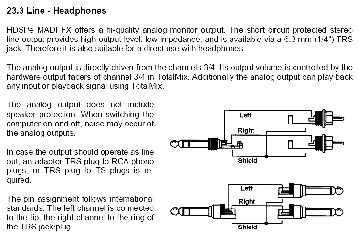

RME state that the output does not provide any speaker protection (ie the PC being turned off/on generates noise/pops etc.) - is this problem easy to solve too?

The only analog output on this card is a hot headphone output. Stereo UN-balanced. While any decent active monitor can be fed un-balanced (and it greatly simplifies the VOLume-knob wish-item), I expect objection.
In the speaker:
Ah you got the image attachment to work!
So it's UNbalanced.
In this case, should I not just connect a very short TRS to TS(L)+TS(R) cable to an Unbalanced to Balanced converter box then just run balanced XLR cables from there to each monitor?
In which case, I'm looking at creating an unbalanced to balanced box with level pot?
