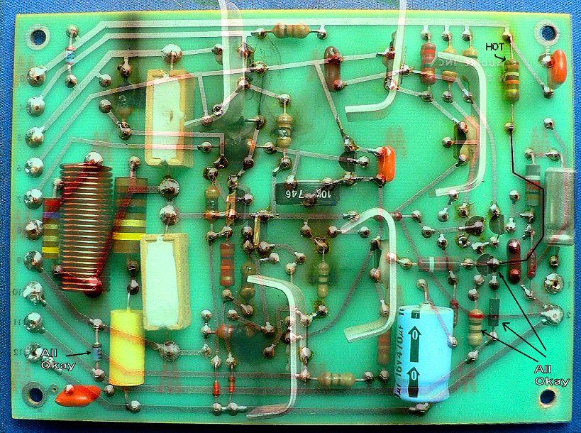

Bulb showed no problems, adjusted bias to 10mV (it's very sensitive to temperature though) and checked again at 1 minute intervals for 5 minutes (OK) then every 5 minutes for 30 minutes - bias still reads 10 to 12mV on both boards.
Connected CD and 'disposable' old 8 Ohm Chinese spkrs, started out volume low and l got undistorted sound from both channels. Let it play for 5 minutes and checked bias - okay. Played a further ten minutes at increased but still low volume level - checked bias - okay. Started to play music at a higher volume level and after about 3 minutes ONE of the right channel OP transistors was HOT - all others were still near stone cold. Bias was still okay. The resistor marked HOT on the pic was too hot to touch (>50C). Nothing else is overheating and nothing shows a bad reading. I've switched the amp off and I'm posting here for help again before I do anything stupid.
Please tell me where I'm going wrong? What is it that I don't understand here?

Here's the pic: sorry for the delay.

Andrew, with no schematic at all, things are not so basic and straightforward so it takes time to identify parts and problems. We can hazard guesses but it's better to take careful steps until the functions are clear.
First, recheck the output offset voltage across the output terminals. Anything under +/-40 mV will be fine and indicates that the output stage is probably OK and the input stage too as this DC level is determined there. Let's consider the overheating transistor according to this result. You've identified one dead driver, usually things work and fail in pairs here even though the low current checks look fine.
I assume the 39k resistor you nicely indicated as hot is not so in the good channel. It appears not to be part of the input, but perhaps the next or voltage amplifier stage (the 2 heatsinked transistors, top & bottom) Given that the traces and parts are conveniently both on this side, perhaps you can sketch a schematic for at least this end of the board. The resistors are colour coded for value and tolerance. so you can just as easily measure many of them and some we can read. Then we can be sure what this resistor limits.
Perhaps you can use a basic amplifier schematic like Destroyer X's DX amplifier as a guide for what to expect, but the voltage amplifier is different, with only one transistor, I think, so don't expect it to be identical, http://www.diyaudio.com/forums/solid-state/96237-destroyer-x-amplifier-dx-amp-my-amplifier.htmlI I would think the input stage will be very close though. Any of his initial posts will do as examples to print or what suits.,
The input stage, BTW, is that cluster of 3 TO92 transistors on the right. They only pass a few mA. bias current, regulated by one of these and shared. equally in the others which also connect to the top (+) rail, I think, via resistors.

I just got up and before even a cup of coffee tested out the voltage on that hot resistor ---- and it's a whopping 103 VDC on BOTH channels ??? Yet it still plays undistorted music? Needless to say I switched off immediately.
That HOT R runs down to the center (centre) leg of a TO92 (2N5961) and through a 948 Ohm R (measures 942 ohms on board 2) to the BASE of an MPSU07 the 'complementary' to that burned and replaced MPSU57 yes? Obviously something is badly wrong here. I'll sketch the circuit area as best I can as soon as I have coffee and meds.

I just can't grasp how the amp played so well last night with all that's (so obviously) wrong with it. Oh for a schematic !!! BTW I overlayed the track side and the compnent side in Photoshop - the rest of the time I have to work with a lamp behind the board to see what's what. Biggest problem is that you can't do anything at all with the boards in situ - and it's a monster PITA to keep taking them out and putting them back in to try them. If I extended the leads from the OP transistors and PSU it'd be easier but I'd probably make it an RF oscillator - and find just another way to fry it 🙂 BTW ... tx to me means transmitter 🙂

Sorry you have that regime with medication, It is utterly debilitating for some but it may buy us some time to enjoy our audio, eh? I have asked Craig for a copy of the schematic he has and we can wait a bit and take this up faster as he probably has better technique. The 103V, I suggest, is near the full potential across the rails, so if that leads to the transistor base, it may be shorted dead. Check that offset voltage at the output too.
