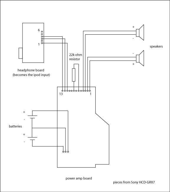

nice! you got something to get started. the first thing is to take apart those SS-J75 speakers to figure out how to mount the woofers and tweeters inside your recycled speaker box. pay attention to how all the wires are connected inside and there are probably a few other parts near the tweeter that works as a crossover. you will want to connect the speakers and crossover parts exactly as they were when they came out of the original box. The nice thing about the sony HCD-GRX7 is that I was able to easily find a service manual for it by searching around the web. I recommend that you look for it because it has alot of nice diagrams of all the parts inside. I browsed through the service manual briefly and found that the power amplifier is built onto a seperate circuit board and easily removed. unfortunately that model is not designed to work from a battery but it might work. maybe you will need 2 batteries because the circuit wants to have both a positive and negative voltage. also it looks like you can take out the headphone jack to use as the input to connect your ipod. I assume that you don't care about the CD player, cassette, and radio tuner so just put those aside. the headphone jack and the power amplifier boards will have wires and connectors attached to them, try to save those as you can re-use them when reconnecting the parts in your box. you will still need batteries but then that's enough parts to get going if you give up the battery meter and use the ipod volume control instead of adding a volume knob. you can also add those later once you have the first part going. here's a very simple diagram: (attached) the connectors and pin numbers correspond to what's shown in the service manual. I added the 22k resistor because the amplifier has an enable input that wants to be turned on by a controller on another board, this resistor takes the place of the controller board.
what does everybody think? the power connector on the amp is really meant to connect to a transformer secondary, and the voltage is supposed to be much higher, about +/- 43 volts. it goes right to a bridge rectifier so connecting DC battery to it shouldn't really be a problem. I'm hoping that the lower voltage wont be a big problem, just not as loud.
good luck!
-Joel
Okay I have already taken the speakers apart, and the stereo unit but I think the reusing of the amp board IS NOT HAPPENING. Hahahah it's way too complicated and I don't know what I'm doing so I will just donate it to the second hand store...
