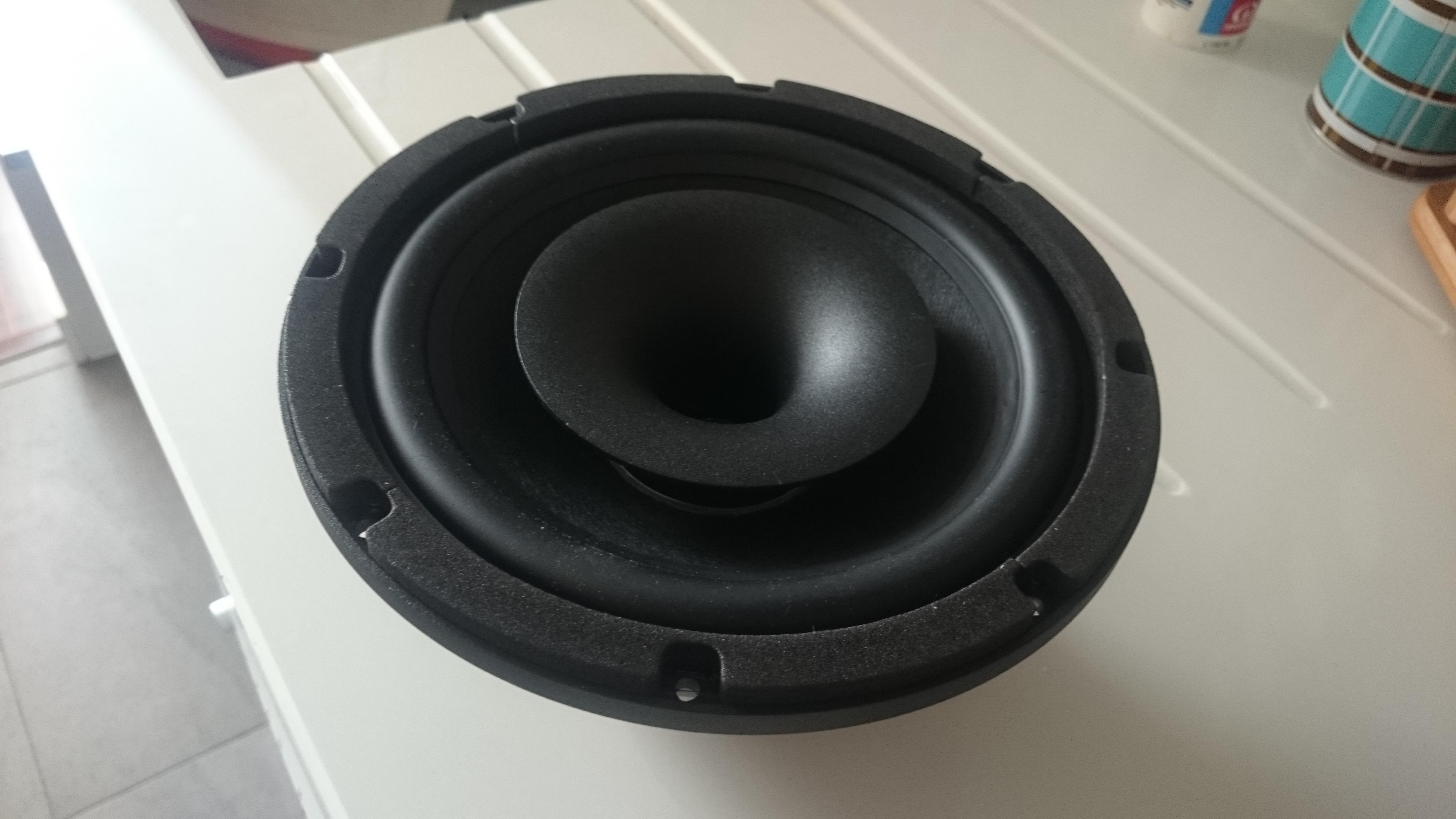

Not sure if this driver will work on a closed box.

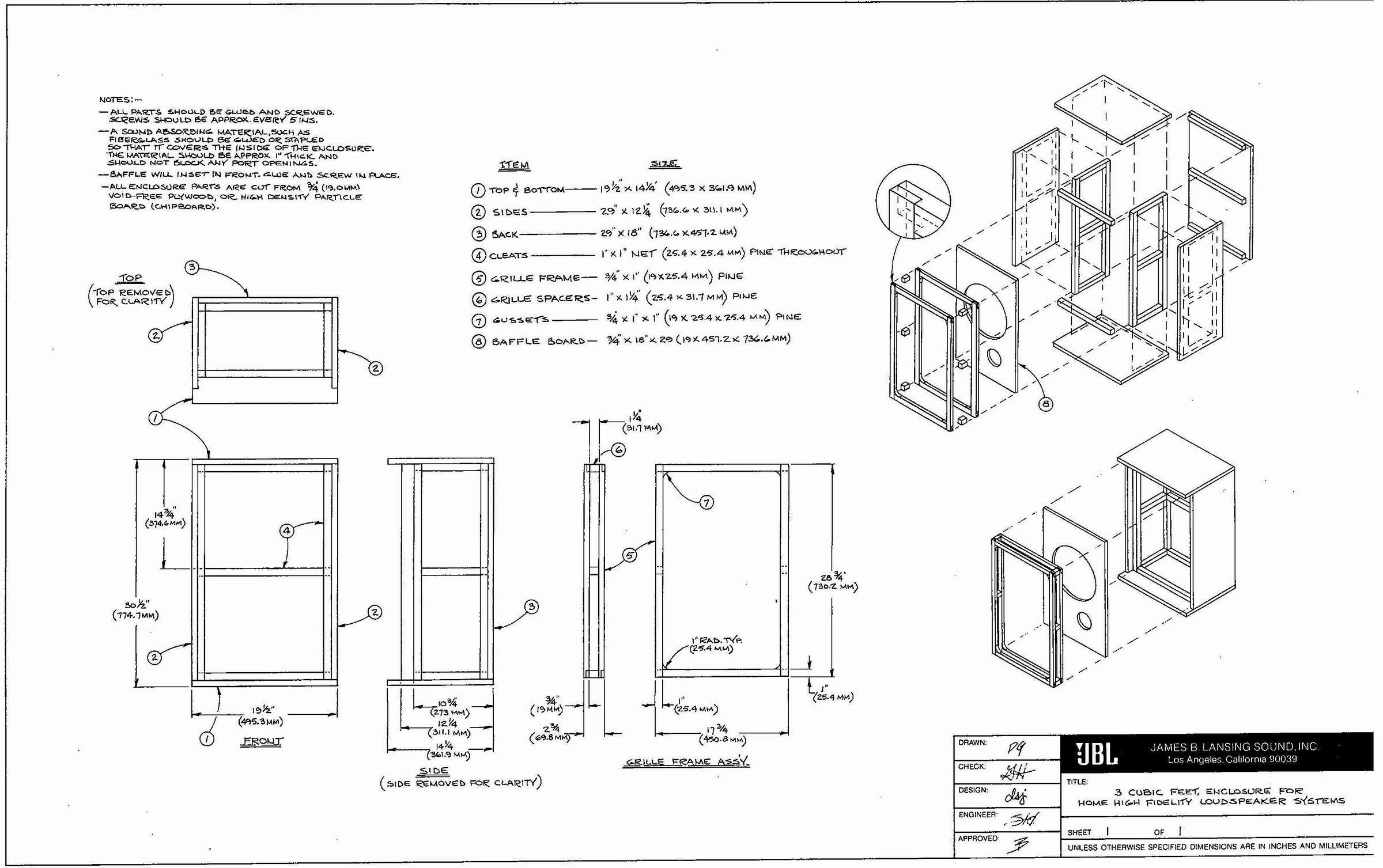

The JBL brochure I enclosed, in effect, says that absorbent material should be placed on all the walls of the box. But then he explains how to assemble the baffle. (Front panel) ie the latter wall is excluded.
So far it all coincides with the general recommendation, and I did so.

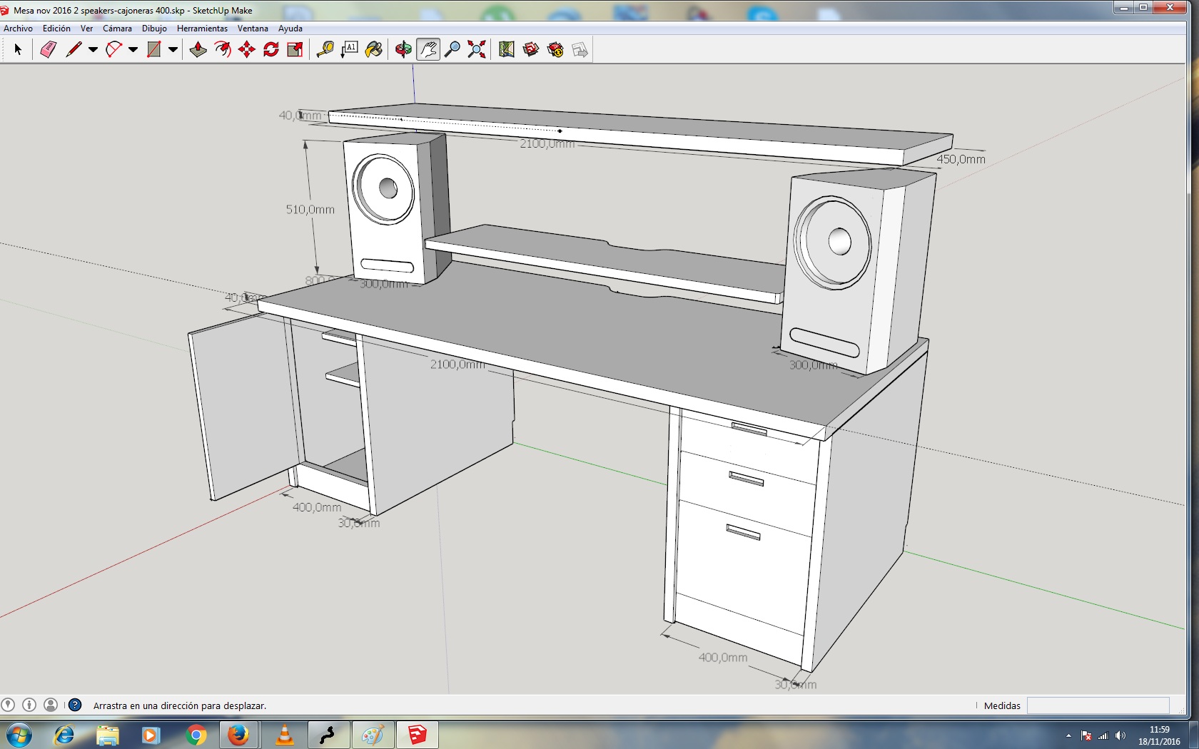

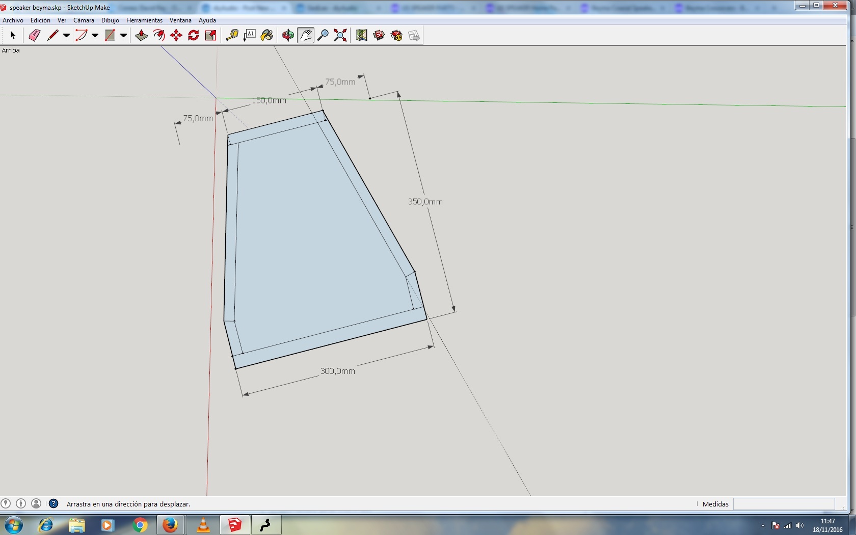

Been working on the cabinet design, and want to show you what I got so far.
As you can see, it´s a kind of "sandwich". An inner mdf cabinet and a front and rear solid wood panels.

The vent will be screwed to the front panel, so I´ll build different sizes (25-30-35mm) so I can try different tunings.
Let me know what you think about or if you would change on that design.

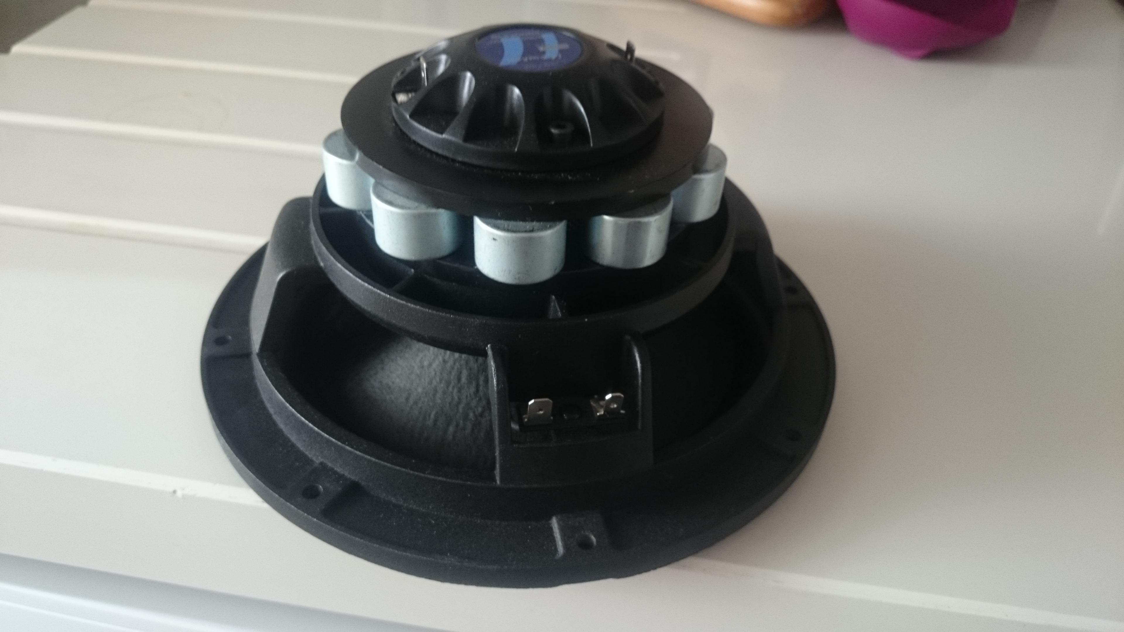

I own the same driver and used it for some active crossover experiments a few years ago. I used them in a small closed box and EQed them for -6 dB @ 40 Hz.
Although intended for very close-field listening that setup ate power for breakfast and max SPL was definitely lacking. But within their limits they sounded very nice with very good Imaging.
I always wanted to put those in a larger box with a 12" woofer but haven't found the time for that so far.
