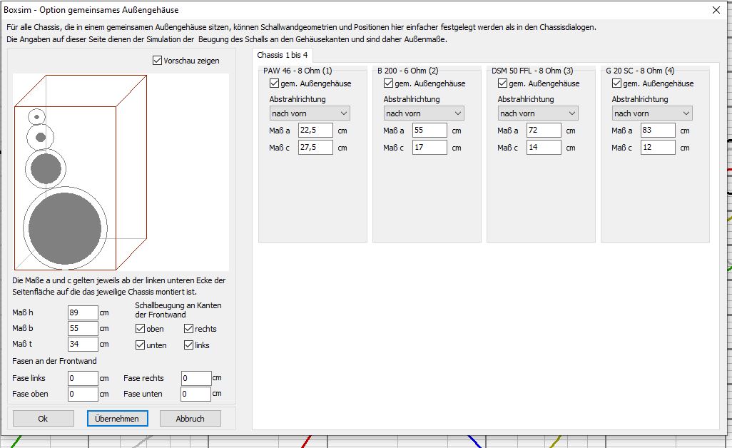

Hi Lehnok!

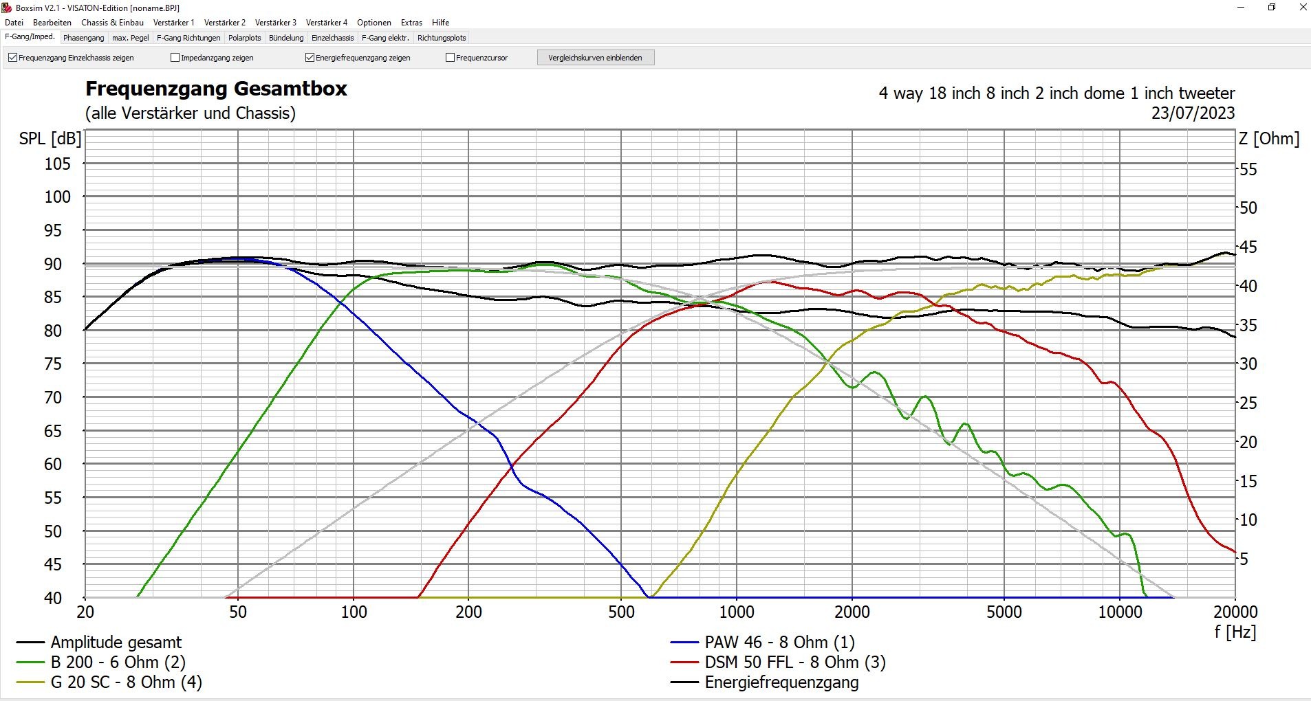

I have tried real quick to be a little bit more concrete. As i mentioned in another thread i am too old for learning curve of VituixCAD and have taken BoxSim 2.1 de-de - it is portable and run on Windows with no install. https://www.visaton.de/en/literature-software/software . Here what i got taking similar drivers, for a first shot for me it says more than thousands of words, here:
I have attached the project file compressed with 7-zip for your convenience if you want to check out some details with the downloaded software
I have spent about half an hour with this first quick shot using Visaton drivers. You can import your own measurements, but this is not a quick shot anymore. My fastest way to develop a first proof of concept is to get as fast as possible as close as possible to a target function for the crossover frequency, here i have chosen Bessel 2nd order with Q=0.58. Sorry for the German version, the latest build is not available in an English version. What you can get out of the simulation is for instance the max SPL simulation that shows that with the high crossover for the dome midrange the limiting factor for max SPL is still the 18 inch driver that i put in a closed cabinet with some substantial PEQ to stay with 200 liter net volume of the bass enclosure. Interesting is also the fact that despite the flat baffle i did not need to put in some delay for the dome midrange and dome tweeter. So most probably this stuff will work with a passive or semi passive (Class D 1 way plate amp for the 18 inch driver and some fine CLASS A MOS - FET Amp from Papa for the rest with a 3 way passive crossover). The nice thing is that you can spend a lot of time playing around with the simulation software without spending a dime, only spending spare time.

SBA_SLOB_GUY
Nice work.But it's a little more difficult in real life, you also need to stitch well phase . That's why I suggested to make 2 enclosures and a Z-axis shift

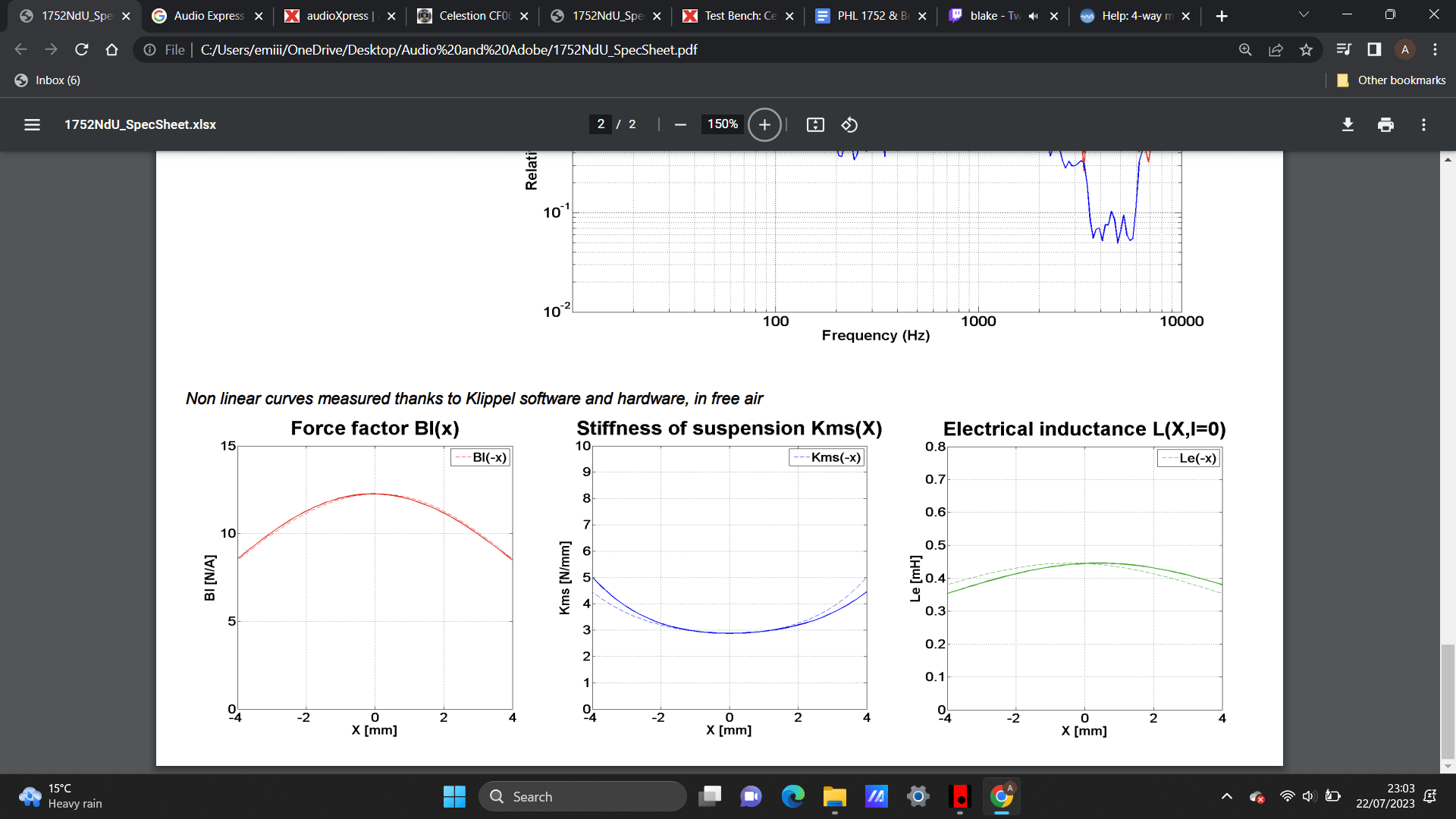

Non linear BL curve... You are funny Tim! But also clearly misinformed... Here is the PHL Bl curve (Klippel data) . For any given SPL, say 96dB to stay below your suggested 100 dB SPL in domestic settings, a 4 inch Accuton midrange has to travel plus / minus 4.5 mm to match the 6.5 inch PHL plus / minus 1 mm...! This brings a raft of distortions, non linearities and time domain issues. Note at plus/minus 1mm the PHL remains 100% perfectly within all linear specification and would do this with just TWO watts of power to hit 96dB and therefore will be 100% free from thermal compression (see attached doc).

Also whatever response you claim is limited "limited" by high Bl or high Qes, please post links to peer reviewed data proving this is the case, and not just your opinion.... And remember, limited bass response in a midrange driver is not a bad thing!!
Thanks a lot!! I will definitely take a look at it!Hi Lehnok!
View attachment 1195653View attachment 1195654

Hello gaga_r, with VituixCAD with your own measurements on and off axis imported you can get a much more reliable simulation, but it will take you more weeks than days of work, i spent for the first quick shot less than an hour.
Trust me, if you have mastered BoxSim, it will take a couple of days to learn VituixCAD. 😊and the simulation is less than an hour.

The bl curve, Le(x) curve, and kms look considerably better on this Seas https://audioxpress.com/article/test-bench-the-seas-l19rnx1-prestige-titan-series-woofer. In fact I've never said a 6 inch pro driver is a replacement for a 4 inch hifi one, I think I've also not understated the advantage of high spl or bigger drivers? I've only said hifi drivers can be considerable more linear if used within normal spl levels. Also very convenient to now make the argument 'oh uh but I was just talking about a midrange and you can see it clearly is linear with 1mm of excursion' yeah I get that too smartass but you made the claim both mids and woofers were better which it clearly isn't as my seas has 2-3x as much xmax as midwoofer which both drivers are, and the seas works way better if it has more than 1mm excursion, every driver is linear if it moves only a milimeter...Non linear BL curve... You are funny Tim! But also clearly misinformed... Here is the PHL Bl curve (Klippel data) . For any given SPL, say 96dB to stay below your suggested 100 dB SPL in domestic settings, a 4 inch Accuton midrange has to travel plus / minus 4.5 mm to match the 6.5 inch PHL plus / minus 1 mm...! This brings a raft of distortions, non linearities and time domain issues. Note at plus/minus 1mm the PHL remains 100% perfectly within all linear specification and would do this with just TWO watts of power to hit 96dB and therefore will be 100% free from thermal compression (see attached doc).
Also I don't know if you can see it but at 4mm the kms has almost doubled and the BL halfed that was kinda the point I was making about the non linear bl and kms...

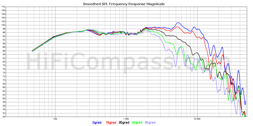

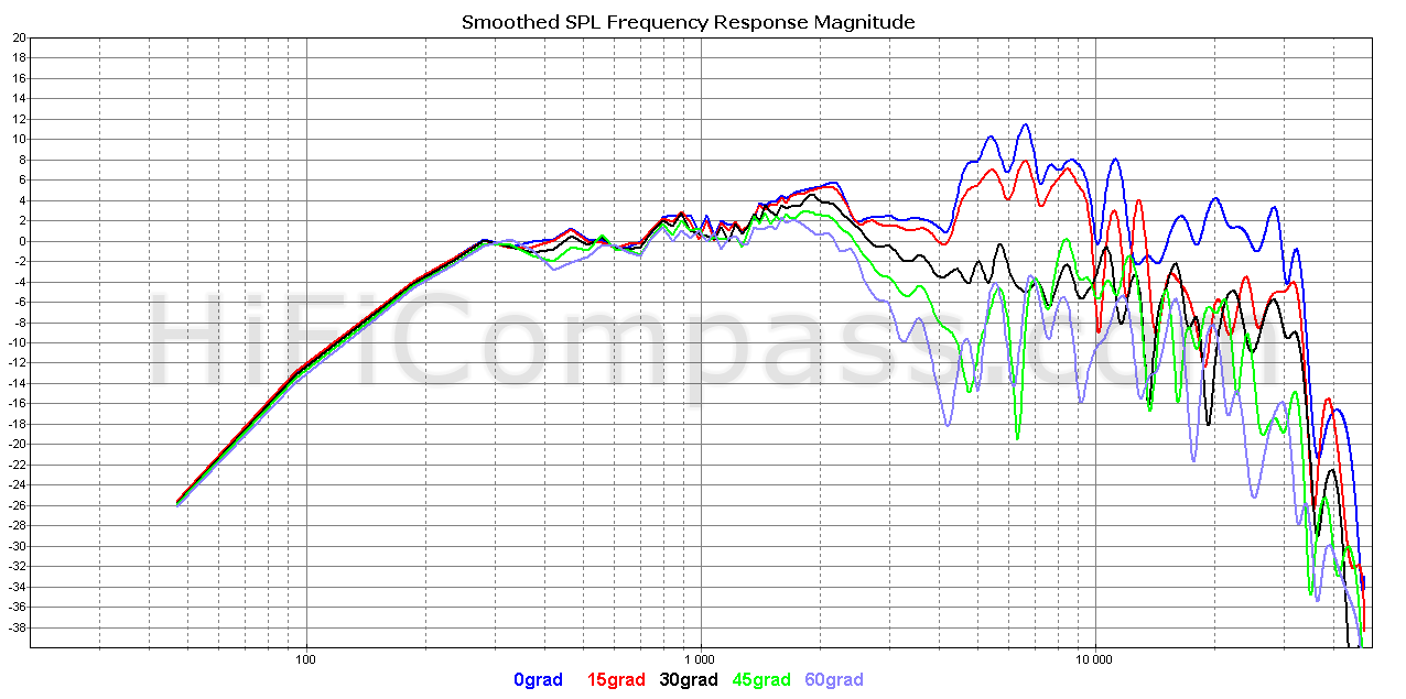

Frequency obviously and in turn obv step&impulse. Here an example between a Seas W15LY001 and 2 pa midwoofers from hificompass:"Limited response" ....? What response, step response? impulse response? Dynamics? Frequency, bass/mid/top end...? Be specific please.
And a Beyma 5G40Nd;

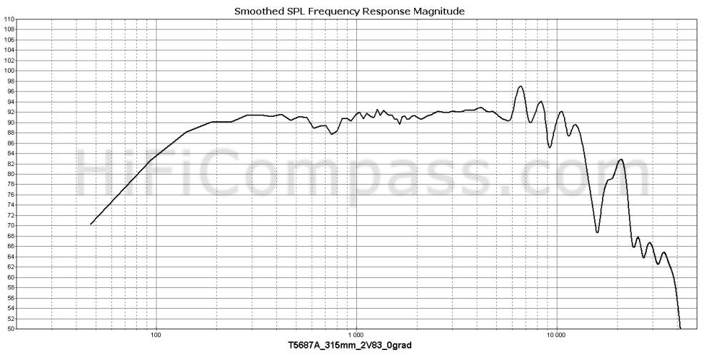

And a Celestion T5687A with only on-axis as HifiCompass doesn't have off axis sadly.
You clearly see much more smooth high frequency and breakup as I claimed and rolloff also looks relaxter and less steep on the Seas.

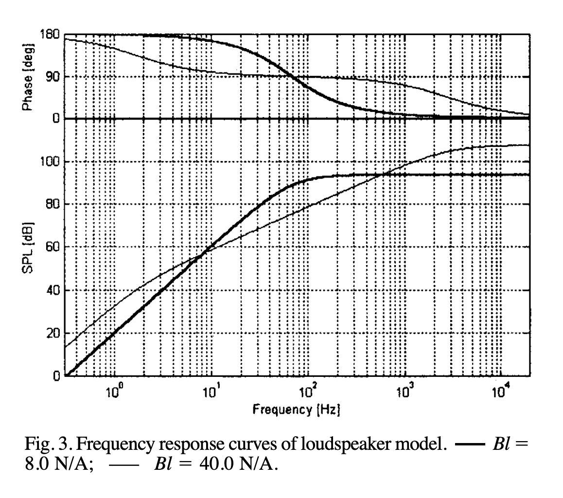

Low qes*, here you go: https://www.researchgate.net/publication/254844155_Direct-radiator_loudspeaker_systems_with_high_BI from John Vanderkooy in the JAES, fig 3;Also whatever response you claim is limited "limited" by high Bl or high Qes, please post links to peer reviewed data proving this is the case, and not just your opinion.... And remember, limited bass response in a midrange driver is not a bad thing!!
And in this paper which also mentions high bl drivers you can even find the decreased Qes as a result of high bl under section 3.2.1. Mechanical Parameters; https://www.xlrtechs.com/dbkeele.com/PDF/Keele (2003-10 AES Preprint) - Nom vs True Eff High BL.pdf
