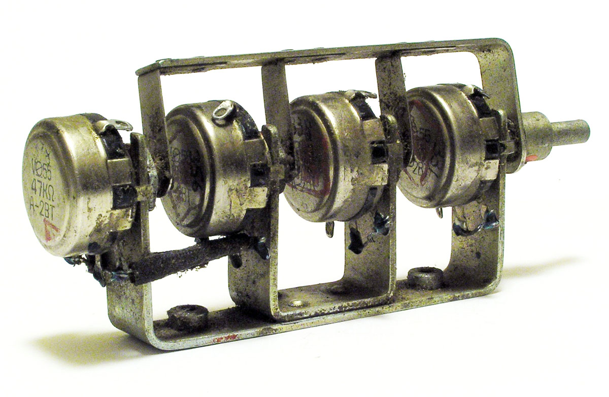

My current solutions for controlling volume on the 4 channel simultaneously are:
1. a quad-potentiometer
Problem(s): I can't get one locally and don't have a bank account to buy online.

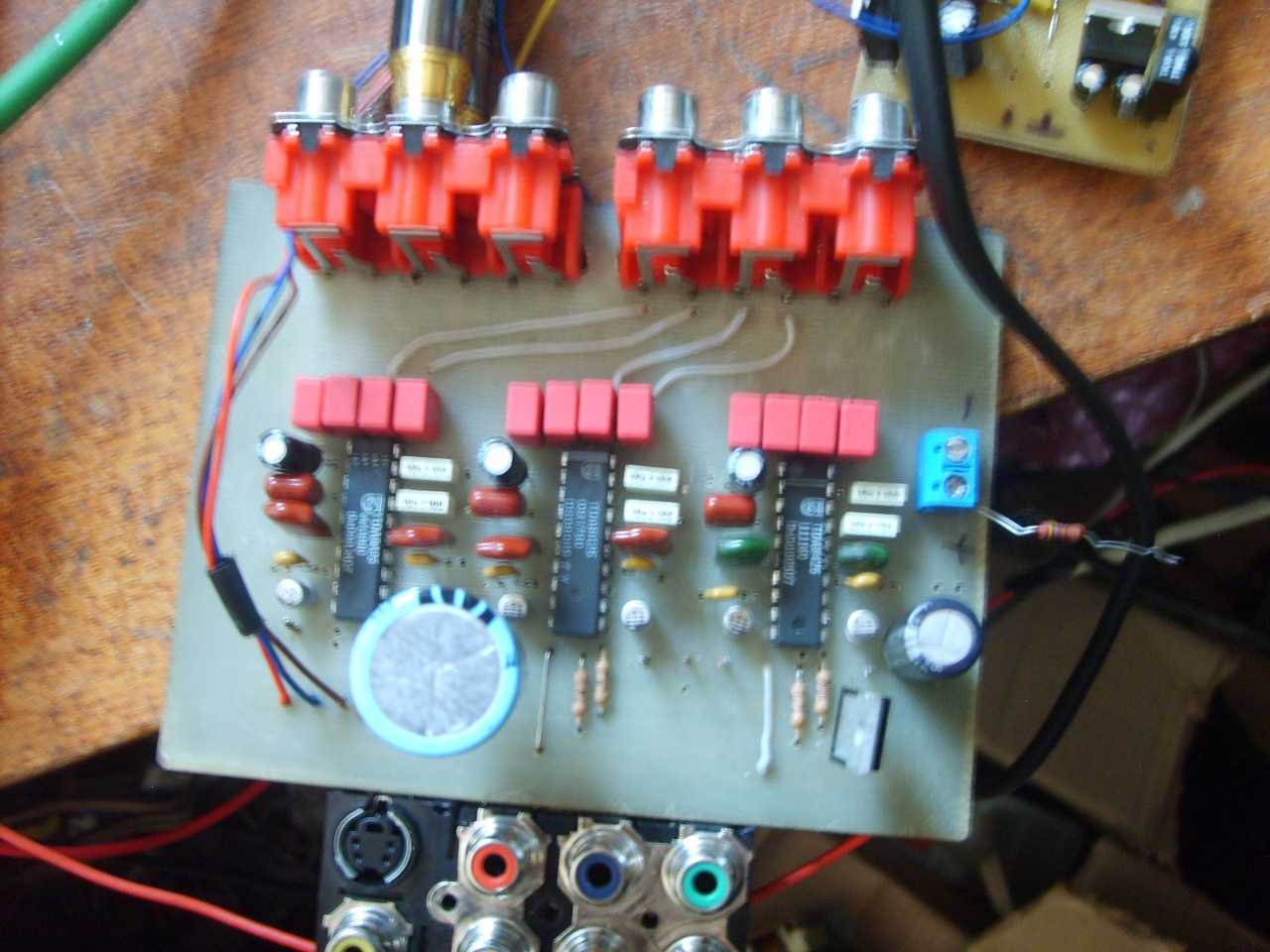

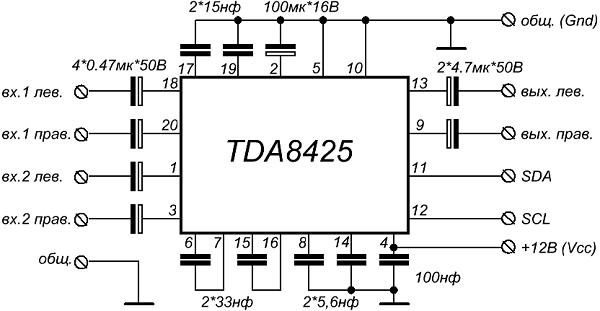

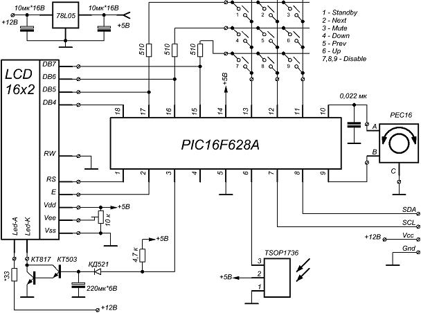

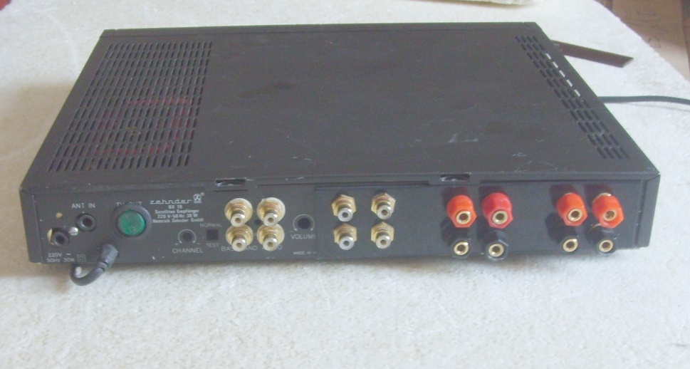

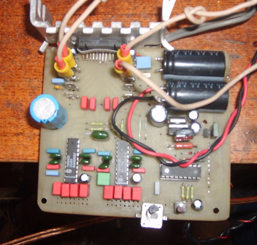

I will try to gather all in one post.
Adjusts the tone, volume,
Remote control of RC 5
two inputs
memory installed in the OFF position
two inputs
