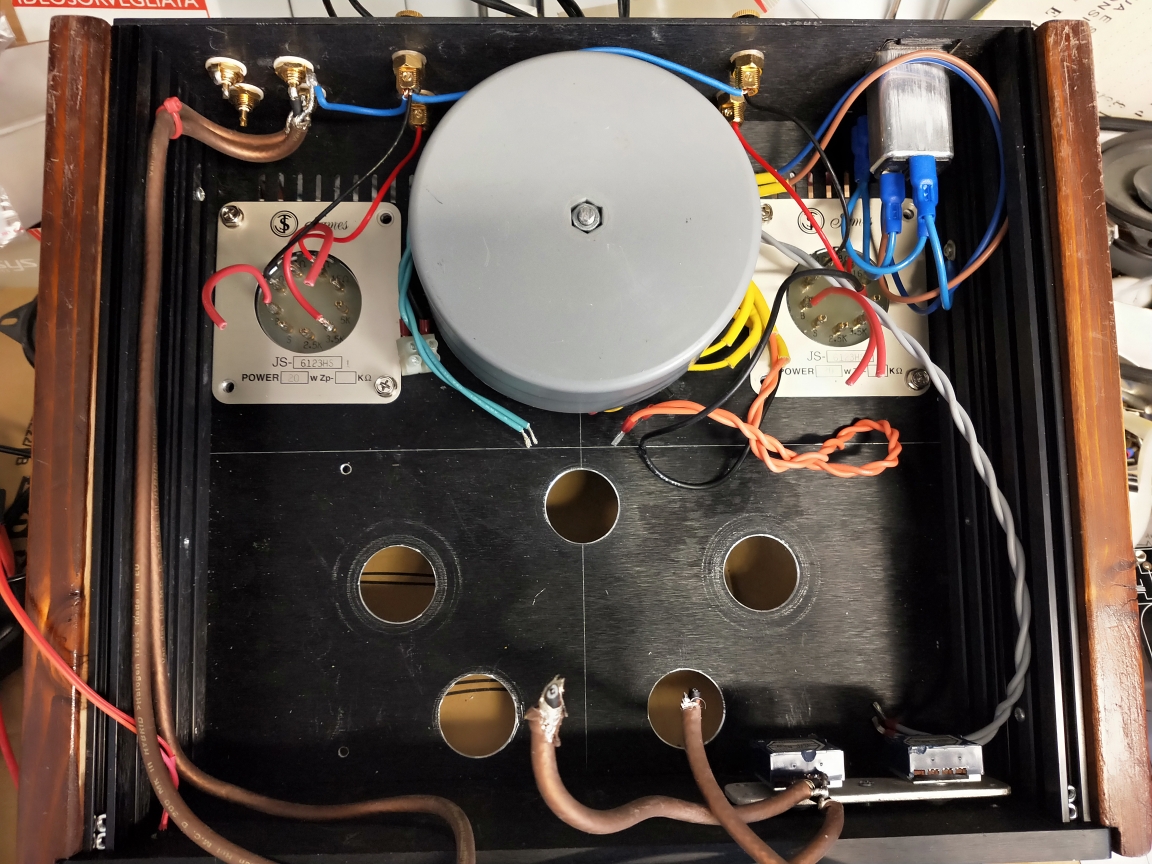

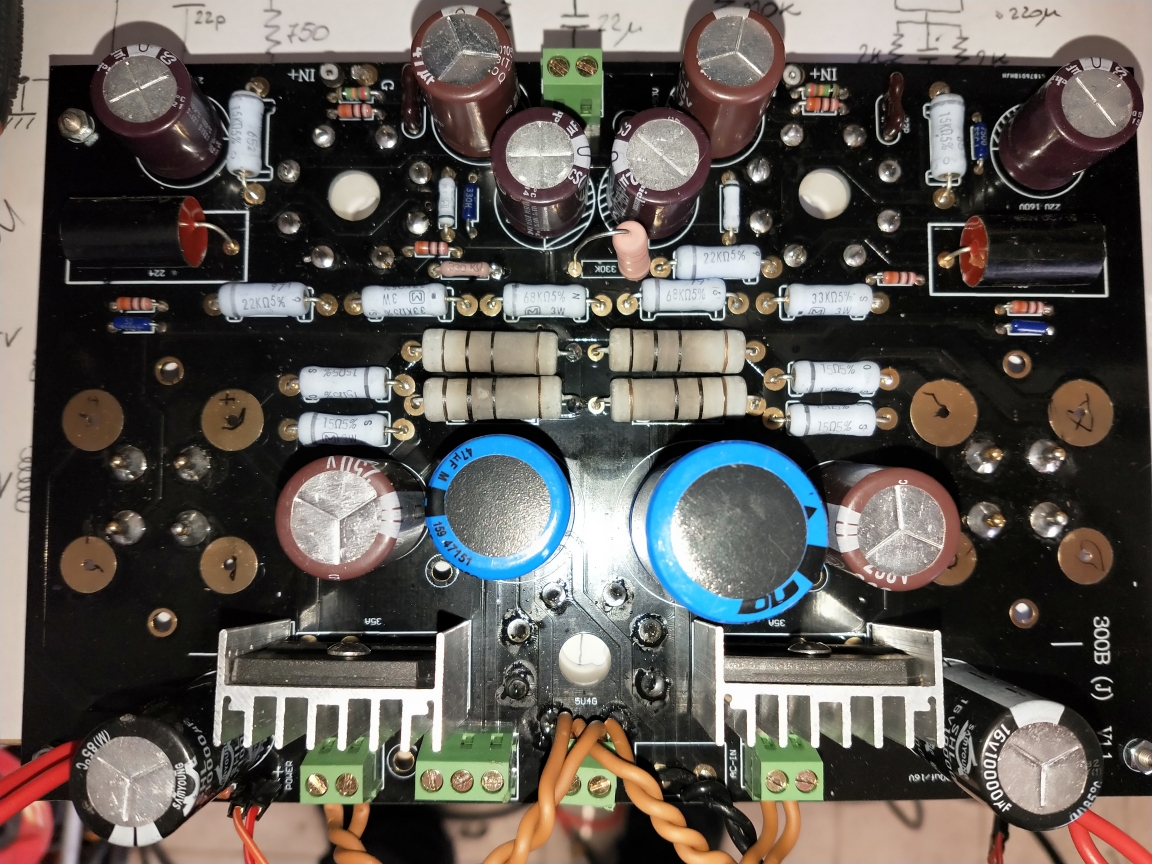

Not on this transformer.
I have another one with separate windings for filamants, but the hv is 380v-0-380v
It is quite higher than required. Should I change anything in the circuit?
380-0-380VAC, wow!
So, completely remove the 47uF cap that is connected from one end of the rectifier filament, and the other end of that cap is connected to ground.
Replace it with a 1uF to 4uF cap. If it is a non electrolytic, it needs to have a 440VAC or higher rating. If it is an electrolytic, it needs a 600VDC or 630VDC rating.
If you do not have a cap that has that high of a voltage rating, then stack 2 caps in series, from the rectifier filament to ground. Use 2uF to 8uF in series (but always use two with the same uF value), with a 300k across each cap to equalize any cap leakage current. An electrolytic that is 400V rated or higher, with 2 caps in series will work.
two 2uF caps in series = 1uF, two 4uF caps in series = 2uF, two 6uF in series = 3uF, etc.
After you get the amp up and running, check the B+ voltage again.
I am guessing about 2uF of capacitance (or two 4uF caps in series) will give about the right B+ voltage.

Will do for sure! Thank you so much for your help!!
I'm now looking for the caps to replace, does not seem so easy to find here in Italy..
It does need to be electrolitic, right?
I may have to come up with a series 😀
It works!!!!!
Thank you!
No hum at all, just a bit of difference between lh and rh channel sound.
I finally used 3x 10uf in series.
Voltages make sense now.
Thanks again!
