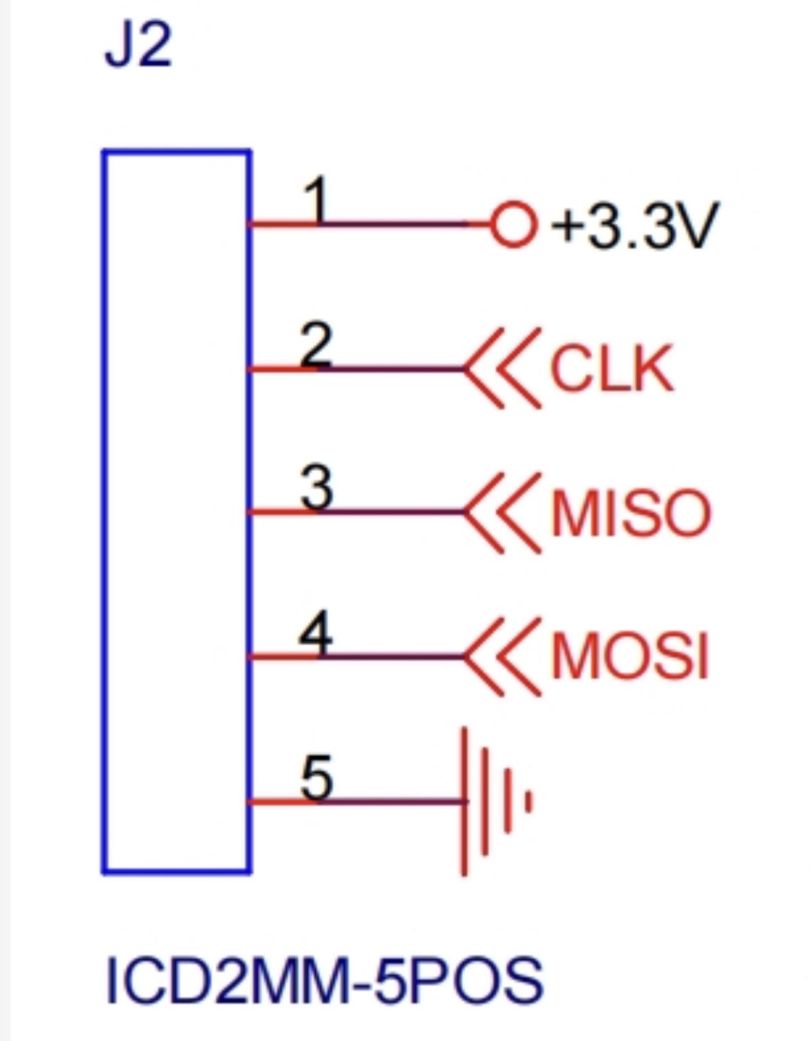

I just got an email back from Sure Electronics. See attached image for the pinout on the JAB3+. The chip is the QCC3034. Note: I have not been able to get this connection to work with a USB-SPI converter on any of the Qualcomm tools. It’s my understanding that this connection is for the Qualcomm DK-TRBI200 debugger (350 USD). If anyone else has any ideas, I’d love to hear them.
