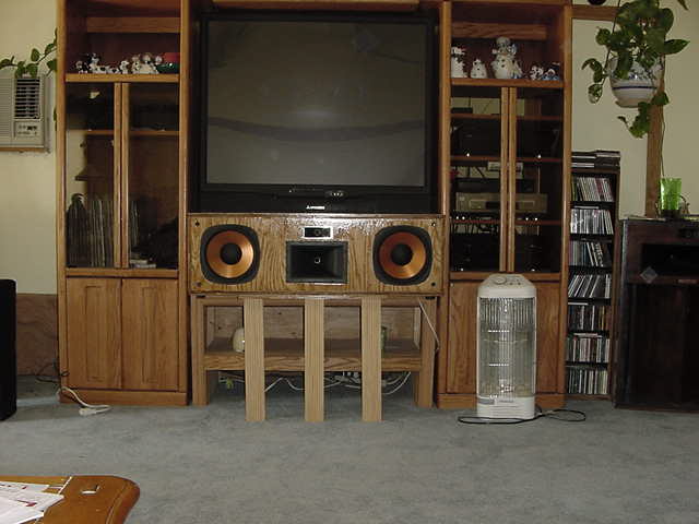

Nice central loudspeaker, what type of wood did you use to make it ?

I used 3/4" oak plywood with full internal bracing. The drivers for the unit are 2-10" KV1089 copper woofers, EV T35 Horn Tweeter w'alnico magnet, and a K52 Midrange 90x60 Tritix horn. Crosoover is 700/5600. Sound very nice. Can't wait tell she gets some hours on her to really start shining.
