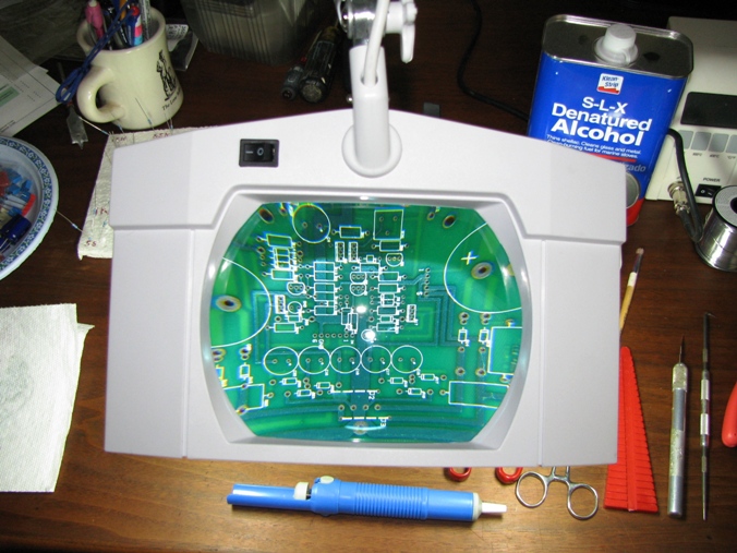

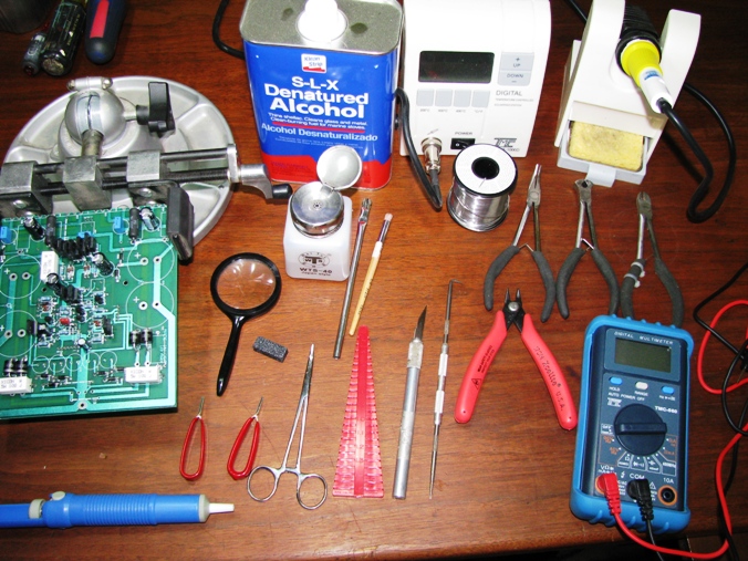

Here is my first challenge. I feel totally overwhelmed and scared of the fact that I might buy some stuff to create my own DIY stuff and completely burn a board. I totally suck at soldering. If I could get over that I'm sure things will get much easier.
1st things 1st - what do you have for soldering gear?
See the photo's below for a pretty good soldering work area and tools.
Here is a bit of a primer and there are a lot of video's on Utube about soldering and also available at NASA.

^^^ where are you sourcing that mag viewer ..?
Grabbed it off of flea-bay about 3 years ago - I forget the store but I'll try and look it up if I can....😀😀😀
The outfit I got that lamp from doesn't have any of that type right now - but here is someone that does - and for pretty much the same price I paid + fee shipping. I haven't used them before so I can't vouch for them but their seller rating looks pretty decent.

Don't boards require a certain level of heat as opposed to say for example soldering an XLR Cable or a TRS Cable?
That all depends - It doesn't really matter if it is a PWB or a terminal lug - what you need to be able to judge is the amount of thermal mass that needs to be heated up to a sufficient temperature for a proper solder joint. This determination will help you to make a decision as to the amount of heat you will require as well as the proper size of your soldering tip. Experience will play a role in your selection as you progress.
Here is a place to start by one of the best solder station manufacturers.
HAKKO | Select Tip Shape | HAKKO Recommendations for Selection of Tip Size
I could go on - but it is a very long discussion to put into a little box.
Believe me - the proper selection of the proper wattage iron to use - at the proper temperature - with the proper tip - and the proper tools and workbench will make your soldering much easier. That being said - good soldering takes practice - and quite a bit of it. See if you can find some old scrap PC or TV or Audio PWB that you can use for practice - there should be something laying around in someone's scrap bin.
