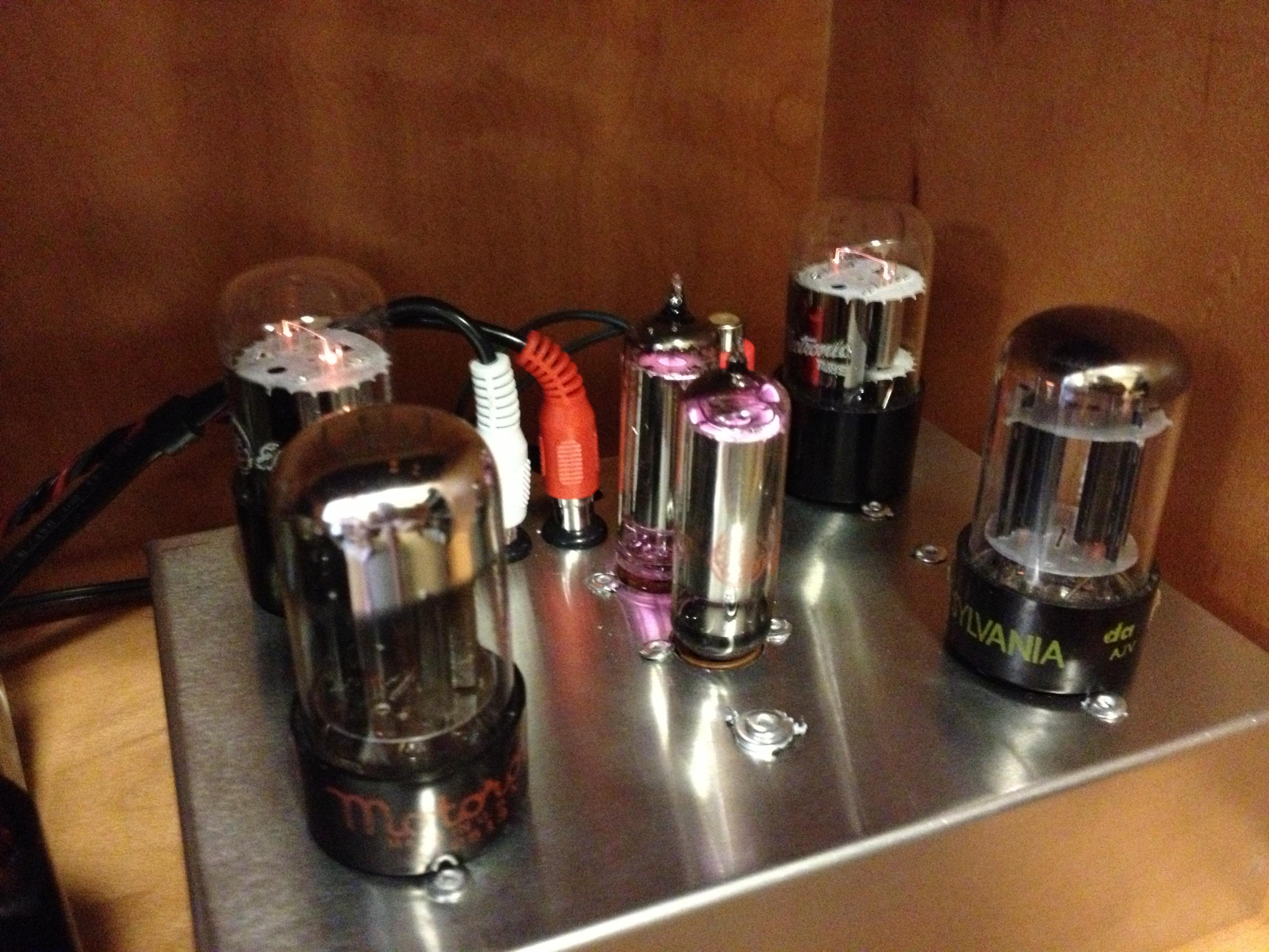

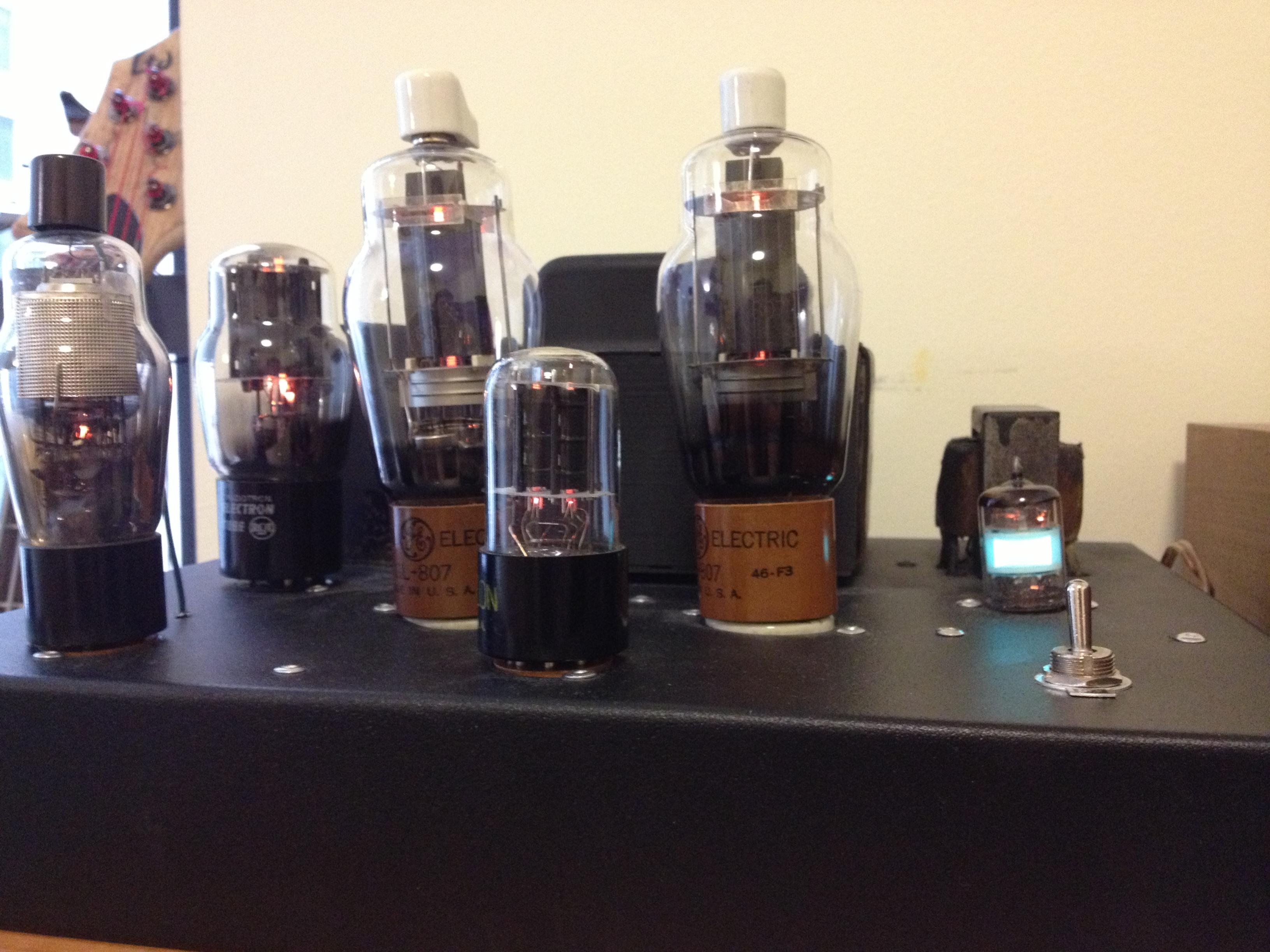

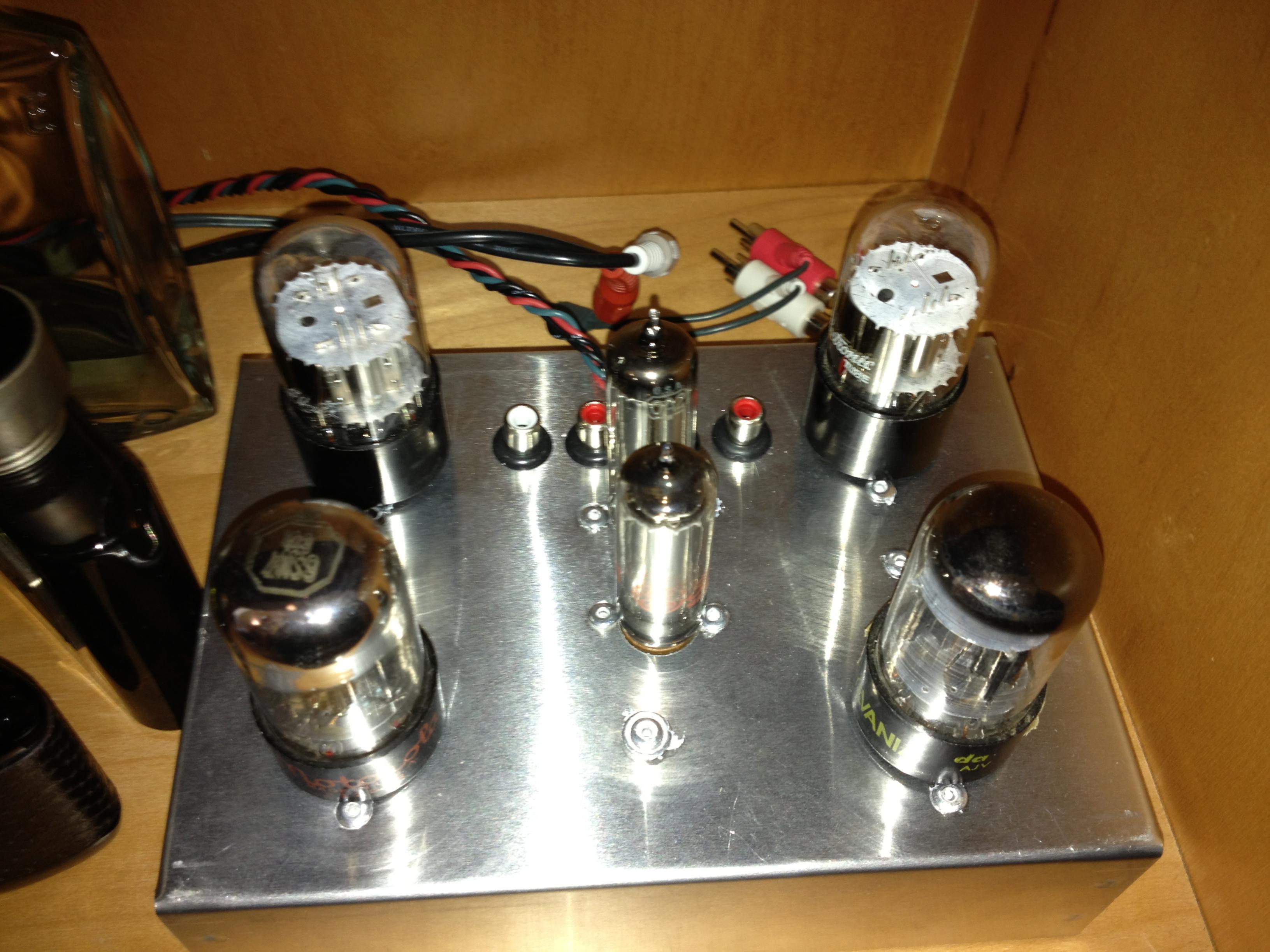

I work on projects when I have time and have even begun to design some amps myself (the one I'm currently designing is an 808 SE amp with 6SN7/ 3C24 as input/ driver) and have attached some photos of my work.

Thanks to both of you! Sure, I can post some more photos later tonight of my phono stage.
It's a 6SL7–>6SN7 with 255V B+ regulated by 0A2/ OB2.

Is the 808 s typo? They look like 807s.
dave
The amp in the pics is PP 807's. the amp I'm currently in design stages for is an 808 SE.

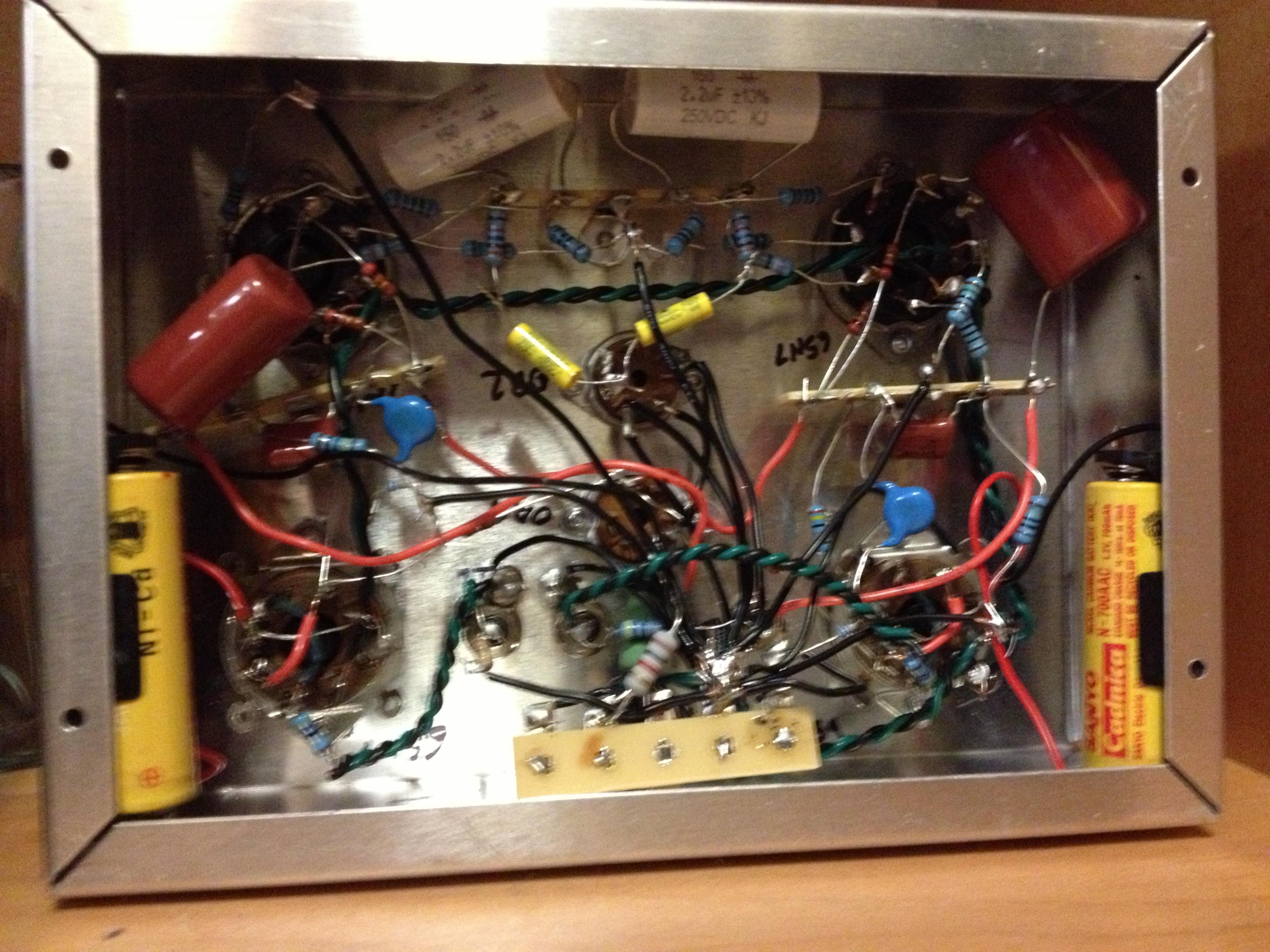

Attached are more pics of the phono stage. I based the design off this:
Jeremy's Tube RIAA Phono Preamp
It has a hum issue right now related to the filter cap, which I'm going to be replacing. I know the "rats nest" isn't as neat as it could be.
This thing is LOUD. I actually can't believe how much gain I get out of it.
SK
Grounding is everything! Phono preamps are devilishly difficult to get quiet until all the grounding secrets are well internalized. For this circuit, I'd make sure that, besides quiet power, you have common ground at the inputs and a combo of star and bus.
