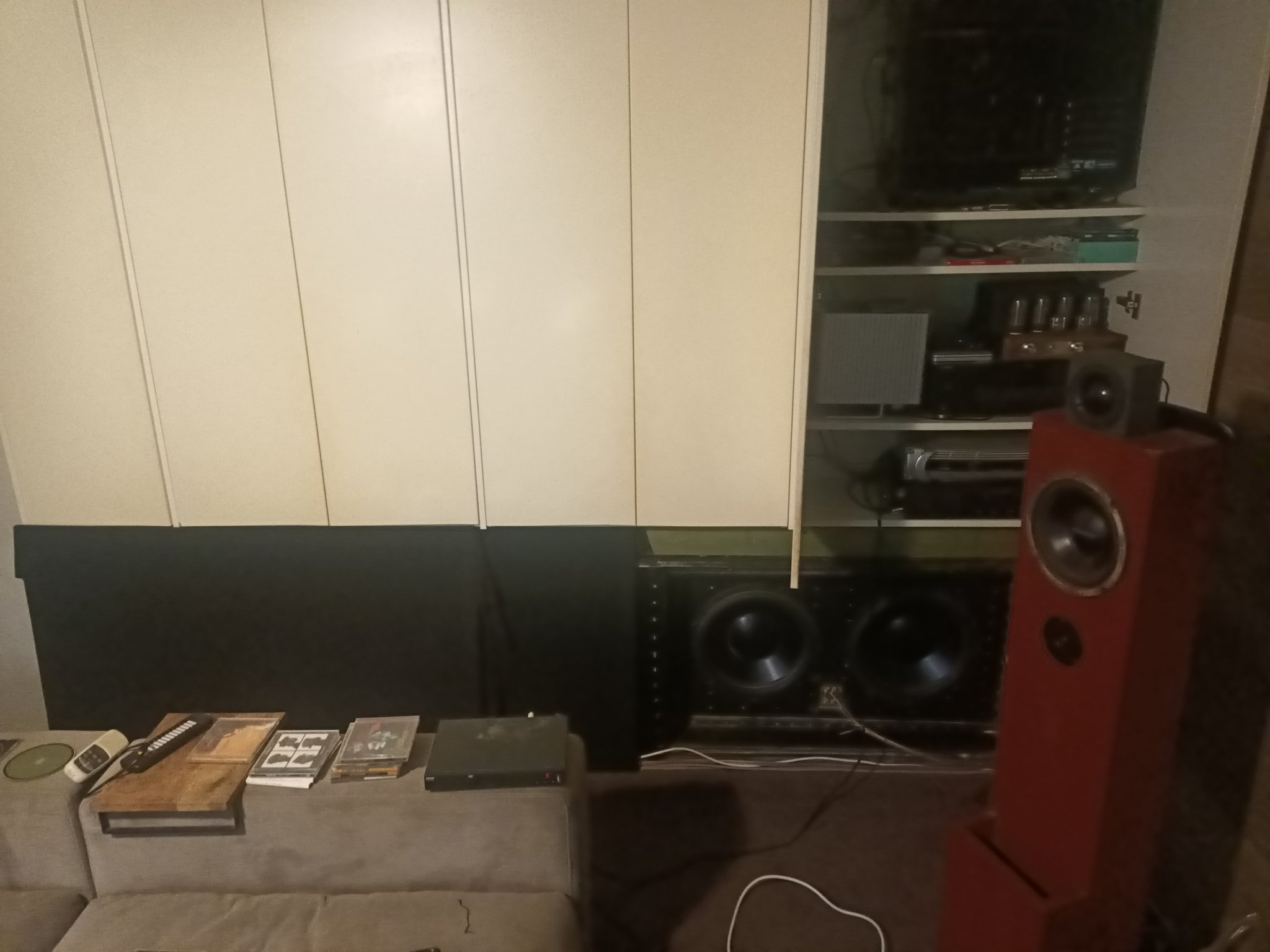

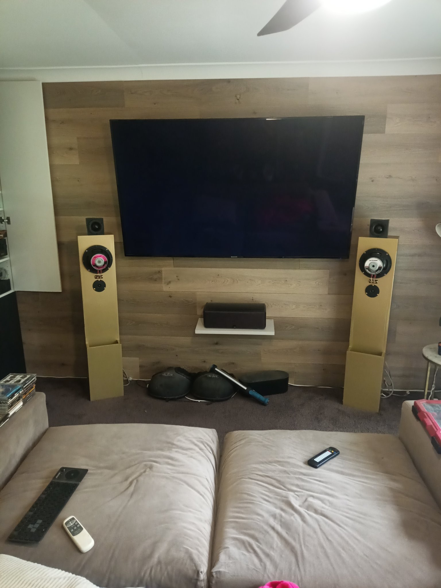

I have a system I'm proud of that I've put together myself over the last couple of decades and have rarely talked to anyone who knows about DIY home audio.

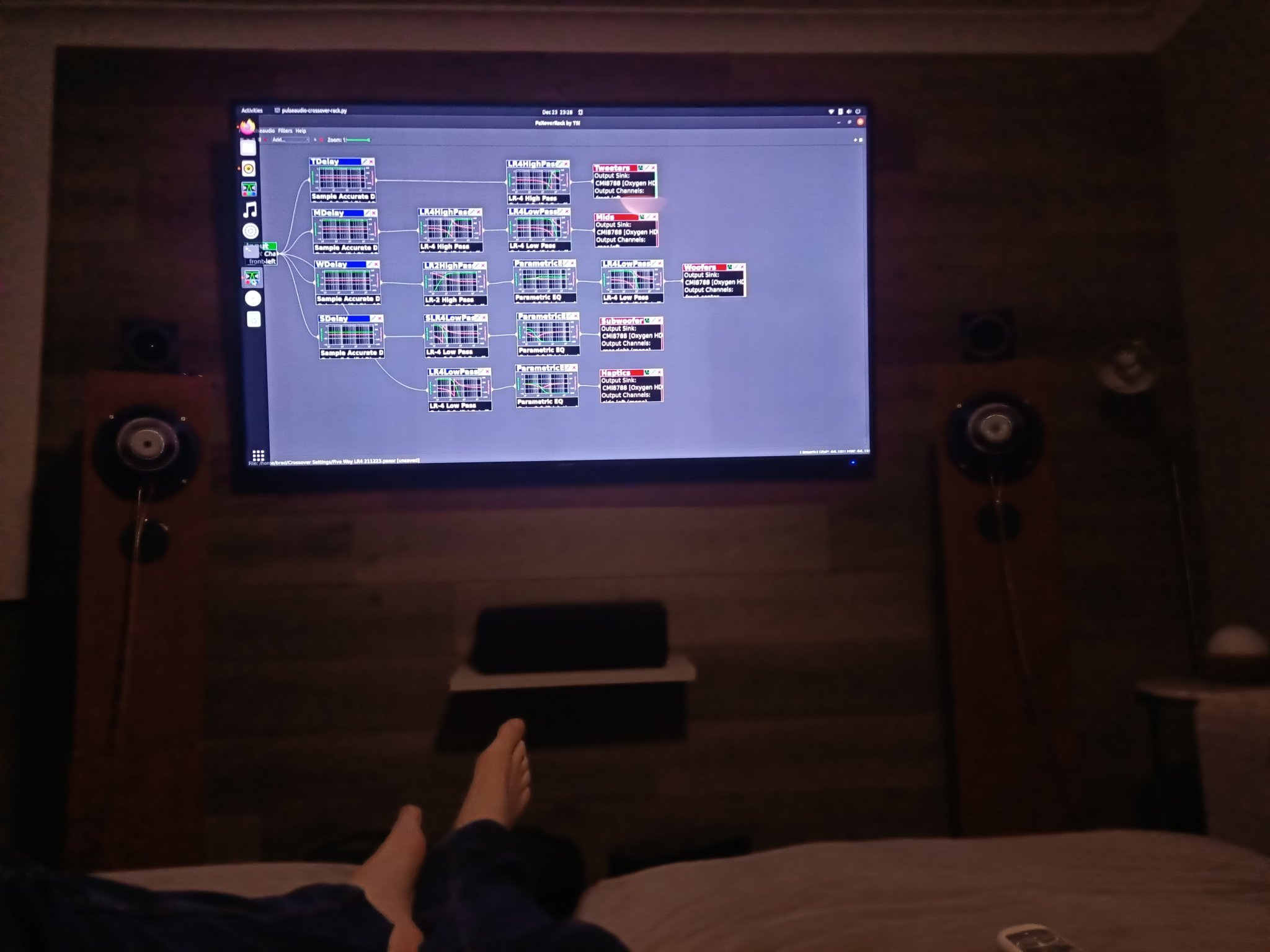

I have a custom Linux PC that runs PaXoverRack crossover emulation software into an internal ASUS Essence STX II
Then a vertical stacked:
Yayi pure class A valve amplifier
Yamaha 5.1 home theatre amp
Behringer Nu-3000
Nobsound preamp
Behringer Nx4-6000
Feeding: (pairs in the same order)

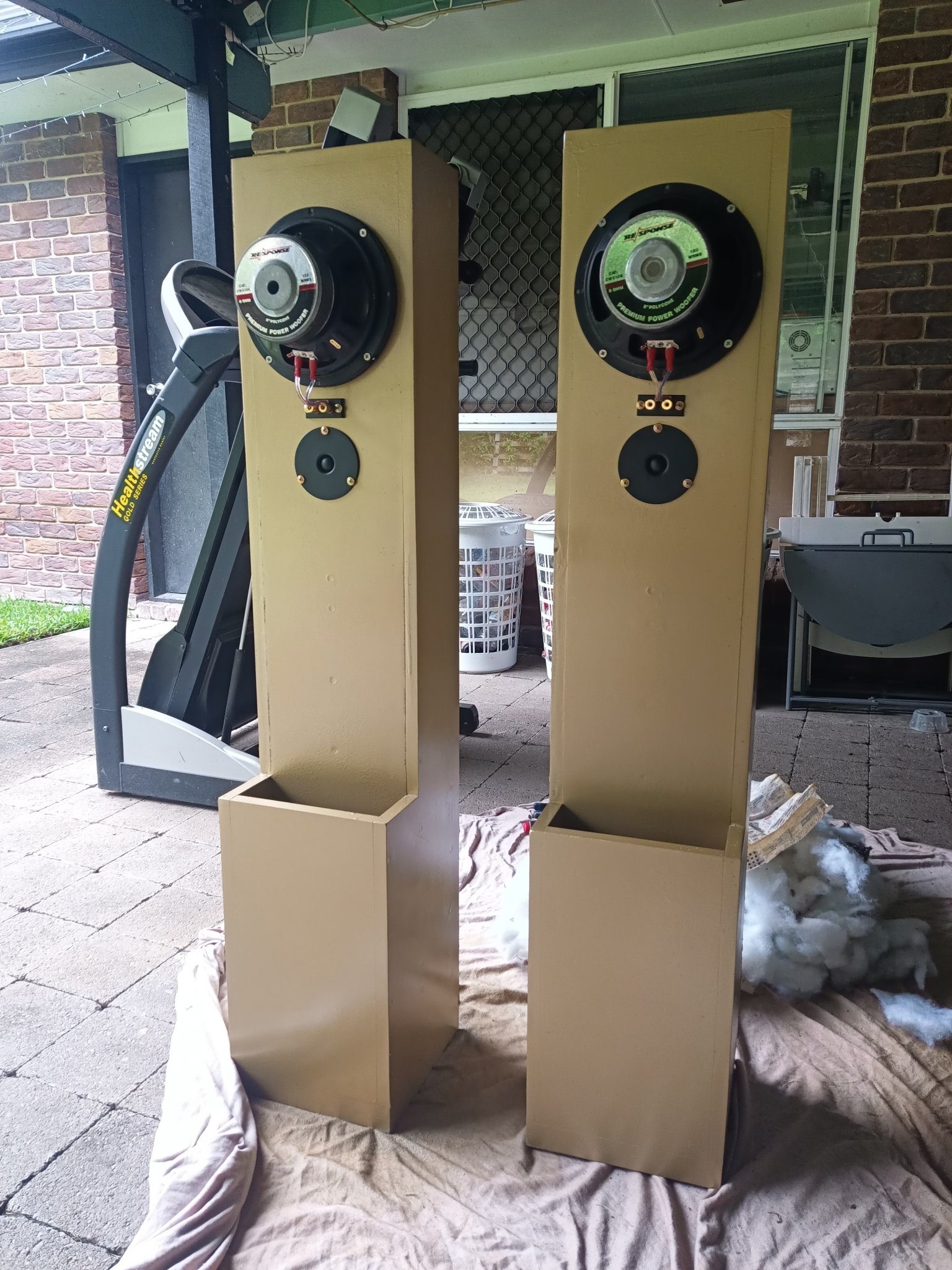

Vifa 1/2" soft dome tweeters
Morel CAM 558 2-1/8" dome mid
Isobarocally configured Re/Sponse 8" in a 30hz transmission line
Sub:
2x 15" Dyson Audio in a 5m TL
3x Buttkicker concerts

Current Setup:
SOURCE/CROSSOVER:
Custom Ubuntu Linux PC
PAXoverRack
DAC:
ASUS Essence STX ii 7.1 (incl Daughter Card)
PREAMPS/AMPS:
Haptics/Subs:
Douk Audio NS-02e
Behringer NX4-6000
Woofers:
Douk Audio NS-010p
Behringer NU-3000
Mids:
Douk Audio NS-10p
Yamaha
Tweeters:
YAYI Music Angel EL34
SPEAKERS:
Box:
Custom Transmission line
Woofers:
Re/Sponse CW-2136 (Isobarik loaded, Cone to Cone)
Mids:
Morel CAM 555
Tweeters:
Vifa D19TD05
