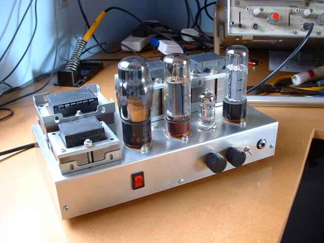

Here are a few pictures......
This was my first valve amplifier and still my favourite for use with loudspeakers. It works really well with my aerogel transmission lines (see subsequent post for picture) and I often swap out my Sugden A21a in favour of this one.

U mean the soldering iron in the pix. (Antex 'C' 15W) or transformer iron - a company over here used to sell kits for power transfomers in 20VA, 50VA and 100VA sizes - the output transformers were created from 2x100VA kits by creating a larger winding former using the cutting and glueing method!
BTW, the first amp weighs nearly 7 kilos. I generously sized the output transfomers (and was rewarded with deep tight bass)

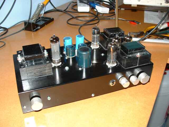

tonecat said:or transformer iron /QUOTE]
That... te OPTs... the 12BH7 amp the same? What primary you using?

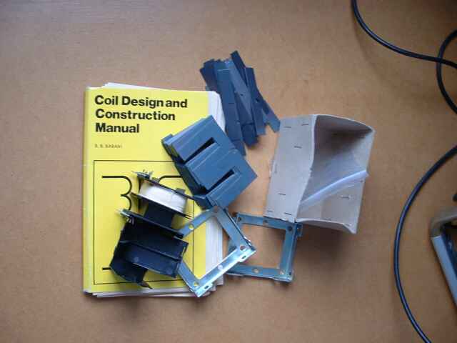

Cal, I just noticed an unused 20VA kit on the shelf similar to those I used for my amps. The E I laminations can be interleaved or stacked, gapped and glued with a magnetically inert spacer (err.. cardboard). I had to use studding to replace the bolts for the first amp's output transformers.
The book is the Coil Design and Construction Manual by B.B. Babani - an excellent all-round guide to DIY coils and transformers for radio, audio and power. As you can see, it has fallen apart due to frequent use!

Dave,
have a look at http://headwize.com/projects/showfile.php?file=frazer_prj.htm - scroll down to Amplifier Circuit Note 8 which describes how I made the transformers for this amp
I don't have the 12BH7 specs to hand but I did arrive at the impedance ratio of 2k7:8R by empirical means rather than finger-in-the-air!
