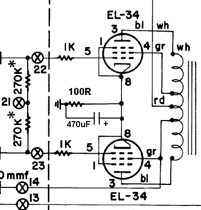

Is this what we're talking about? (see diagram)
Yes, that's it. Part of the total bias voltage comes from the drop across the 100 Ω resistor. The bulk of the bias voltage comes from the already present negative supply. Please notice that setting the operating point is easy. For argument's sake, make the EL34 "idle" current 40 mA. per tube. Adjust the bias trim pot. to get an 8 Volt drop across the 100 Ω part.

Please enlighten me... I don't see the advantage in installing a 100 ohm resistor in place of the stock sized resistor from cathode to ground . I have been told by some on this board that installing a smaller than 10 ohm resistor from cathode to ground would make the amplifier sound better. What exactly will make this mod out perform installing an additional bias pot with two ten ohm resistors (one per tube) cathode to ground and adjusting the bias to obtain 40mA per tube. The mod that has an additional bias pot would allow for any miss match that is likely to be there when dealing with used and or unmatched tubes. Having to deal with the original factory designed bias circuit is a pain.

The "hybrid bias" scheme will allow the higher B+ voltage of SS rectification without exceeding the power dissipation limit of the output tubes. The 100R cathode bias R's will drop more volts than the stock 15R, reducing the voltage drop across the output tubes.
You could still use separate bias adjust pots (one per tube) with the hybrid bias scheme also......
