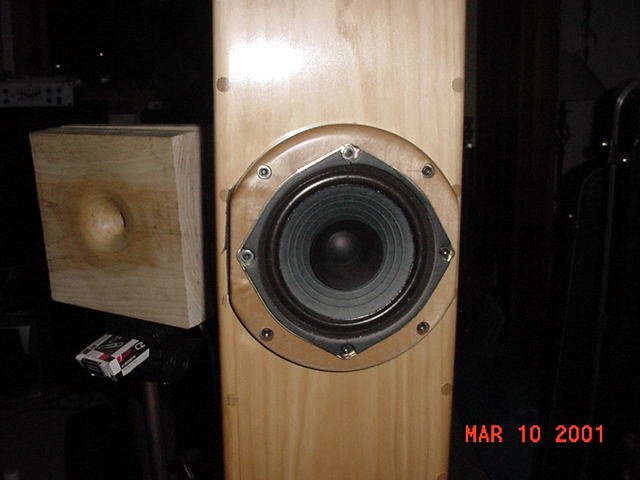

I've tried a few different inexpensive full range drivers in the pipe and came to settle on the RS 1354 , the best by far. I would like to try some more as time and money allow ( fostex maybe lowther someday) The 1354 is a nice driver for the money although a little loose in the bottom. The midrange is very good.

Have you done any of the "standard" tweaks. If not there is a lot more you can get out of the humble 1354. Is it a classic voigt? If yes you may be able to tighten up the bass by restriction the port somewhat. The refernce design for these is Bob's ML-Voigt. When i get around to my 1354s i'm going to do a bipole variation on those....

Hi dave thank you for the links !! I especially like the bipolar design.
I've tried a few tweaks, I really don't know what the standard tweaks are.
I don't remember who's voight design I used, I changed the design, kinda rule of thumb to make it easier to build with what I had on hand for materials and tools. The only real difference is that I put the port on the bottom and made the legs adjustable to vary the port height off the floor

Ductseal the basket (and use it to shape the area between basket & magnet to make it smooth)
treat the cone... dammar seems to be standrad, i like puzzlecoat on the cone and dammar on the whizzer
the 98 cent tweak (various ways of supporting the whizzer at its edge). I use a thin piece of light foam rubber cut into a strip and wrapped around the outside of the whizzer so that it damps tha whizzer's outer edge.
Then -- not a regular tweak -- but a significant one is a dustcapectomy & addition of phase plugs.

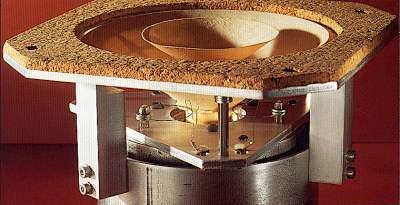

Just an aside here but do you know of anyone building their own drivers? I gave it a try once but gave up too soon. I was inspired by Be Yamamura, of yamamura churchill

I have a buddy in Calgary that used to build his own drivers (he bought cones, voice coils, and magnet blanks).
There was also a fellow a while back on the Full Range forum making his own driver.
