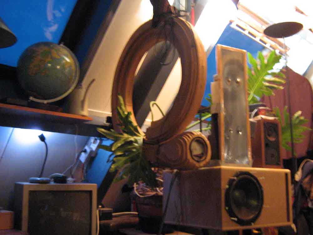

They are much like Bowers and Wilkins (B&W), I built a small version of the top model (Natilus). Only I made it a two-way transmissionline (open end...)
They are really amazingly good acoustic (or should I say non acoustic) shapes I've ever used as an enclosure.. They sounded really pure..
I do intend to build them up again and do some nice finishing on them...
Here's a picture of what's left of it:

Very nice links fellas,
and nice artistic work Cal!
I designed the 'Nautilus' kind of design in 3d studio max and sliced the shape into several slices, printed the shapes on A4 papers that I taped to the wood (12mm MDF). The rest was some 150 meters on the electric saw...(sweat dripping business)...
A DIY CNC-machine would make a lot of dreams come true...
