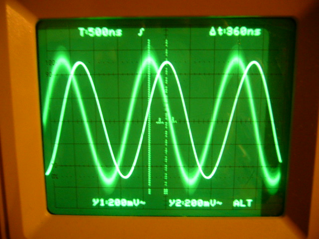

Analsys 7d
Good Evening Edmond,
I replaced the Cascode. R9B & R12B are bridged. The R13/R14 are still in place but I will remove them tomorrow for a try.
Just to have everything lined up here is the .CIR again As-Built Ver7d.
I plotted some extra points on the AC analyses too. There seem to be an interesing figure. Any clues to why it looks like that?
I also send you a picture of the scope trace at 550KHz Sine. The Gain is near 0 (1 dB or so). You can see the phase delay.
You can also see that the output trace is shifting up and down and makes it unclear. It looks like a sine wave with a very thick trace.
Is this normal ? Is this related to my phase problem or not?
Greetz
Olivier

Edmond,
I did not read your post before i posted mine ...
I removed QCC1 and QCC2 and placed a bridge between Collector and Emitter. The rest was left in place.
