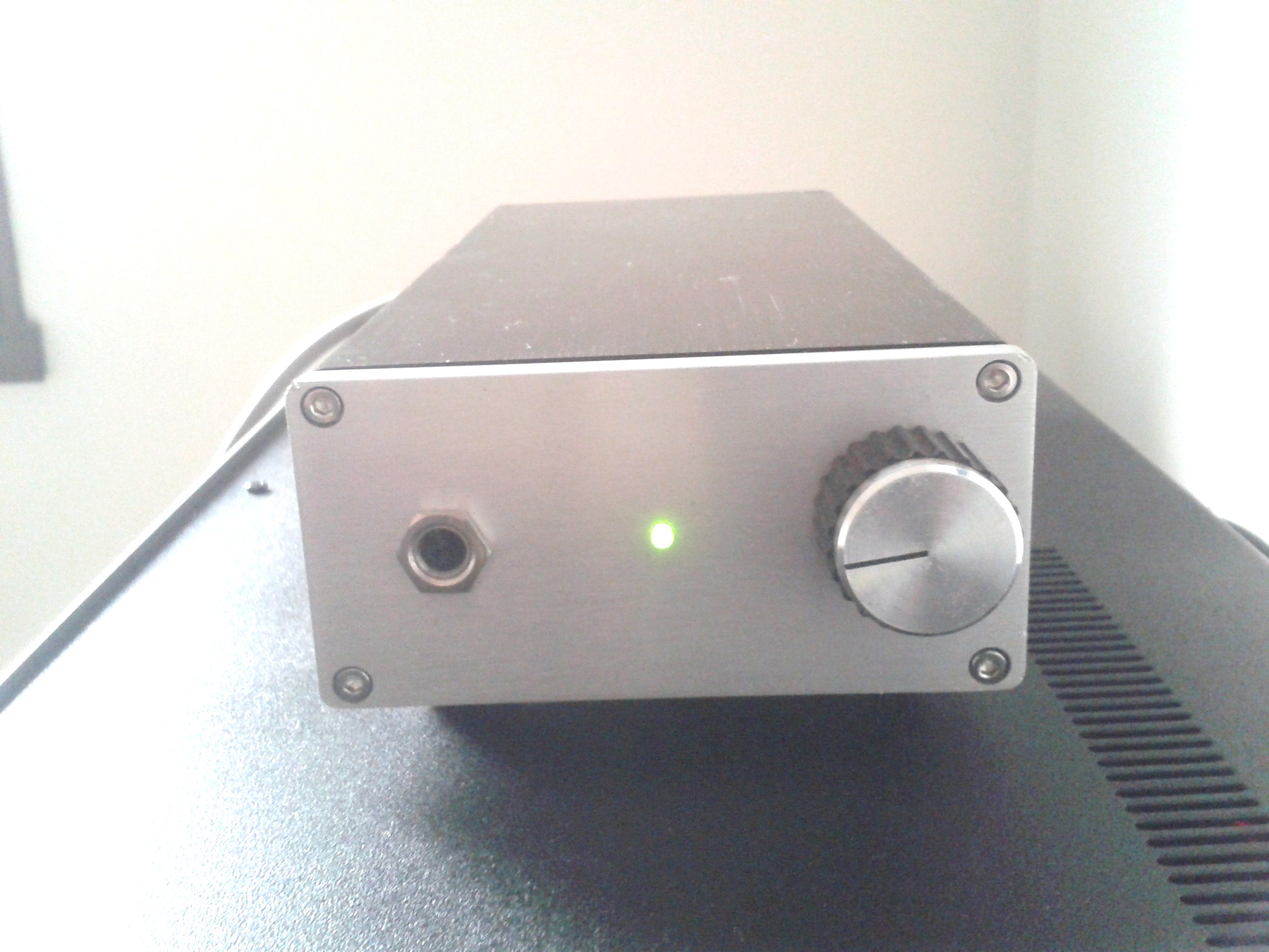

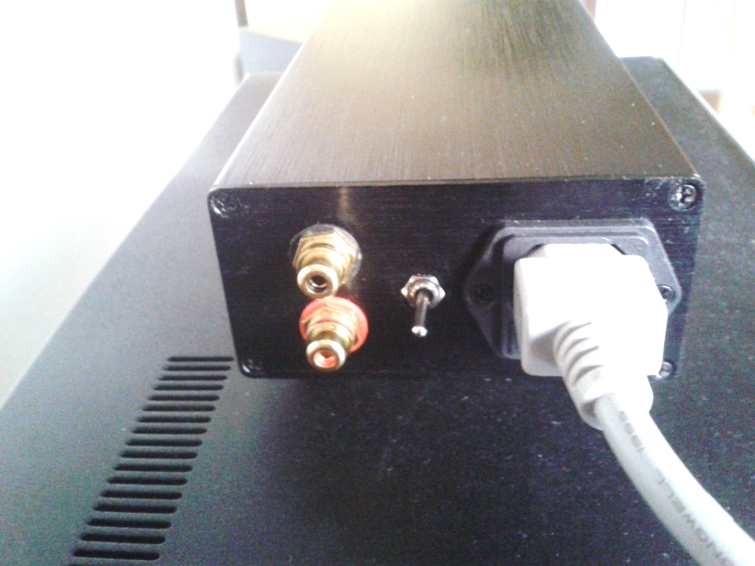

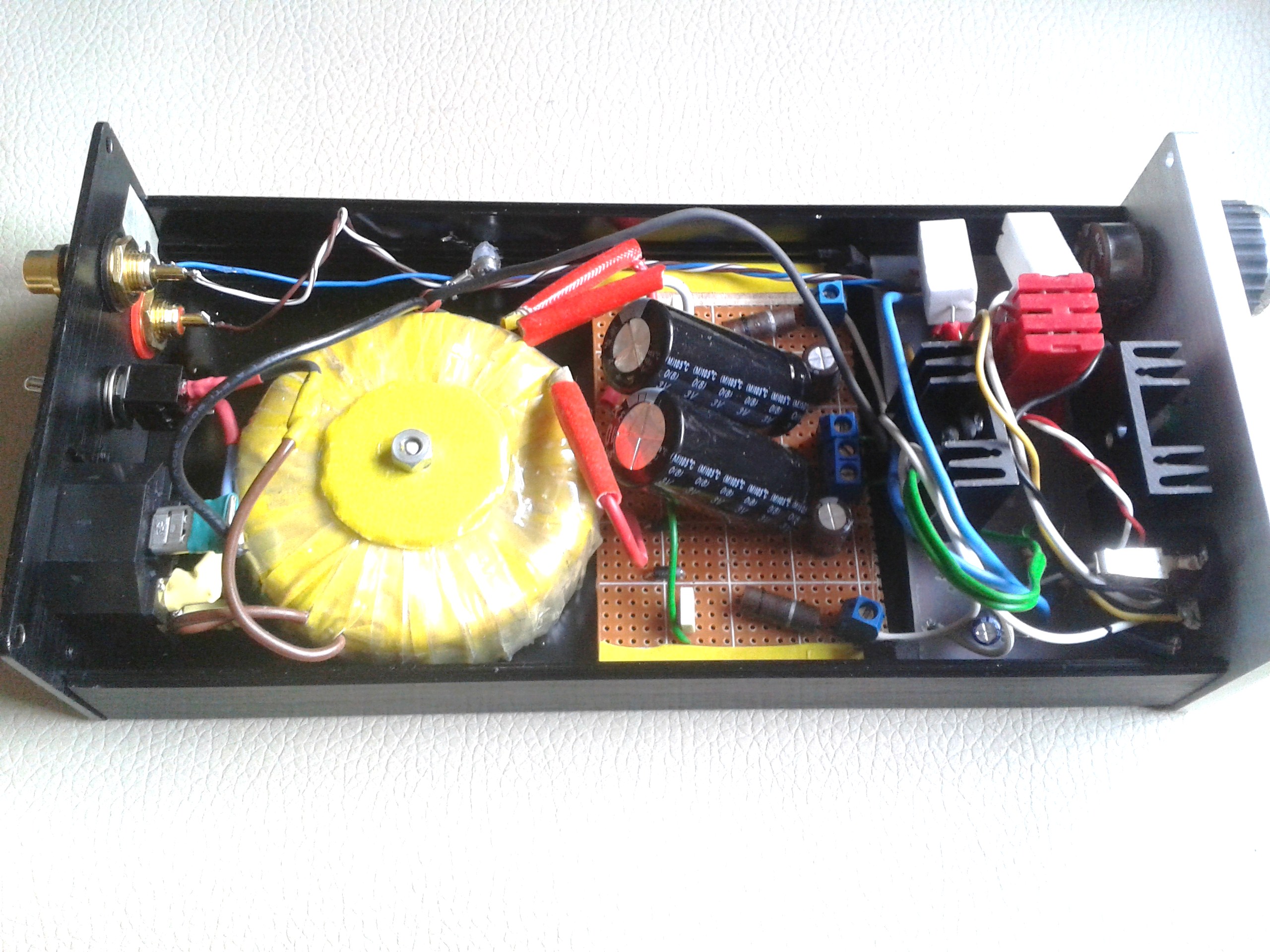

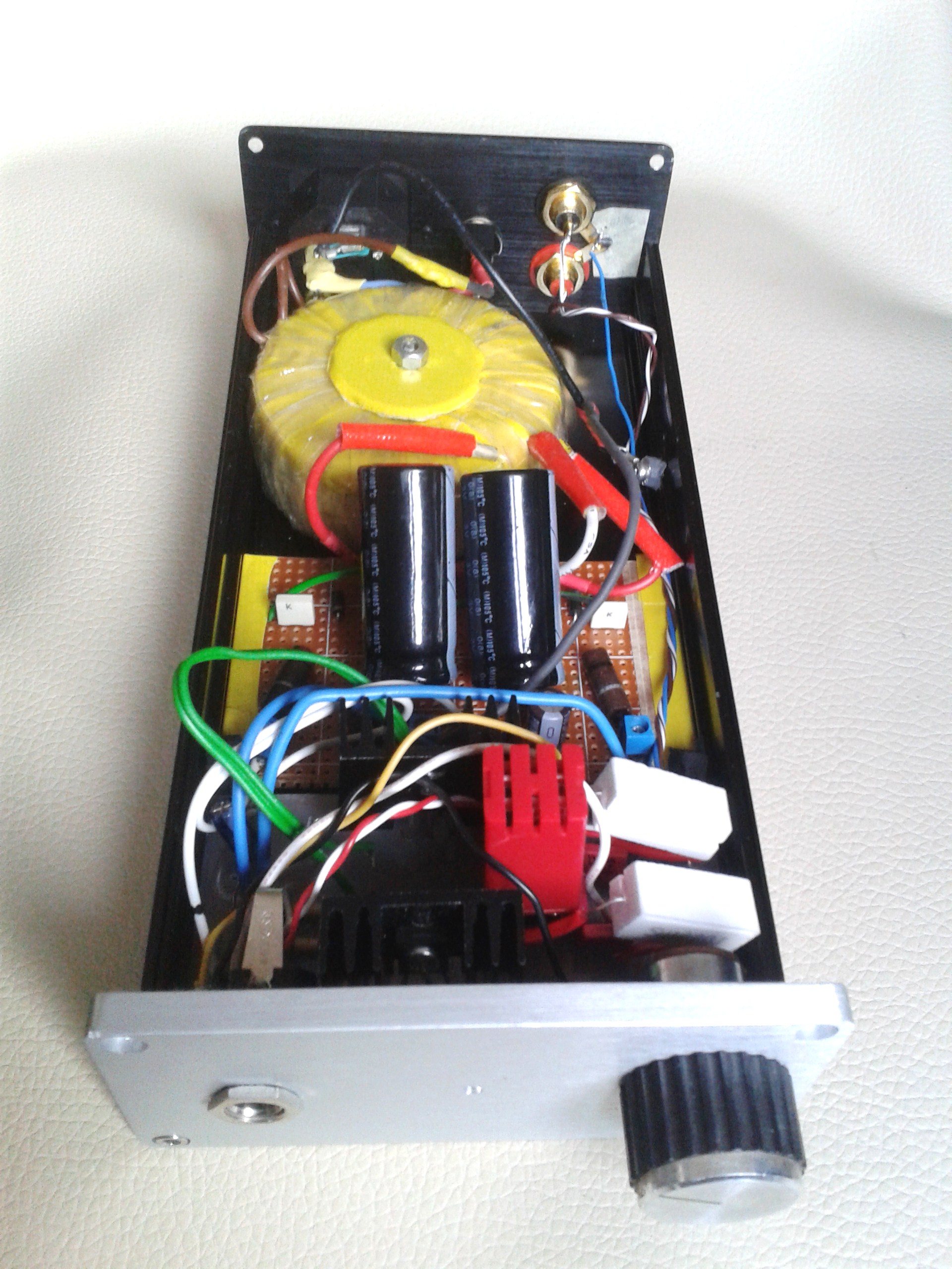

Evening....Here's my last project based on the HEED clone as headphone class A amplifier (I already built one identical times ago), but this time improved with a toroidal transformer and a better PSU filtering. The trafo is a 20VA with c.t. secondary (9-0-9)...reservoir capacitor for PSU a 10000uF/25V and a filter Panasonic FC 100uF25V for the RC part.
In particular, the better side of this amp was possible thanks to the kind gift of Carlos of Burson Audio, giving me the wonderful V6 Vivid opamp making it litteraly "fly", compared to the standard opamps (like NE5532 or similar). A really nice and realistic listening to my ears.
