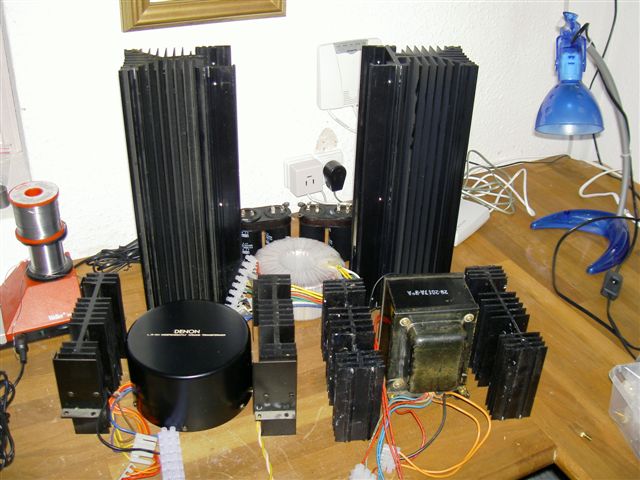

I have attached a picture wich shows different heatzinks
To the left from a denon pma 850 (28 years old) 85w with 1 outputpair / ch 6,5 kg toroid 2*2*40v AC
To the right from a NAD 3080 100w 2 outputpair/ch 6 kg trafo
1*ct 26,5 v AC

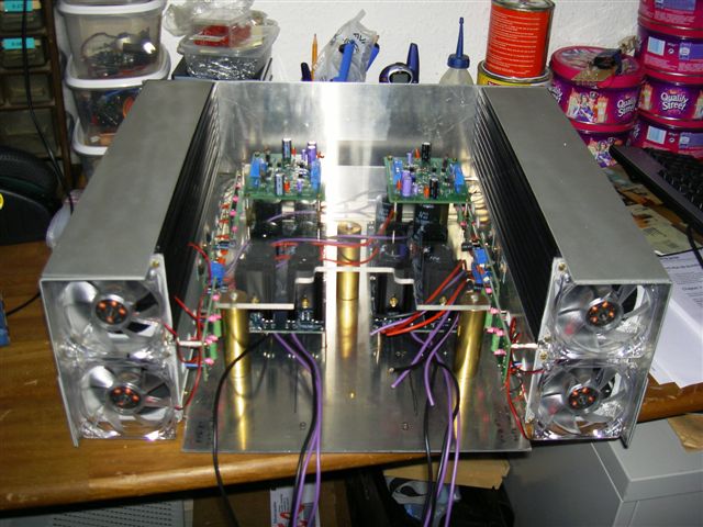

And behind those wich i have used fore my KSA 50 with 3 outputpairs/ch
In that case i was recommended to use fans too, even though that the heatzinks are big.
Most amplifiers build in this forum got huge heatzinks and my main question is, what makes the difference from older heavy gear till new heavy gear ?
Before i decided to take the Denon apart i played with it and it never did get very hot-and it was class A ....
