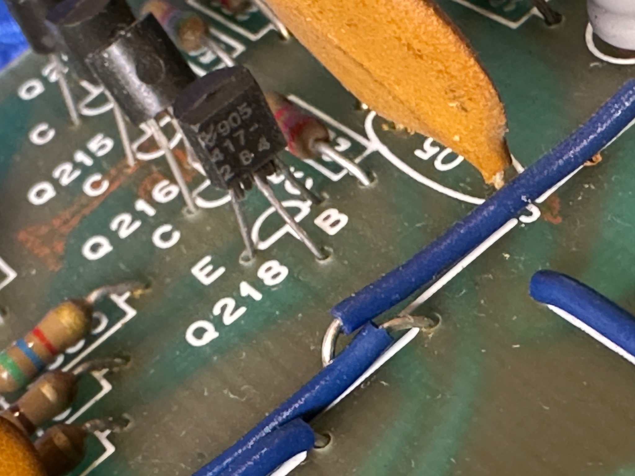

I started working on a Heathkit AP-1800 Preamplifier that lost the left channel. The included documentation of this preamp is very thorough, but many of the transistors have a proprietary Heathkit part number that I can't find information or datasheets on.
There many of these two BJT's used:
SM07275 (NPN) Heathkit Pt#417-283
SM62186 (PNP) Heathkit Pt#417-284
I pulled several and tested with a Peak DCA75 analyzer.
NPN's: Hfe 220-320, Vbe 0.770V, Vce 0.040V
PNP's: Hfe 230-285, Vbe -0.765V, Vce -0.070
BC547B/557B could be a possibility, but with so little info known about the originals, I'm not confident enough about this choice.
The PNP's have the dreaded black legs up to the transistor base with webbing connecting the three legs.
Any information would about substitute BJT's be greatly appreciated.

I don't get that concerned about black leads if everything is working properly. I certainly wouldn't change anything that's working, though if I change one channel, I change the other to match. You can start with the supply voltages to determine what you might need, plus a bit of thinking about the circuit. Since you can use the Peak to get some idea of hfe, it should be easy enough to test replacement candidates.
