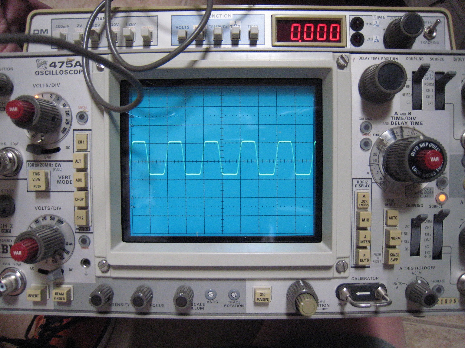

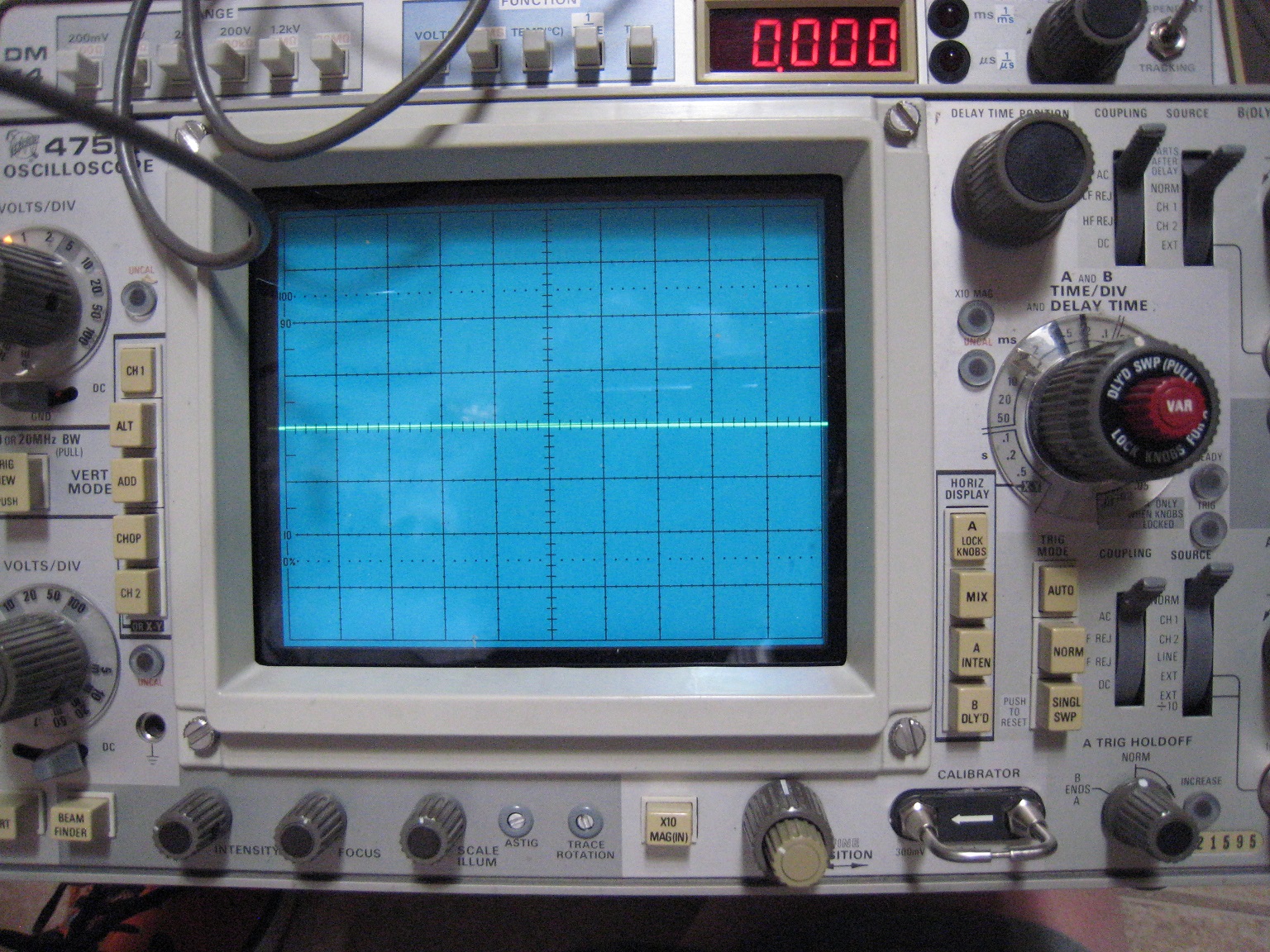

Going back thru the Adjustments section of the assembly manual and using a scope for the BIAS adjustment, I get no change from the displayed waveform in shape or amplitude. The Period shifts slightly when adjusting the BIAS pot full CW/CCW. I also am not getting a 10VPP output as measured on the scope. The panel meter indicates 10V. The waveform is clipped at top and bottom and does not change with the adjustment.
This is supposed to be a 1Khz waveform at the front panel output?
See attached photos.

That's nowhere near a SINE.
The impulse is to trim the Feedback until it comes down out of clipping and looks like a Sine.
Yes, to set Bias you want "some" clipping. But not gross clipping.
There's other possible troubles and confusions. Did you verify the DC voltages in the sine oscillator?
