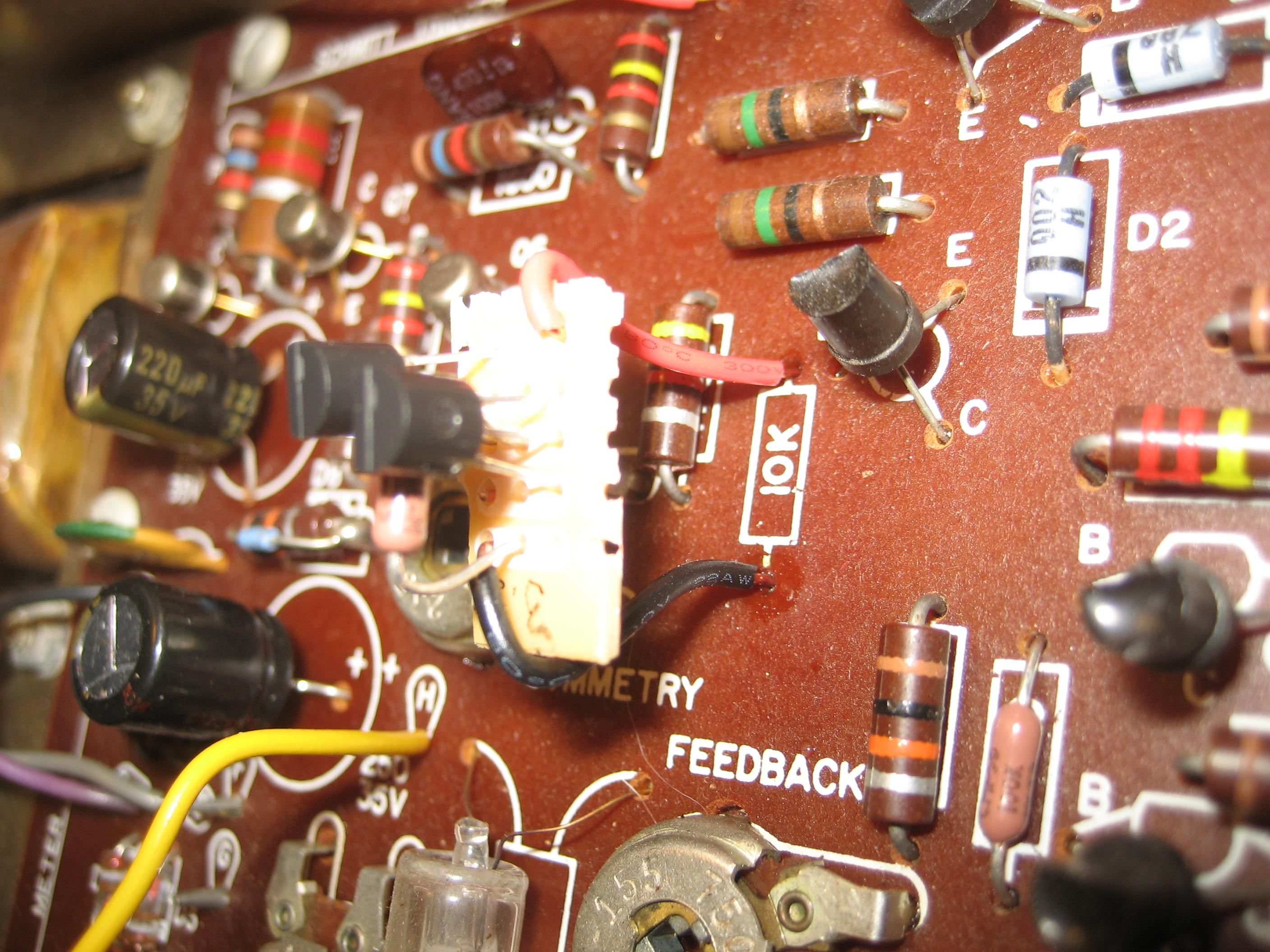

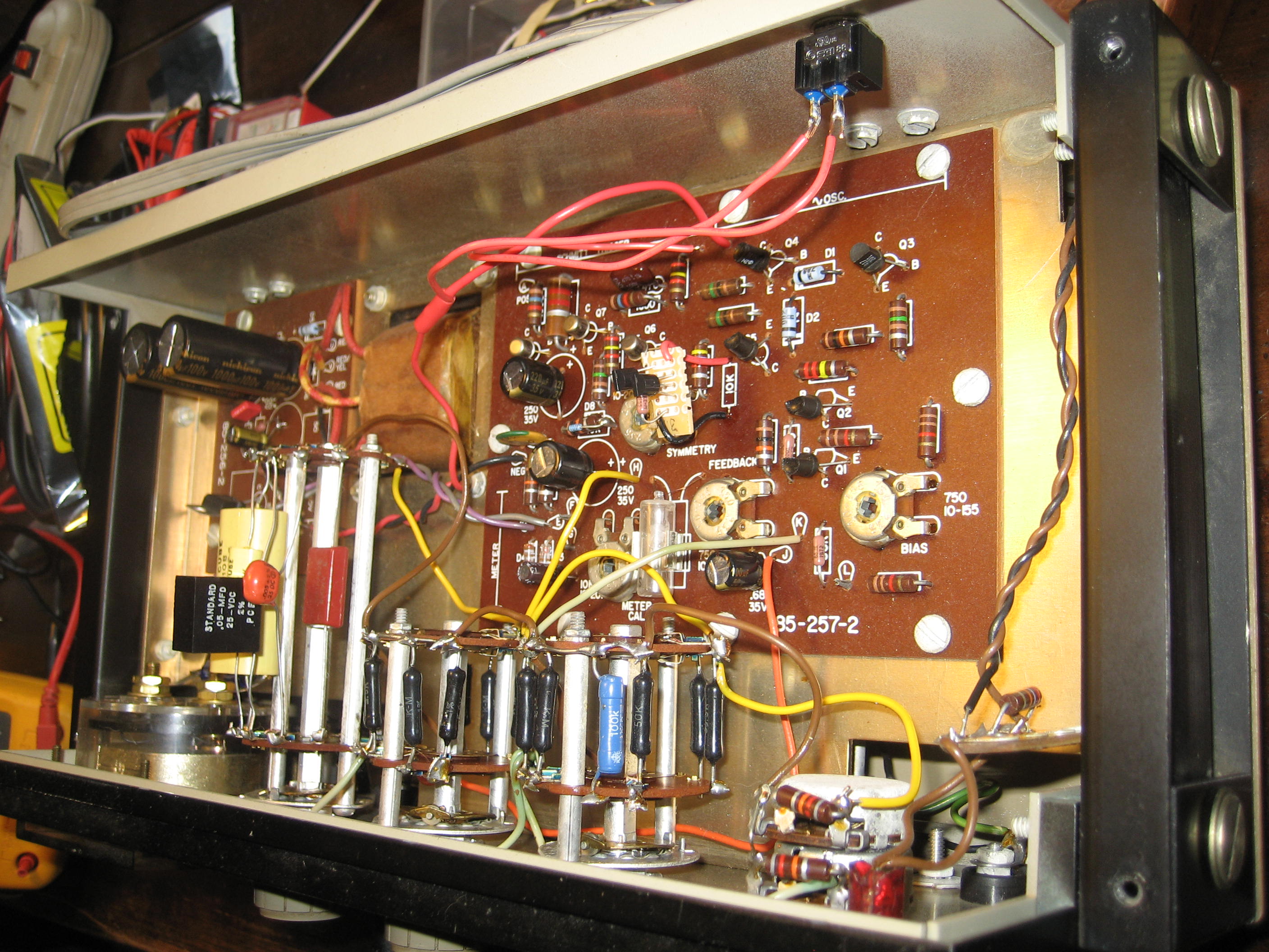

I got as far as checking all voltages on the T/S last night against the schematic:
1. All voltages for symmetry fully CW are off by more than 10%, but not by much (they're within 15-20%). The ones for fully CCW are OK.
2. Voltages for Q8 are far more off and potentially symptomatic. On collector, there is basically no change in voltage when running the symmetry control CCW to CW (it should go from 4.3V to 30V; it stays put at about 25V). On its base, variations are from 3.03V (CCW) to 3.25V (CW). It should go from 0V to 2.5V. I suspect Q8 and possibly D8. Thoughts?
I also just briefly managed to readjust with T/S off and run some measurements. The distortion results at lower frequencies were quite stunning (close to HP 334A floor level) at 0.014% (100Hz), 0.012% (1kHz), but it skyrockets from there (0.25% @ 10kHz; 0.3% at 100kHz). With the T/S on, these values are less stellar, but much better across the band (0.085% @ 1kHz to 0.068% at 40kHz). Stability remains very frail with T/S off, though, and settling time seems to visibly go up. If I could get this to work reliably with T/S on (wide range of output without motorboating, stable and clean output over 40kHz), I think I'd call it the day, though I love the project and really want to get the most out of it (and need a signal generator on my bench!).
You mention reducing gain. If I try to do this by using the feedback control (reducing output), I often encountered difficulties maintaining the output stable. This has always been an issue during adjustment per manual instructions - I can't really do the 6-8 on meter scale adjustment they specify and measure with DMM because the voltage bounces all the way between 6 and 8, if I can even get it there with a very sensitive feedback control. If I get it to 10, it's solid and I can continue adjustments. Luckily, bias control is also adjusted through the scope part of the measurements, otherwise it's had to make it when the needle is already at full scale from the first step. Any other ways to reduce gain, other than taking out the CCS from Q5?
Argh! What a humpty-dumpty this has been... I feel I should just order all Qs you mention on IG18#1 and rebuilt this from scratch with new parts.

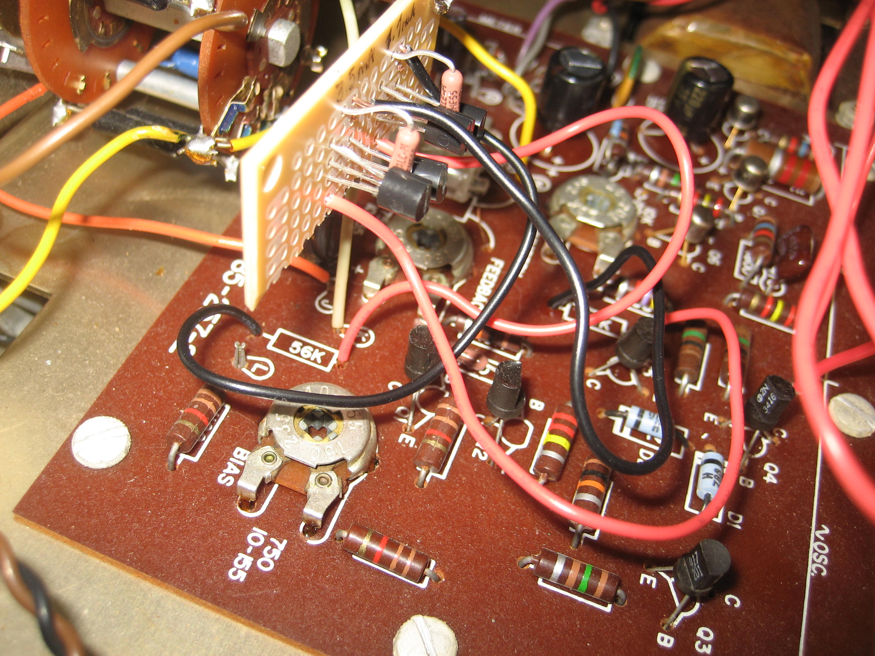

R3: kick it down a notch to 56k? (currently 100k) It dampens the gain of the differential pair, though I have it at the highest value anybody used there.
R11: increase it?... 1k is what you quote in your description.

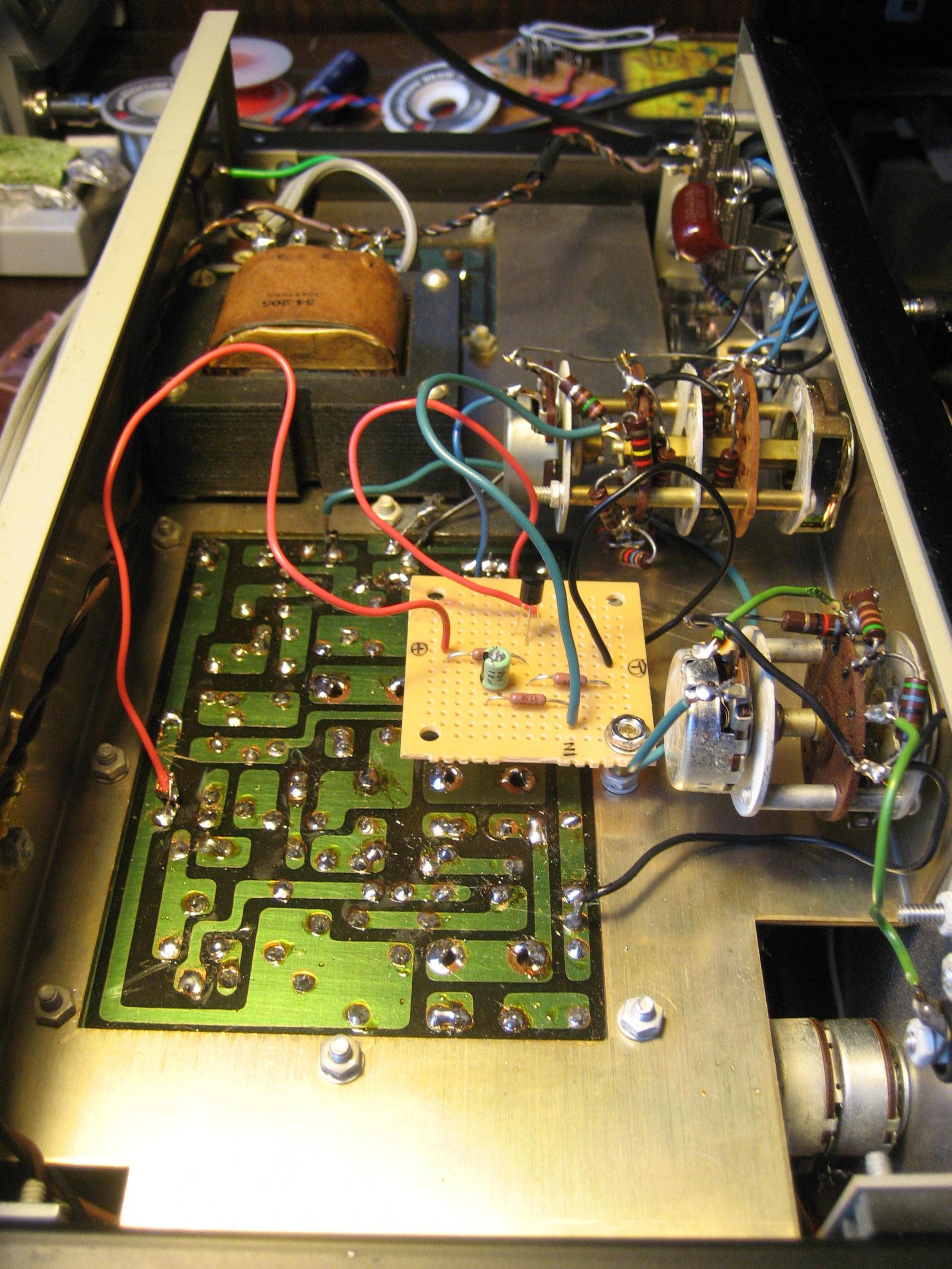

Done. The transistor was bad (though tested good on DMM), the diode and 10k resistor were not, and the square wave has cleaned up.
OK, now how about the upset of the sine when you disconnect the square -- is that fixed too? I raise this point because now, removing the square from operation will have a noticeable effect on sine distortion, especially at higher frequencies; but only if you have built the meter buffer stage, which I think I remember you did do...
Yes, it is fixed. I've switched the T/S on and off repeatedly and it doesn't seem like there is much upsetting of sine going on. A barely noticeable shift up and down the Y axis, but that's it.
Now, having that out of the way, here's how this thing is behaving at this point. Up to around 400Hz, I get pretty solid behavior, with an extending settling time as I approach 400Hz (which takes 15 seconds to do it). If I get to 500Hz, the settling becomes motor boating (or takes longer than 60 seconds, which is how long I've watched it on the scope). In other words, it never really settles down.
As a sample, 300Hz with the T/S off reads at 0.024% distortion. Pretty clean, with only the tiniest of spikes, barely noticeable on the 334A's meter. If I turn on the T/S, the read is about the same, but the spikes become noticeable and may go as high as 0.040%.

And just to give a bit of insight into this last step, based on my experience - the adjustments after the mods are done.
The main adjustment to work with is obviously the feedback control, and you may notice that it may feel much more sensitive than before all this was done. I've done this having a distortion analyzer hooked to output and trying to obtain a minimum. Running the pot through different positions, in my case, resulted in a very narrow range where the sine wave would be stable, and - not sure if luckily or by design - right around full 10Vac out. I spent a lot of time gently nudging the pot down in gain, and repeated may times when I pushed it out of the stability margins. Having a scope hooked up makes this much much easier to do - highly recommended. This is because the waveform allows spotting instability immediately and easily figuring out if it's up or down where you want to go.
When the feedback reaches a position of minimal distortion, adjusting the bias will bring the figures even lower. Not sure if going back and forth helps, but knowing how cranky the feedback control is, I preferred to leave it alone after reaching a minimum at - as richiem recommended - 10kHz. Spend the time with the feedback control - lots of it -, then just fine tune it with the bias control.
