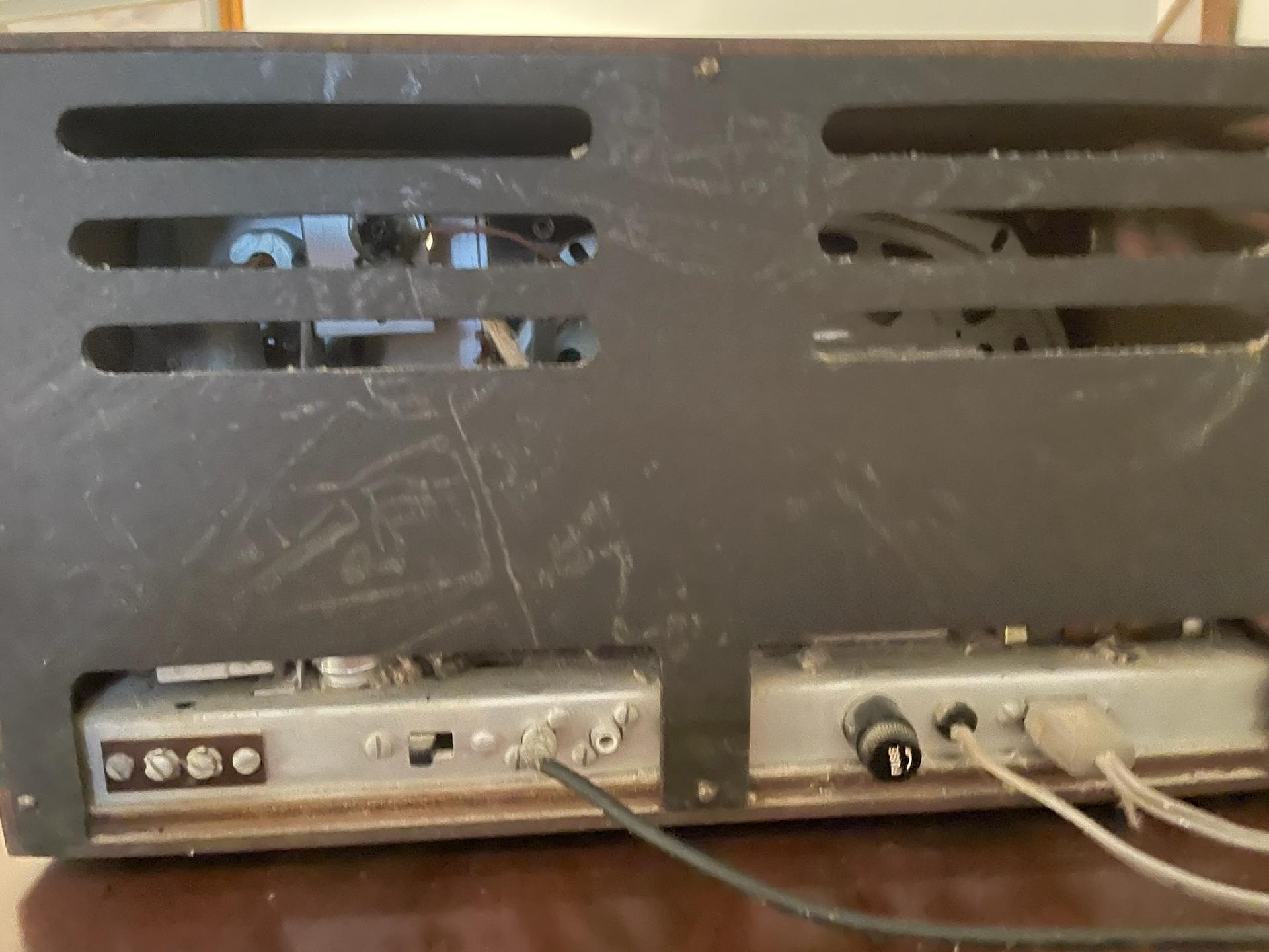

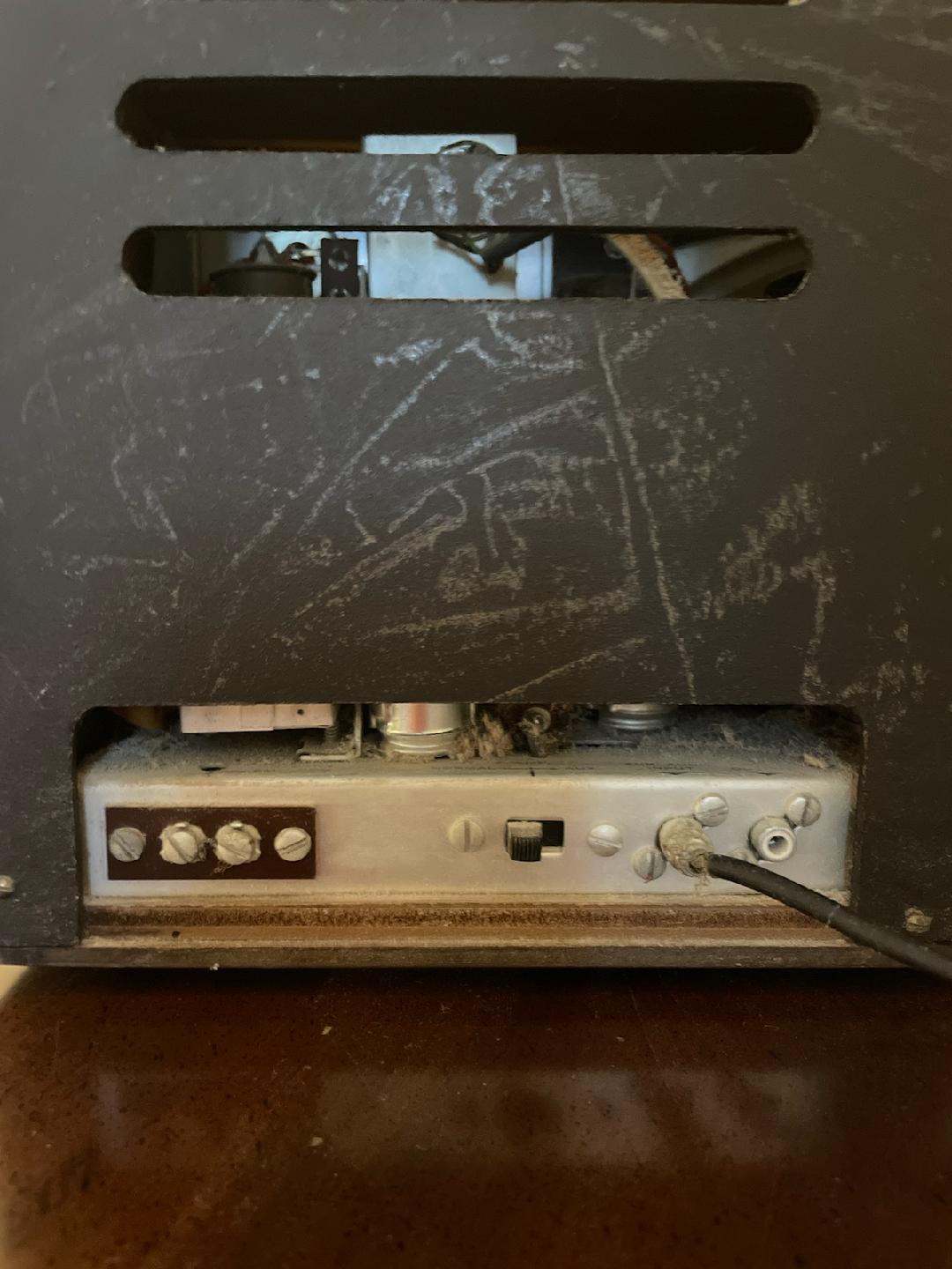

A question on possible Bluetooth input for this model. I do have the companion 2nd channel Box and I am curious about the aux. input as it is a single RCA jack.
Is it possible to get stereo out put using this jack from a bluetooth adapter, or is Mono even a hope? There is a back panel selector switch on the chassis. I am assuming it is expecting a mono audio feed. I am also assuming that the MPX processing will not apply to a line input, but you never know what might be out there to fool this old radio into bluetooth playback in stereo.

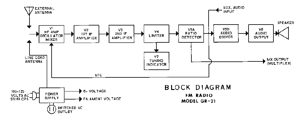

To clarify, this unit does indeed have the companion 2nd channel add on. So I see the easy path to mono aux. input, For the sake of illustration let's call it the left channel input for now. But i'm looking to tap into the circuit (please see attached diagram). my question....is the MX output jack something I could splice into via toggle switch to capture the remaining right channel. It doesn't appear to me to be doable.
Alternately is there an fm stereo encoder circuit or box that would broadcast that rca input on a preset frequency. Much like the old portable CD to car radio adapters of yeaster year?
I might have answered my own question with that last ponderance?!?!

Can't see the jacks, but looks like the companion contains a multiplex decoder and another channel of audio amp plus speaker. If so, you would feed from mplx output on the radio to a mplx in on the companion, then send one decoded channel back to the radio's aux input. Separate volume controls for each channel.

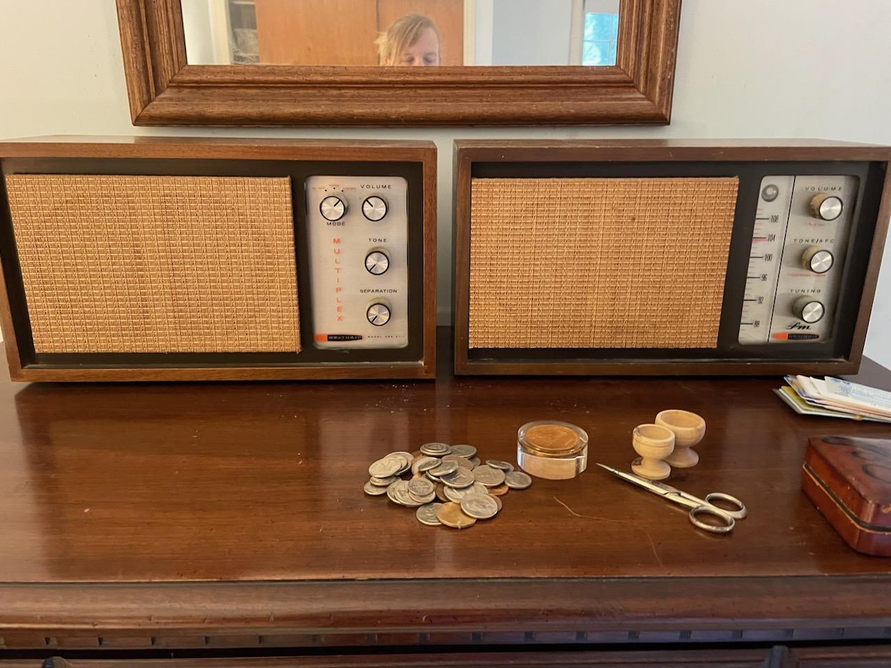

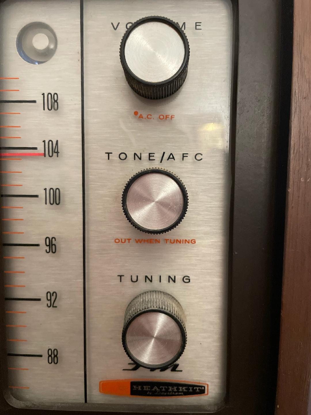

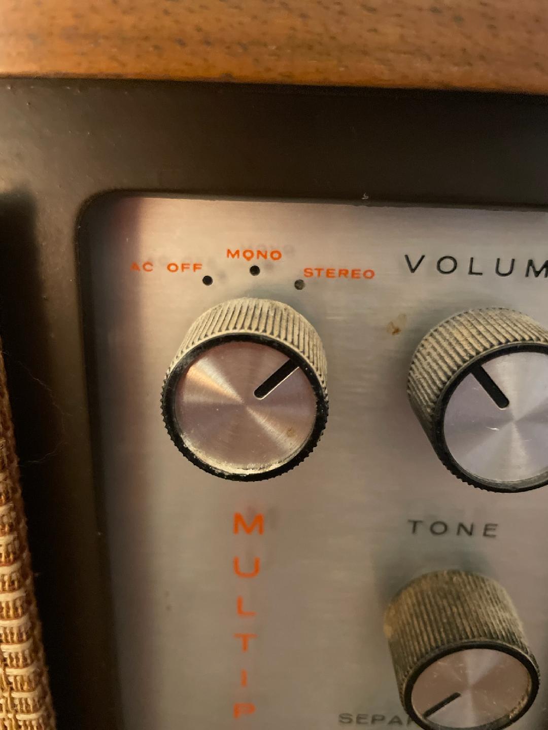

Thanks again for your time and input. I do not have these units in house at the moment, they are in route. But as soon as they get here, Ill have a better idea on the channel hookup and more clarity on the input output options. Attached are 2 views of just the Tuner unit. That's all I have until it arrives here.
Im still "Bird-doging" documentation on the complete set.

I have the schematics, email tbavis(at)rochester(dot)rr(dot)com. A Bluetooth receiver could be installed in the FM multiplex adapter unit, since both channels are there, but a switch would be needed before the dual volume control. The AUX input on the main unit is mono only, and the separated channels are only present in the stereo adapter.
