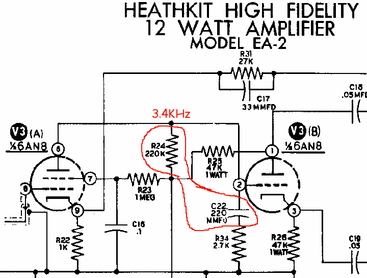

I have just found the instruction manual for an old heathkit EA-2 amplifier, its looking very similar to what I am looking in to building. Does any one have experience of this circuit ?
Also is the ECF82 a good choice for triode pentode or would a 6BR8A be a better option ?

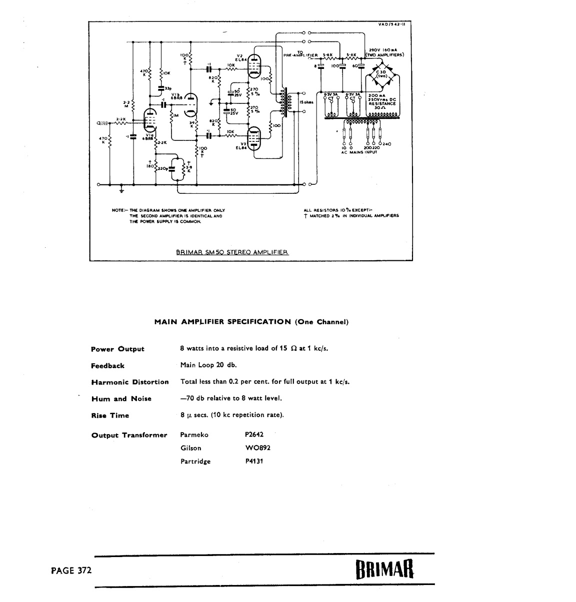

The heathkit looks simple, I am planning on a small push pull amplifier 5+ watts for a desk. 300mV input and a 8ohm out put with a volume control on the front, a headphone monitor would be a plus point.
I was looking in to pentode input stage, triode concertina phase splitter. Then a pair of EL84's in ultra linear with a 43% tap on a 8K transformer. I want to keep it simple and it will all be built on tag strip, HT of around 300V from a GZ34. DC heaters to front end valves and AC for power valves.

You are talking about designing your own pentode and concertina stages if you use the ECF82 or 6BR8A (I do not think you will find an amplifier circuit with those). The plate of the pentode may need a dominant pole to ground to make negative feedback stable (depending on the rest of the amp, and the output transformers). Ultra Linear usually needs negative feedback to get the damping factor up.

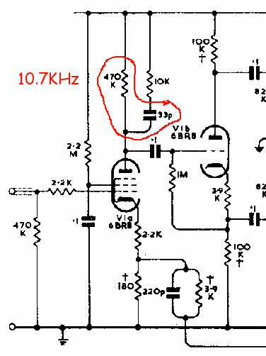

Sorry try this ...

6BR8 may be hard to find as replacements. It was originally designed as a 6U8 with a special pinout, and 6U8/ECF82 has numerous substitutes, which would at worst require a resistor value change. 6EA8, 6GH8, 6KD8, 6BL8, ECF80, and numerous others. (On the other hand, NOBODY uses 6BR8s, so there may be some around forever...)

This thread had been latent for a while, so . . . I did not re-read through the thread and find that this might be built to the Brimar amp spec. I thought this was for a Heathkit E-A2 amplifier. The schematic I got off the web did not have that dominant pole. (I looked for it, because that was my first thought). There must have been more than one version of E-A2, or we are now talking about the Brimar amp. Start with the exact schematic, or get in-exact performance.
Actually, the 470k is the pentode plate load. The 10k and 33pF is the dominant pole roll off filter. The amp uses negative feedback. The dominant pole is in parallel with the 470k plate load, it helps increase the amplifier stability. It is a way to deal with the total power amplifier circuitry, particular output transformer, and negative feedback circuitry. The total gain versus frequency, and phase versus frequency will cause oscillation if that is wrong (and may vary versus loudspeaker load too).
To most amp designer thinking, the 33pFd against the 470K (||rp which is large) is "the dominant pole". It "dominates" the important range above 10KC, where several unavoidable poles stack-up and phase goes screwy. By "dominating" it gets gain down so loop-phase does not go unstable before loop-gain gets below unity.
The 33pFd against the 10K sets a secondary zero up around 500KHz. By this point we are near stable, and we can drop-out this network, let the multiple inherent poles do their things.
PRR,
You are right again. I incorrectly called the 33pF and 10k the dominant pole. Some amps do not use a dominant pole that is a strict RC network. Remove the 33k and 10k, and the 470k merely becomes a plate load; but with the 33pf becomes the dominant pole. That was a good explanation of the whole circuit, including the second zero.
