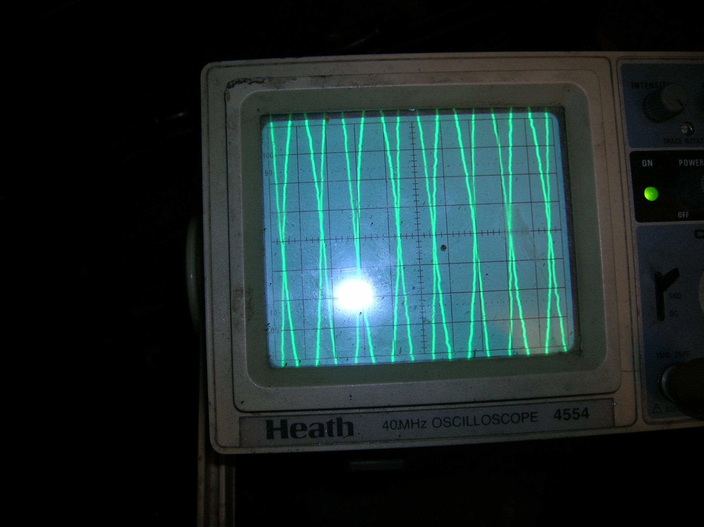

Is there anyone out there familiar with a Heathkit audio analyzer? Its a model IM - 22. I'm trying to use it to set AC balance on my Dynaco's. I'm really having a problem understanding the instructions. I did manage to get a reading and by using the pot on the inverted side of the phase splitter I was able to adjust it to a lower setting. But I can't figure out what the meter is telling me? And I want to know how much IM distortion there actually is?

That is correct. You should use a total harmonic analyzer. In lieu of that, you can also come very close with a dual trace scope assuming it has an "add" position for the two channels. The purpose of the balance control is to adjust the output amplitude of one of the phases. Either in the cathode or the anode. Since they are in antiphase, connecting each output to a scope channel and "adding" them will null the signal. Adjust the balance control for maxium null. (minimum amplitude) Use 10X low capacitance probes.So AC balance can't be set with an IM analyzer?
In full agreement with this. I use the scope methode for setting the AC balance on my Citation II. Of course, you also need a signal generator which can come from a free smartphone app.

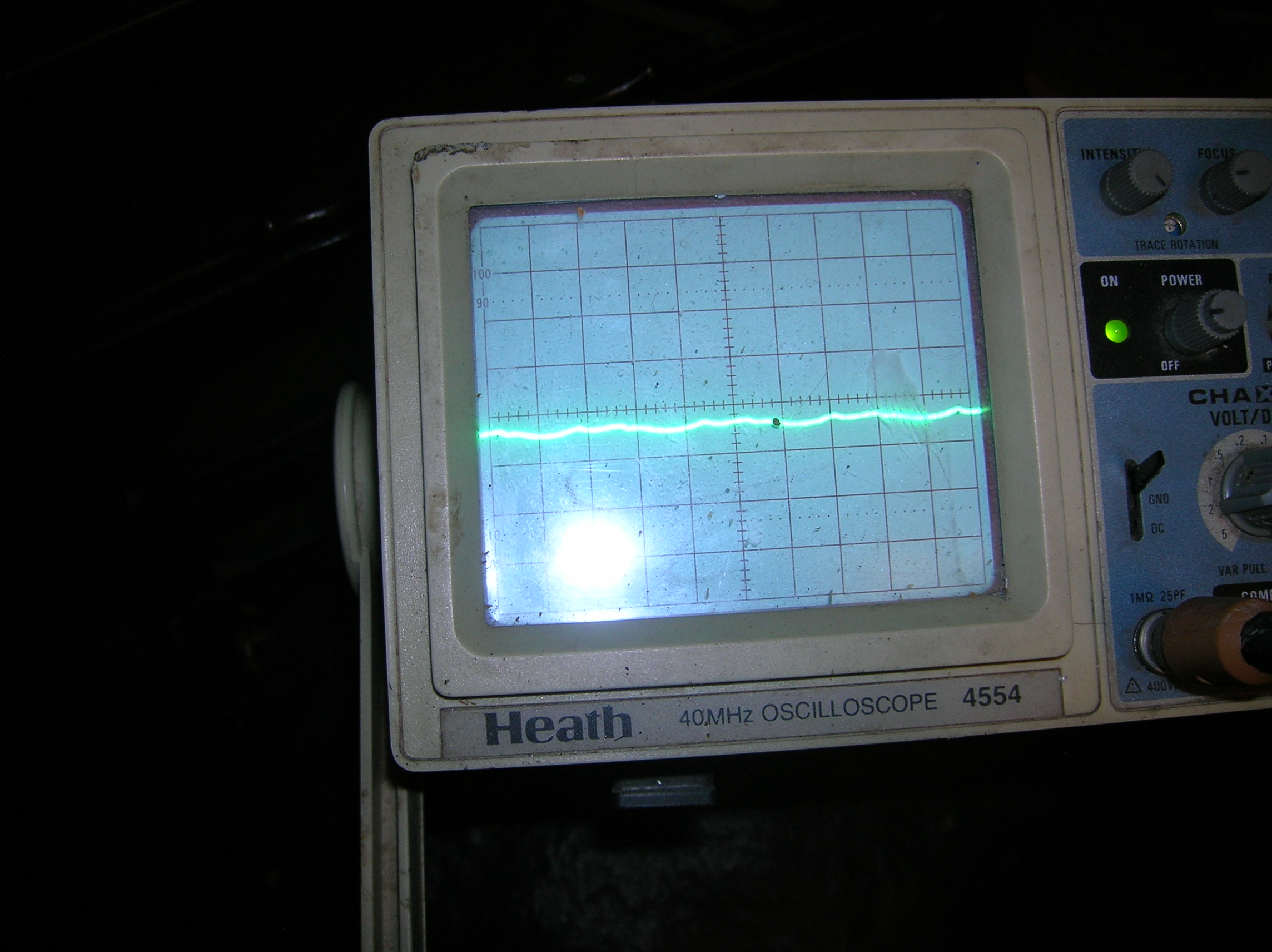

I have a dual trace scope and a signal generator. And the scope has an add function. But if that's the case, couldn't you just put DVOM, set for AC, leads on either phase inverter output and adjust for zero?
I'd use the scope, unless you are sure the meter you have responds accurately at audio frequencies. (I have 3 that do, but they are not the inexpensive handheld examples found on eBay either.) Being able to see the null with a scope makes the adjustment easier IMO.

They look as they should look. Of course you will get the best success when both scope channels are well calibrated and have exactly the same gain. This will set the phase inverter stage to it's optimum. But that's all it will do. Using a THD analyzer on the speaker output will allow the balance adjustment to compensate for non adjustable imbalances in the output stage as well, like mismatched tubes or imbalances in the OPT. But these should be at a minimum anyway and I doubt that you'd ever hear small changes there.How's this look? On the left is 'Dual' on the right is 'Add.'

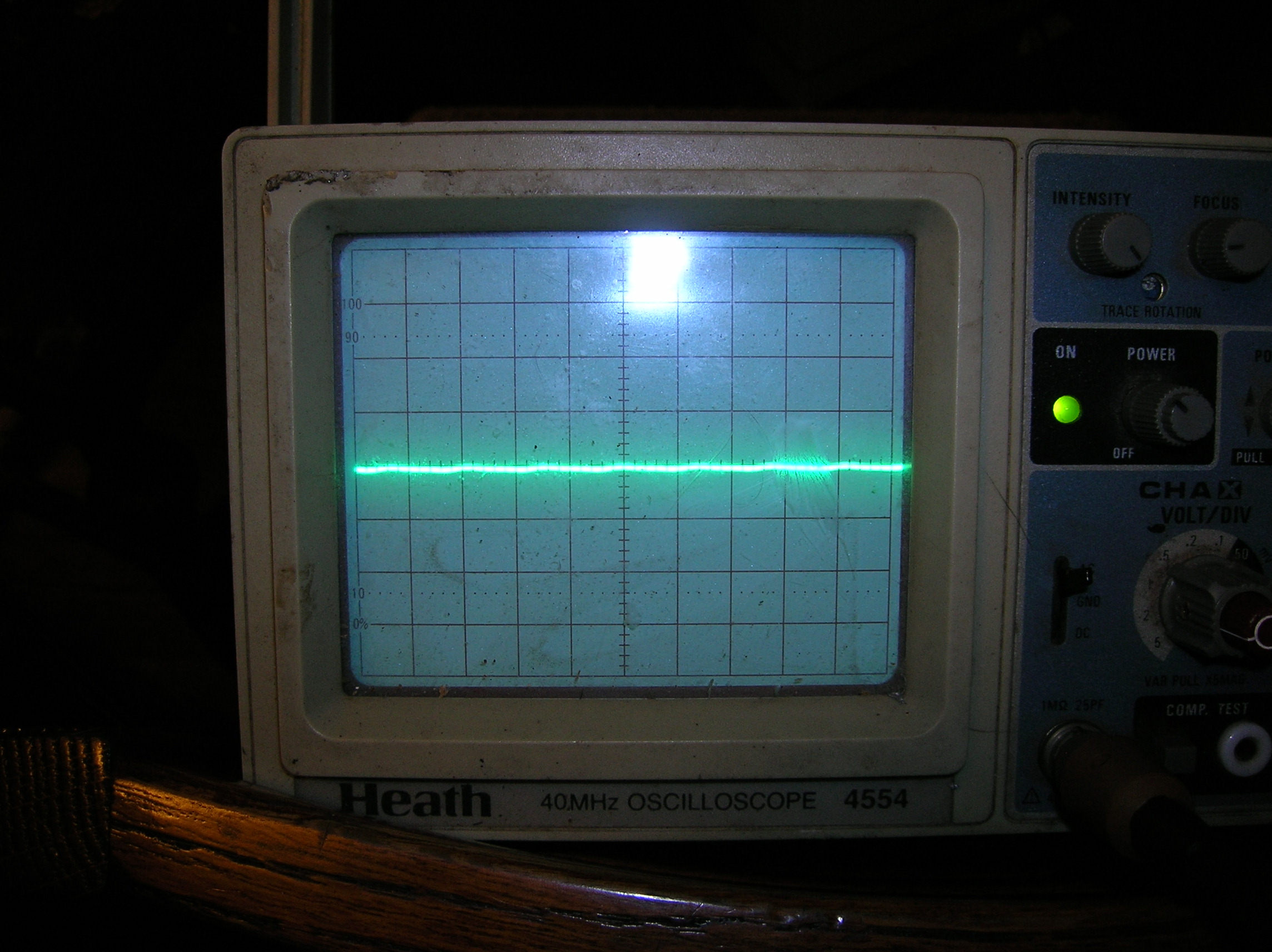

AC Balance Waveform
Does this look better? I used the different leads back and forth so they measured the same waveform. But to get there the settings weren't the same? Is it possible the leads are somehow different? Then I only had a very narrow window on the pot so I had to futz with the in phase plate resistors to get the best adjustment.
I still have a THD analyzer on the way. When I get it I'll try the speaker output method. I'm assuming that will take into account the output transformer and give an even closer adjustment?
Do your probes have capacitance adjusters?
