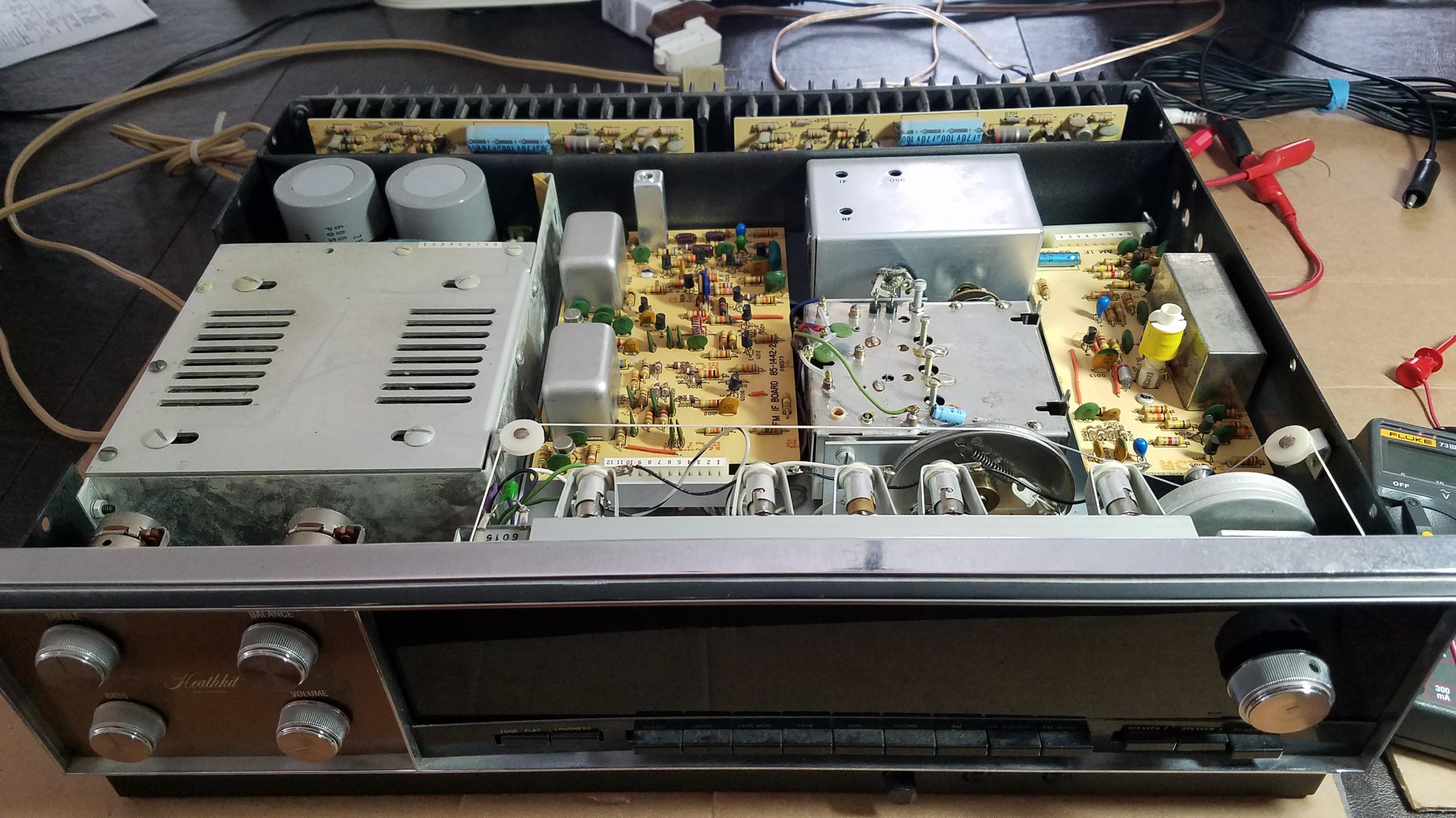

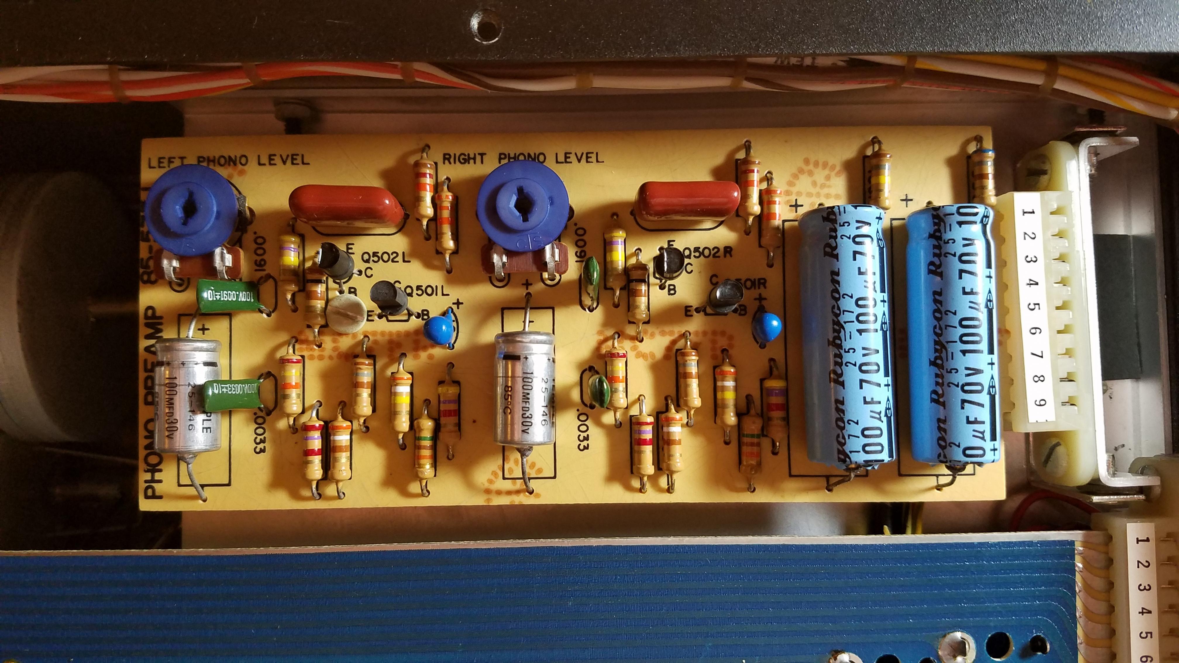

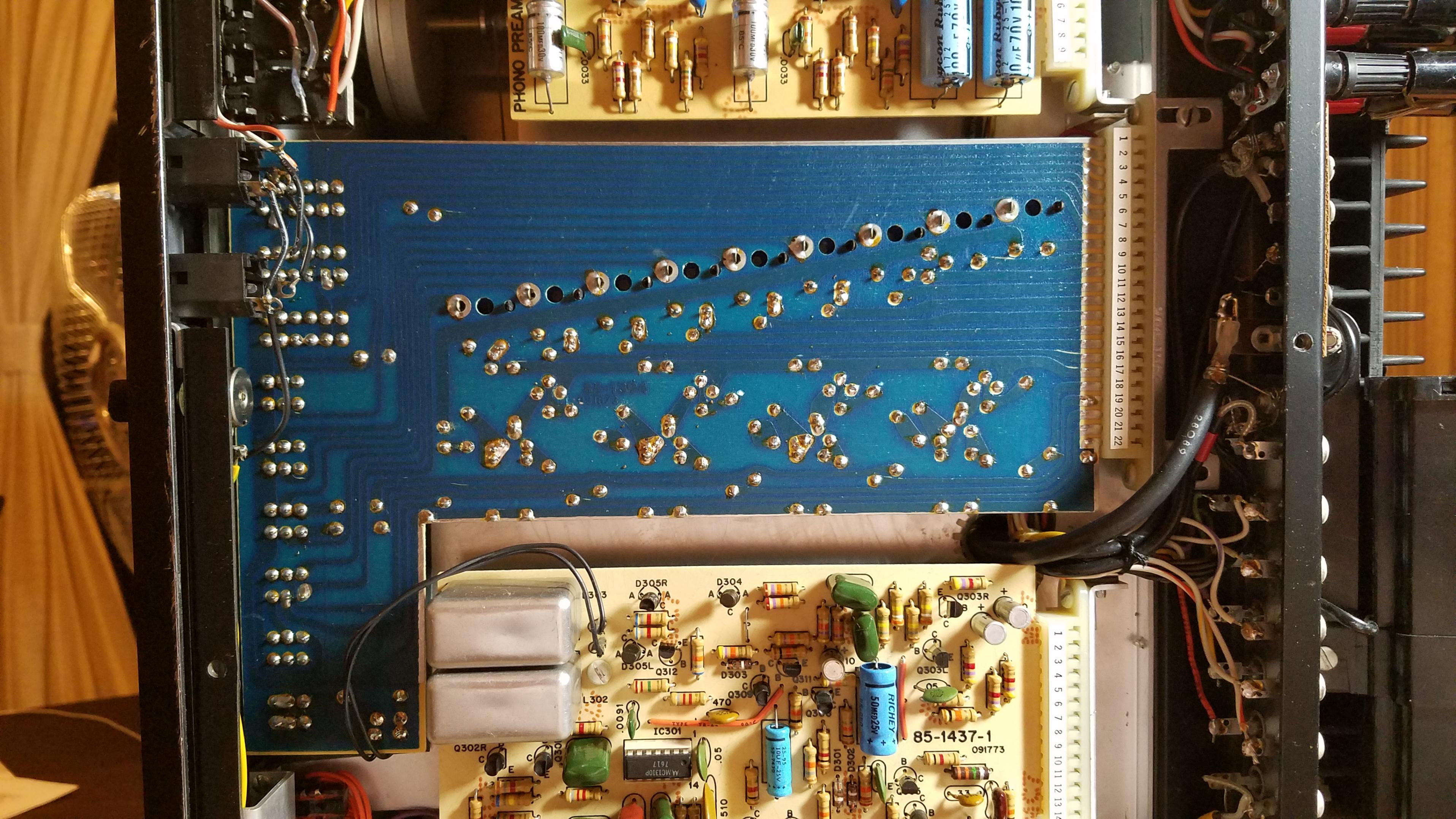

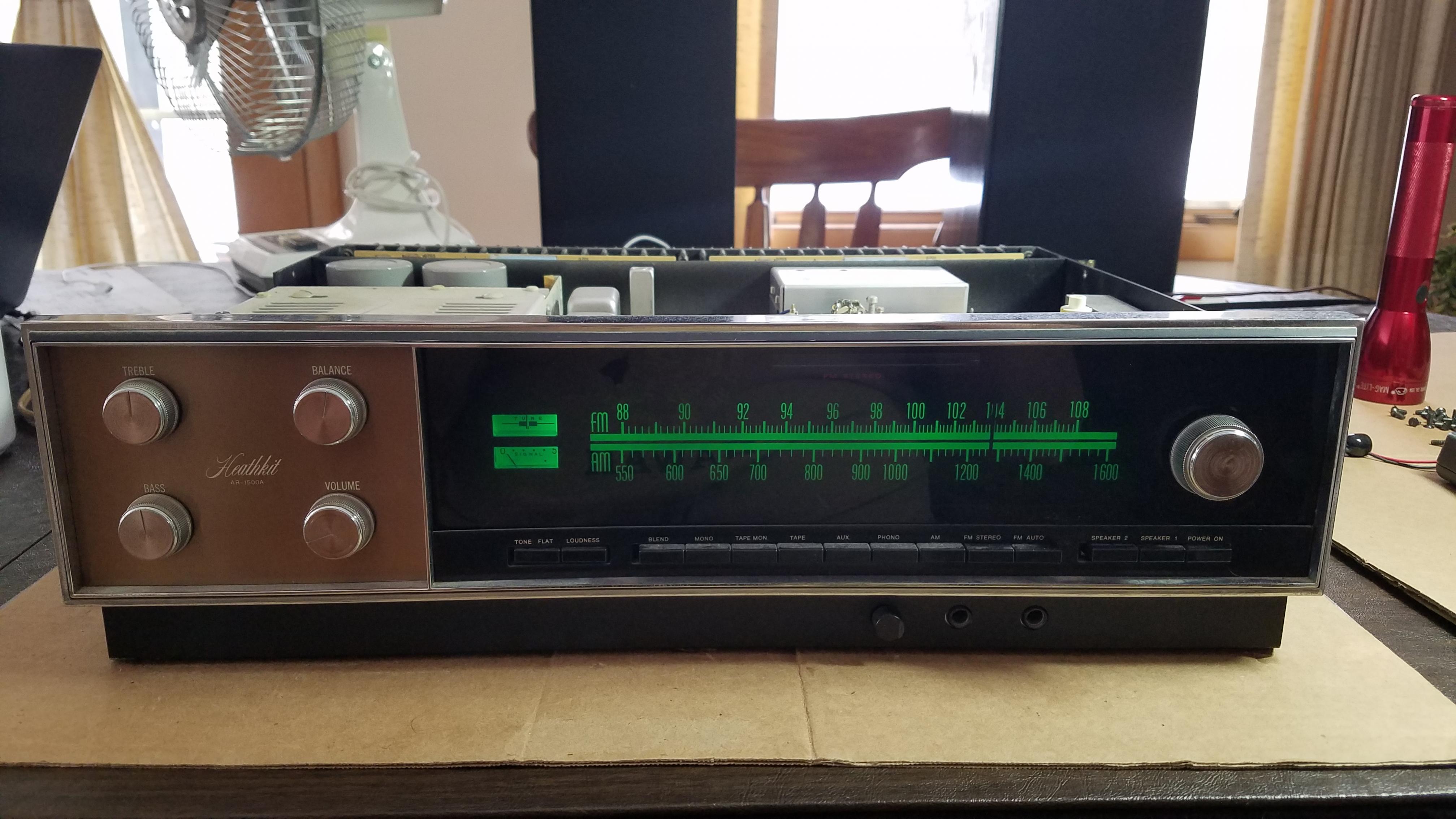

I've recently acquired a Heathkit AR-1500A from my brother. I actually built this thing back in February of 1971, and he has had it since. I've recently started 'collecting', so he dug it out of storage and returned it to me.
Does anyone know the whereabouts of a manual for a Heathkit AR-1500A? Of course I didn't save the one I had from 1971. Can't seem to find anything online.
This thing is *HEAVY*. I fired it up to get the dial lights so I could take a picture. Looks pretty good for a 48 year old receiver. Dusty on the top surfaces but clean on the underside. If I don't say myself, workmanship looks excellent! I'm going to be stripping this down and cleaning it the best I can, and then reassembling, testing, repairing any noted issues, and putting it in my collection.

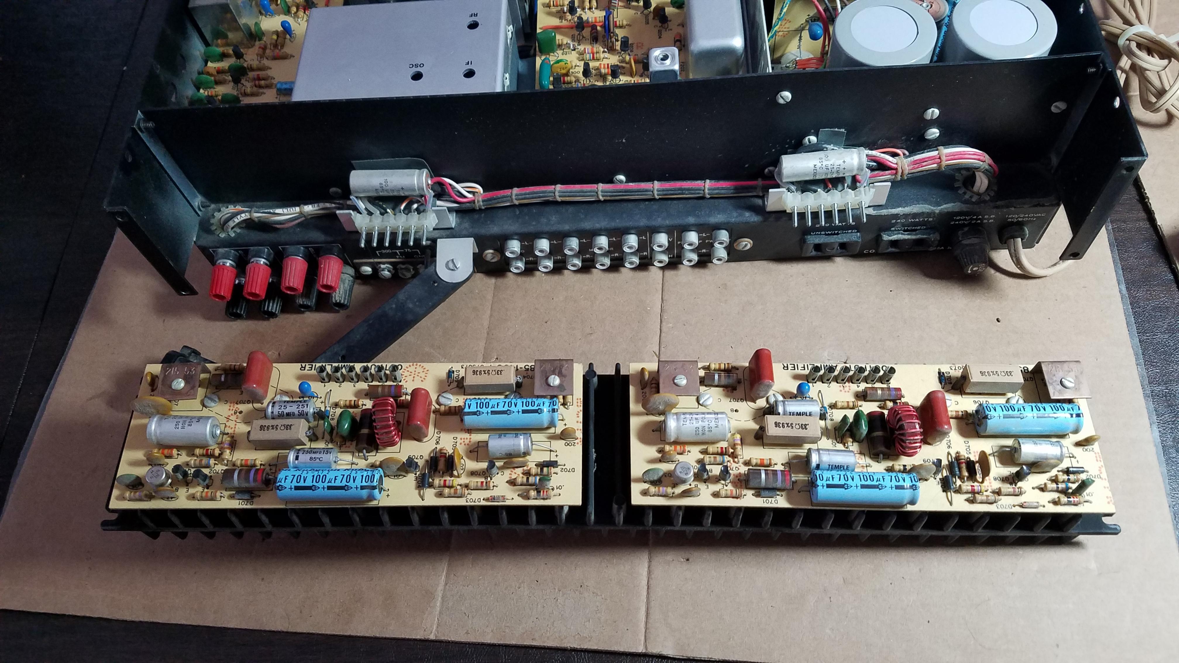

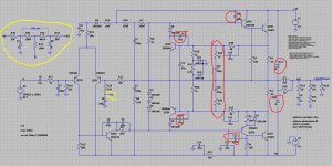

I believe I've complete my work on the output amps on this AR-1500A. Another user was kind enough to send me a schematic of the AR-1500; I compared my boards with the AR-1500 schematic and found the AR1500A has a few added parts in the output amps. See the items circled in Red in the attached.
In addition, as I posted earlier, the output offset voltages were rather high on both channels, and there were no provision for adjustments. I added an offset adjust - it can be seen circled in YELLOW on the attached. Currently, with the unit fully warmed up, I have the offsets adjusted to +2 mV on the right channel, and +1 mV on the left. Idle currents run about 10 mA, depending on temperature, time of day, phase of moon, etc.
I sim'd the circuit using LTSpice, the .asc file is attached. As I could not find models for all of the old Heathkit transistors, so I had to make some educated guesses for substitutes. I'm not extremely proficient with LTSpice, but I think I have everything set up right. The sim looks like it is running very close to true class B, although the actual item has an idle current of 10 mA as mentioned above. Sim'd performance is quite impressive.
With an input of 1 volt peak at 1 KHz, I get an output of 91 watts. At this power level, LTSpice tells me the THD is 0.03%. That's hard to believe... Frequency response is 3 dB down at 2.4 Hz and 58 KHz.
There are many things, most simple, that could be done with that power amp for a large improvement. Bob Cordell, in his Power Amplifier handbook starts with a circuit that is somewhat similar to this and incrementally adds minor improvements. The end result is a distortion reduction of 3 orders of magnitude. This unit has the power supply to back it up as well.
His circuit does start with full complimentary output and current sources instead of the bootstrap capacitors. Other improvements include emitter degeneration resistors and current mirror load on the input stage. Darlington voltage amplifier stage.
