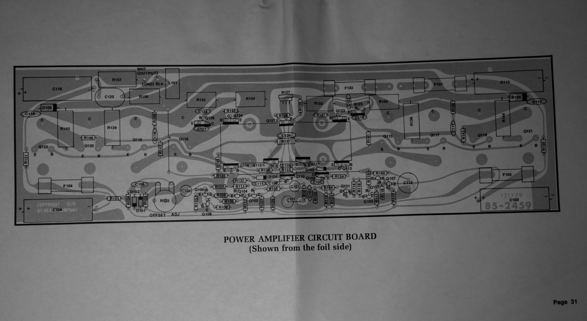

Hi Ben, I just picked up an aa1800 and replaced all output and drivers I checked all other components against the good channel and there must be a transistor that tests good under tester voltages that leaks with real operating voltage. This unit was designed by a sadist. The components are between the heatsink and the pcb. If I could take you up on your offer of the schematic I would be eternally grateful. My e mail is clindhome@gmail.com. This is such a nice unit I would like to save it. Thank you

Amp fixed. Replaced all output and drivers 2 caps and a 47 ohm resistor on the B+ line. The amp is an old school bulldozer. Thanks again.

I was able to obtain a build manual. There was two different fuses installed by someone. One fuse was not right and burned up some components and the board. Now I'm looking for an output board or a parts amp.I missed you message from above.

Why do you need a PCB assembly?
A circuit board can be repaired reliably even if there is a hole burned through. It's work, but can be done. You can also create a new PCB. Depopulate the old one and use it for a drilling guide on a copper clad blank. Draw in the pads, connect the dots keeping to the same routing and etch it. I have saved a few amplifiers, receivers and other equipment by doing this. Lately I draw the PCB up in a PCB routing software, like Eagle or DipTrace. I thien send it out to a board house and get something back superior to the original.

The booklet of larger sized drawings contains a drawing of the actual PCB layout, that might be useful in creating a new PCB.
