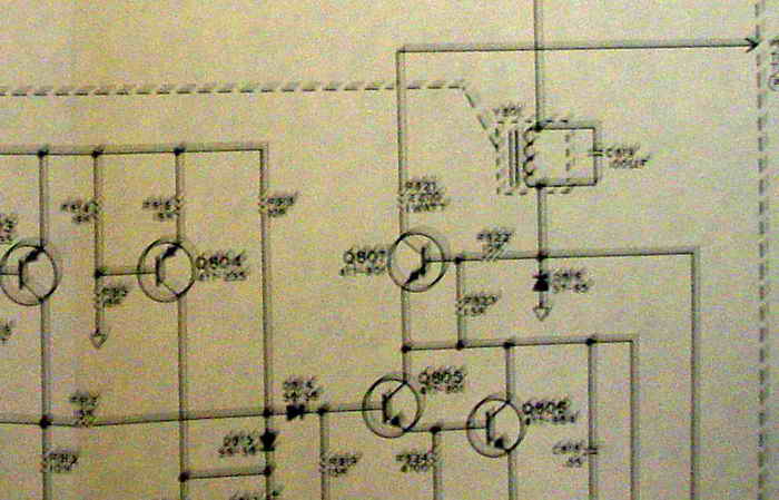

I just bought a Heathkit AA-1600 amp, AP-1800 preamp and the AJ-1600 tuner at a garage sale. All items are, were, in perfect working order then all of a sudden the apm quit working. I noticed on the front of the amp there are two led lights. One is right full power and the other is left full power. The left full power light is now not working. I am an idiot with this stuff. I have all the original manuals, but have no idea what to look for. Anybody out there have a clue? thanks

schematic
Carlos. I email you some close up pics of the schematic. This schematic is poster size and I cannot scan it.
I tried hitting it a few times, but nothing. The unit worked all day today. It was playing at the garage sale and then I set it up at home and it played fine. Then it just quit. Nothing at all from either channel.
Hopefully someone on this forum will know what the problem is since it was a home build kit.

You images were not good....your hands are shacking
the camera must go to a tripod and the shutter need to operate using the timer... not your hands....we shake our hands naturally because heat beats for instance.
Those images, schematics, need a crispy focus to be watched in details, including values.
But i could see you have a protection and a relay to overtemperature...there you may have a problem....you need to check if this high temperature is really happening.... touching metal surfaces (heatskinks) after the unit had operated for 15 minutes half power...maybe a faulty protection circuit that will need to be deactivated.... switched of... disconnected if faulty and if you are not skilled to fix it.
Try, once again, to produce images...but keep the camera using the timer to produce shots without you holding it.
Place the schematic in a place it will receive good ligth and let the camera do the job..... you can even reduce your resolution as this do not need big resolution....1 Megapixel will work fine.

Thanks for the input Carlos, but I repaired it myself. Each channel has a board and at the bottom of these boards are 2 3amp fuses. One of them was blown, so I replaced all four and presto! I quess I should thank God for a $4 dollar repair.
