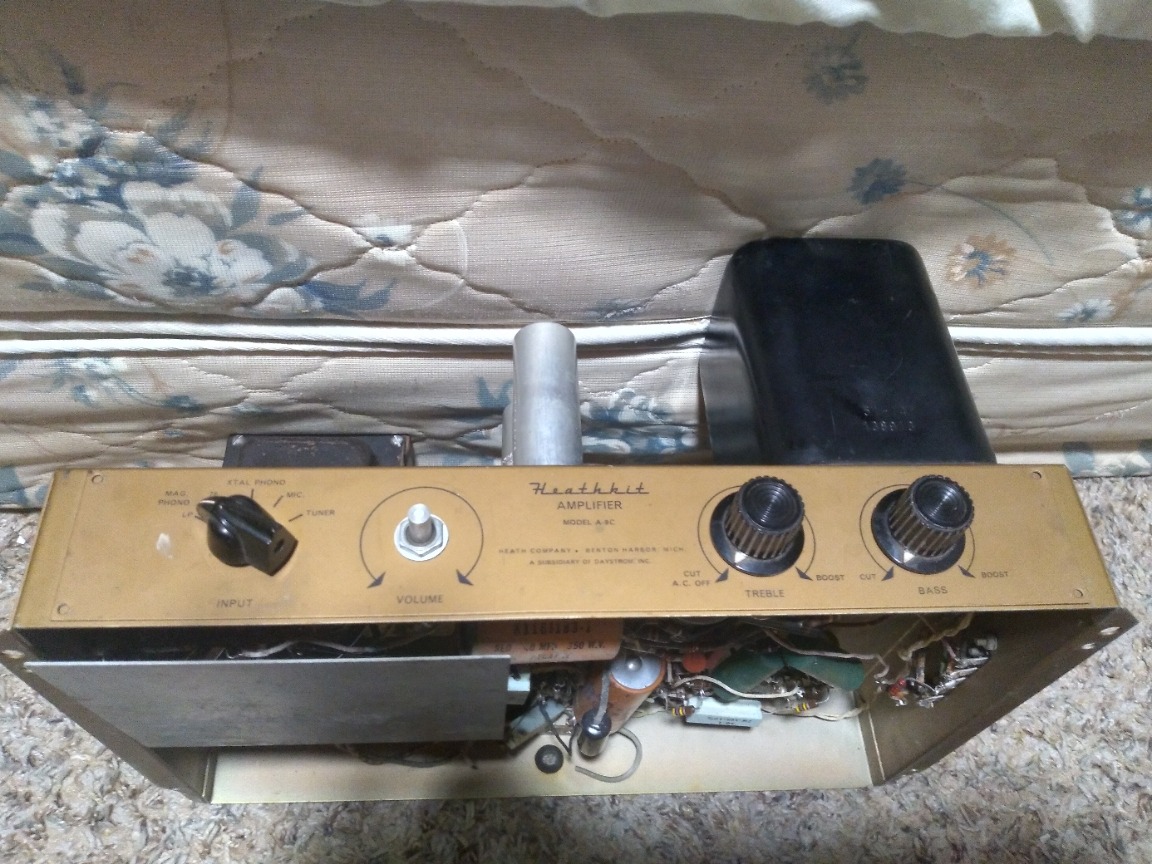

Only Edcor power transformer I found with a bias tap and a close enough HV winding is this one.
https://edcorusa.com/collections/tu...-0-400-300ma-50v-bias-12-6v6-3-0-6-3-3a-5v-3a
It's 800V CT 300mA which is more current than I will ever need.
12.6V 3A CT. I can either wire the 12AX7 and 12AU7 as 12 volt heaters, put them across the whole winding and wire each 6L6 across 1/2 the winding which will give me a current of 1.8A or I can just use 1/2 the 12 volt winding which will give me 2.7A
Odds are I will not need to lower the value of the 560 ohm resistor, but if I need to I certainly can, although replacing it with a choke may be the better option.
I have a Magnavox AMP-142 that used dual 5Y3 and has a filter cap then a 1H choke and another filter cap.
Would 1H be fine for this amp or do I need a larger choke value since there's no filter cap at the rectifier?
If so I'll get this one.
https://edcorusa.com/collections/power-chokes/products/xc63-1h-200ma-1h-200ma-choke
If it had the stock power transformer I more than likely would have figured out something else to do for the bias, but it doesn't and has some unknown transformer in it so I'd feel much better using a new power transformer.

That said because the primary is 115V I'd be most likely replacing the stock transformer anyways so it's just as well it was replaced previously.

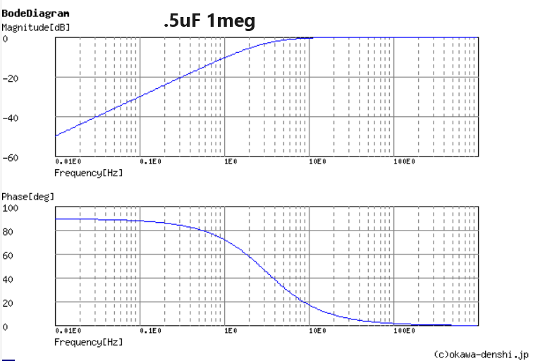

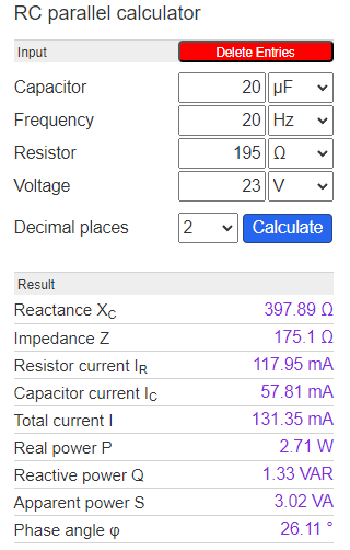

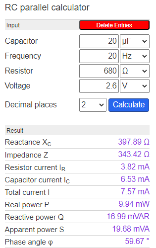

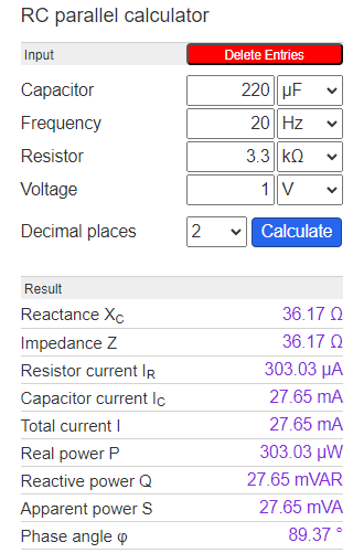

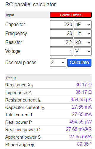

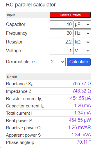

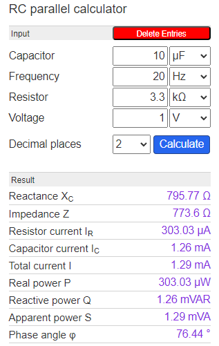

Did some calculating in my spare time today.
For the first 12AX7 stage
10uF cathode cap 2.2k cathode resistor
To get minimal phase shift I will need a 220uF cap.
For the second 12AX7 stage.

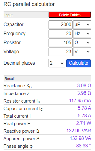

Output stage
Now to get zero phase shift I'd need a 2,000uF cap and now we see why fixed bias is better for HI-FI amps that are used full range.

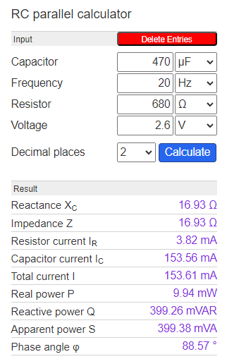

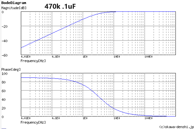

For the tone control stage.
I'd need a 470uF cap
For those calculations the voltage I put was the voltage on the schematic and I think the calculator was wanting the AC voltage so the currents and power may not be correct. Phase angle, reactance and impedance are correct though.
Coupling cap to first stage (ignoring the phono preamp which has no input coupling cap), second stage, third stage, fourth stage and fifth stage. They all use 1 meg resistors and the tone control circuit is likely close enough to 1 meg impedance to where it will work for it as well.
I'd need a .5uF cap
Coupling cap to output stage.
I chose 1uF as I'm going fixed bias and will need to lower the 470k grid resistors to 220k when going fixed bias, with 1uF giving me basically zero phase shift at 20Hz.
Keep in mind the goal is to eliminate low frequency phase shift which will also eliminate the potential for low frequency instability.
It will also improve the bass response as the amp will then basically be flat to 20Hz provided the output transformer can handle 20Hz properly.

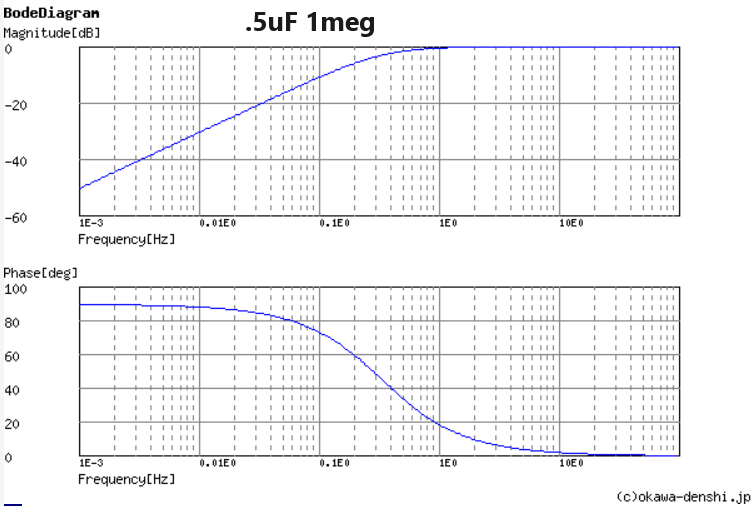

In the first graph that says .5uF 1 meg it should be .05uF 1 meg. I'll use the next higher standard value of .68uF.

A better way to understand the issue would be that it's not possible to eliminate low frequency (or high frequency, for that matter) phase shift, but only to move it around. Attempts to "brute force" a solution with all the CR poles pushed down below the OPT primary inductance pole are unstable in practice because the OPT primary inductance varies with signal level, moving its pole with increasing signal in the direction of the CR poles (less stable) and the power supply decoupling time constants. You really want to set a dominant CR pole in a feedback amplifier of multiple poles.Keep in mind the goal is to eliminate low frequency phase shift which will also eliminate the potential for low frequency instability

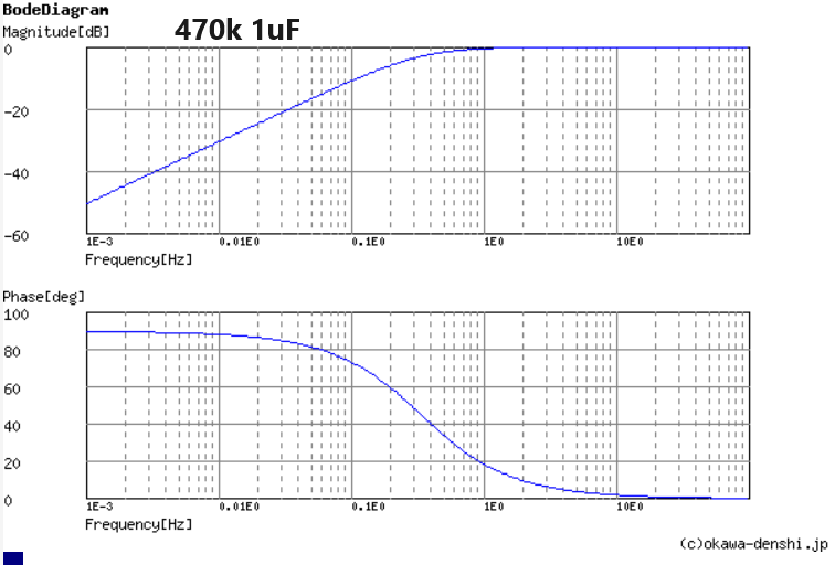

The last amp I did this with there was next to no phase shift at 20Hz with the amp staying 100% stable, however that one I used a new Edcor output transformer, whereas this amp uses the original Heathkit output transformer.
Take the last graph I posted.
For the 470k control grid resistor and 1uF cap here's the CR poles.
|p|= 0.33862753849339[Hz]
Pole(s)
p = -0.33862753849339[Hz]|p|= 0.33862753849339[Hz]
Not trying to rain on your parade, just reminding us all of basic stability issues. The earliest discussion I'm aware of was in the revision to the DTN Williamson amplifier, way back when, but still applies and quite well explained.
