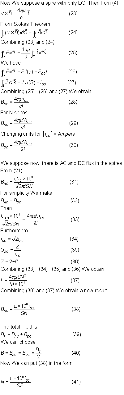

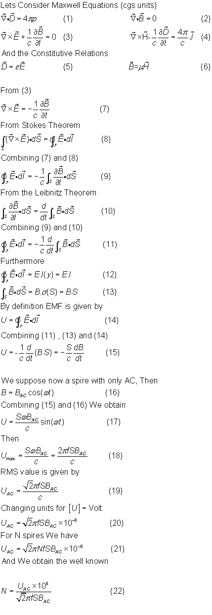

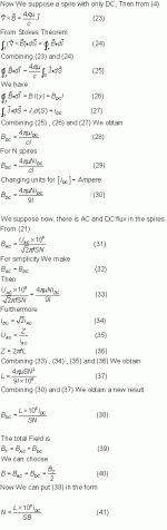

Magnetic field strength on a charged particle is of the form
F = q v x B
First, because the product vector, is tangential force, on the other hand we are talking about small speeds and fields, then its effect is almost negligible in the case we are concerned.
In the case of a permanent magnetization of the cathode, the interaction of the magnetic momentum is also negligible due to the chaotic movement of the electrons emitted by thermionic effect.
Do not make me do the math, that are complicated, and today is Sunday.

F = q v x B
First, because the product vector, is [a] tangential force,[;] on the other hand we are talking about small speeds and fields, [ - so] then its effect is almost negligible in the case we are concerned.
Moreover, its irrelevant.
One can only talk of a 'tangental force'
in relation to a previously specified direction.
You are unaware of what you are talking about.
Since the cathode, heater, and surrounding apparatus
is a complex 3-dimensional structure with multiple directions of possible electron paths, your point is worthless.
This is correct.
But since you are incapable of forming proper English sentences, this last perfect sentence has been cut and pasted from a book or webpage.
Don't worry, there is no danger of me "making you do the math."Do not make me do the math, that are complicated, and today is Sunday.

Excuse the quality of attachments, were made with MathType, and the only way to upload that came to mind was this.
For an Ideal loop where an AC current i(AC) flows with a voltage U(AC), from equation (20), the AC magnetic field is given by
B(AC) = [ U(AC) x 10^8 ] / [ sqr (2) * (Pi) * S * f ]
Clearly only depends on the AC voltage, not AC current.
For an ideal loop where a DC current i(DC) flows with a voltage U(DC), from equation (28), the DC magnetic field is given by
B(DC) = [ 4 * (Pi) * u * i(DC) ] / ( c * l )
Clearly only depends on the DC current.
The confusion of some members of the forum, lies in the fact that whenever we have a current, we also have a voltage, and vice versa.
I regret to say that I was mistaken when I thought I was wrong.
What I said in post # 3 is correct, I was wrong when I apologized in post # 7
I have checked my calculations and are correct.
