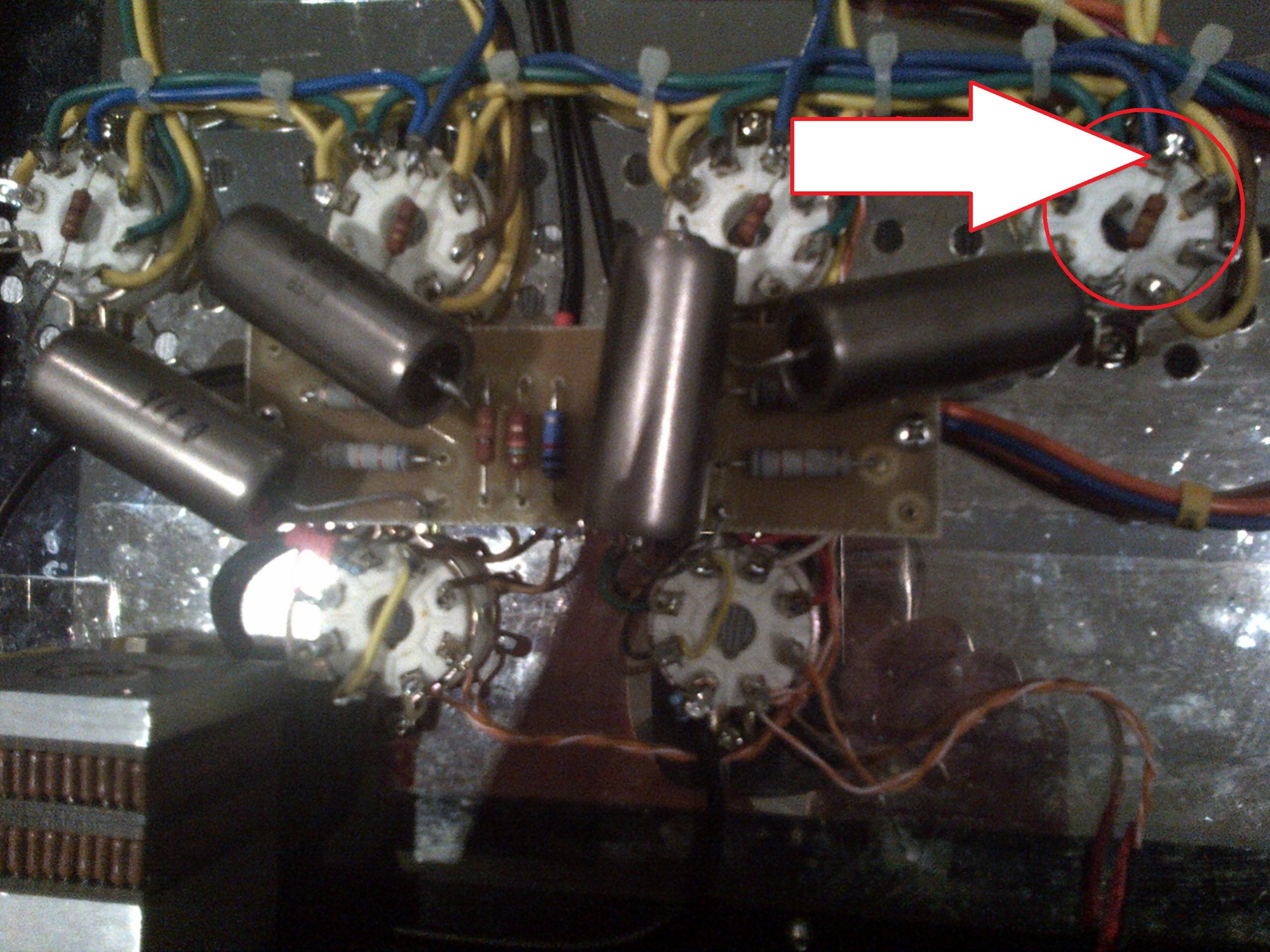

The heater circuit must not be left floating, it should be referenced to common, or to a positive voltage to reduce coupled AC hum. The power tube's cathode (if cathode biased) sits at a positive potential.
But that's not the way to do it: the 6.3v AC center tap should be referenced, not one of the AC lines. If the power transformer 6.3v does not have a center tap, one can be made with two 100 ohm series resistors, and the reference will be taken between these two resistors.
If you don't have the diagram for this to verify the heater circuit, then as Vincent posted about the 2 resistors, you will likely trace it back from the cathode and find a "hum pot" or 2 resistors already across the tranny heater windings. Very common.
Check out Dynaco ST35 schematic. The cathodes of output tubes are connected to the heaters directly.

Another possibility is a centertapped 6.3v but with a blocking cap on the CT.

The reason for this , is to elevate all heaters to around +12 Volts, to minimise noise. I hve seen it in a Magnavox schematic with EL84's I think.
You are all correct in the case of this circuit - there are two resistors across the transformer, but only for the heaters of the driver tubes, whereas the power tubes have the heaters connected to the cathode.

Whilst carrying out some modifications on a 6V6 amp, I noticed that on one of the tubes the heater (6.3V AC) is linked/soldered to the cathode. See attached pic.
What purpose does this serve?
I may be mistaken, but when I look at your photo I see the soldered joint between pin 1 and pin 2. Assuming I am correct, the cathode is not connected to the heater. Rather, pin 2 which is one of the heater pins is connected to pin 1. Pin 1 is a ground connection pin assignment for older metal 6V6 which most people have not likely encountered since most all later 6V6 varieties are glass. Many people have taken advantage of the typically unused pin 1 tab as another junction node for wiring purposes. In your case it looks like pin 1 is a ground point as when you follow the wires connected to pin 1 they all appear to connect to all pin 1's of the 6V6 tubes and you can also see one end of what looks like a 100k grid leak resistor connecting to each. Mickeystan.
