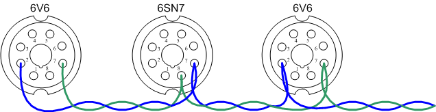

I use Visio. I created my own stencil for schematics and layout. I add new items to the stencil as I need them so not all components are represented, but it works from me. If people are interested, I will find a place to post it for download.
The layout items are all drawn by hand to scale. For example, I traced an engineering drawing of a Kiwame resistor for the resistors, then scaled the height and width based upon the manufacturer's specifications. I did the same with the socket.
This lets me rotate and place the virtual components first to find a good layout. Of course, I have yet to try to convert a virtual layout to a real one.

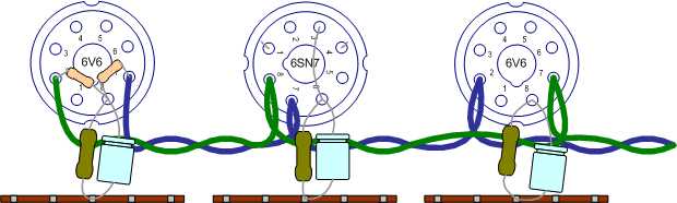

Should the resistors forming the virtual CT be 100R or 100K R?
I wrote 100K because of what Tomchr wrote above, but Tom Bavis said 100R. I'm not sure.
Do I simply attach 100K ohm resistors from pins 2 and 7 to pin 8 on the last tube socket?
I'm building a 5e3 Deluxe clone and am currently wrestling with a similar question. My interpretation of the kit company's schematic is using 100 ohm resistors from 2 to 7 and 7 to 8 on the 6V6 sockets (both on one socket, or one on each 6v6 socket). As far as I can tell, the pin 8 of one of the 6V6 sockets is tied to ground so tying to pin 8 piggybacks on that ground connectoin. This seems to be an alternative to flying resistors to ground as I've read elsewhere online. I'm very new at this and don't want to steer you in the wrong direction.
