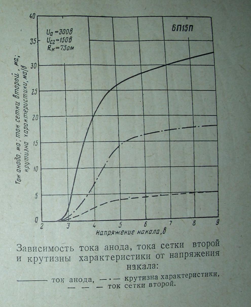

The tubes are spec'd to perform within 10% of 6.3 volts. That would mean the range of 5.67 to 6.93 is within the manufacturer's spec's. But I've done some experiments with a variable voltage bench supply and looked at the audio waveform on a scope. I can typically go down to about 5V before I could see a difference.
Also tube life is strongly related the heater voltage. I've been using a resistor in series with the heaters to lower the voltage to 6.0V
Most tubes you want to run at their rated heater voltage, though some small signal level tubes can be more linear at around 85% their rated heater voltage.
Like the 12AV6 and 12AX7, and detector diode tubes like 6AL5.

Interesting plots. One thing to watch is that a cooler cathode may be quieter at low currents, but if operation starts to stray into the temperature-limited region then space charge smoothing of shot noise no longer operates so noise gets worse.
