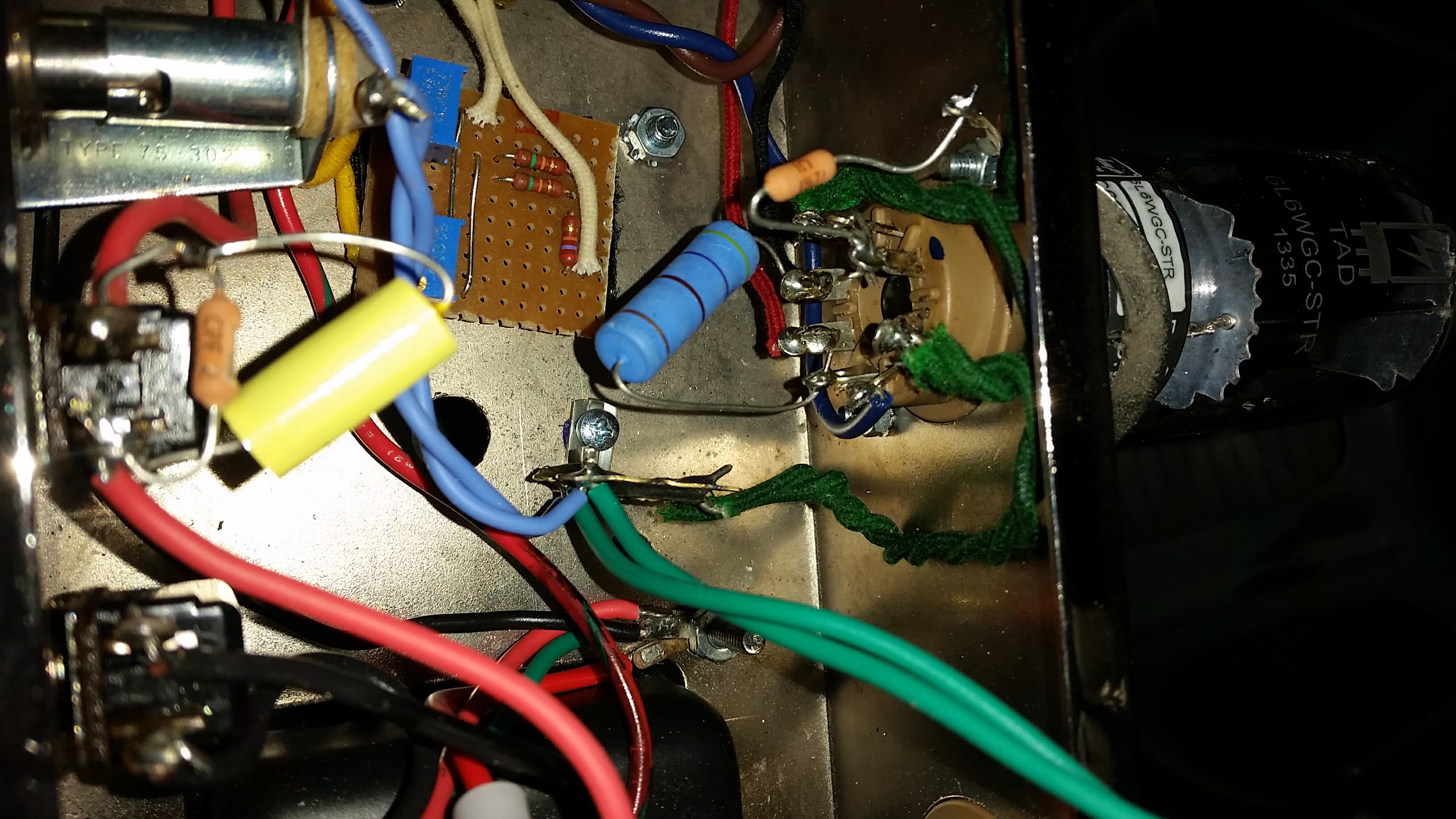

Hi, I have a 5F6A clone whit a heater voltage too low. PT is a Hammond 290DEX wich has a primary winding 240VAC and heater 6.7VAC nominal voltage unloaded.
In my house wall voltage is a range of 205-220 VAC and I measured 6.2 VAC heater voltage at PT wires. When I connect heater wires to tube sockets I measured 5 VAC heater voltage. I think this volage drop is too much considering that all tubes absorb about 2.7A and PT secondary heater has 4A

Since all tubes plus pilot lamp absorb around 2.8A, how much should be drop voltage at heaters? With primary drop of 8% I get around 5.9V loaded heaters, with primary drop of 14% I get around 5V loaded heaters. Is it a reasonable drop voltage?
Do you mean use two 5V6GT in place of my 6L6 and power its heaters with 5V. After put 5V and 6V together in series and get 11V, convert it to DC and power preamp heaters?Speaking of the 5V winding and boosting the voltage using it, this might be your easiest solution although not with the 5V winding. Using a 220V to 15-20V transformer and putting the 15-20V winding in series with the Hammond primary winding to give the primary the proper voltage.
Exact! Obviously, since my wall voltage is unstable, when transformer run at 205V a drop is around 14% and no load heater voltage is 5.8VWhen running a 240V transformer off 220V you can expect a drop in secondary voltage of around 8%.
This is consistent with your drop in no load heater voltage from 6.75V to 6.2V.
The drop to 5.0V under load remains unexplained.

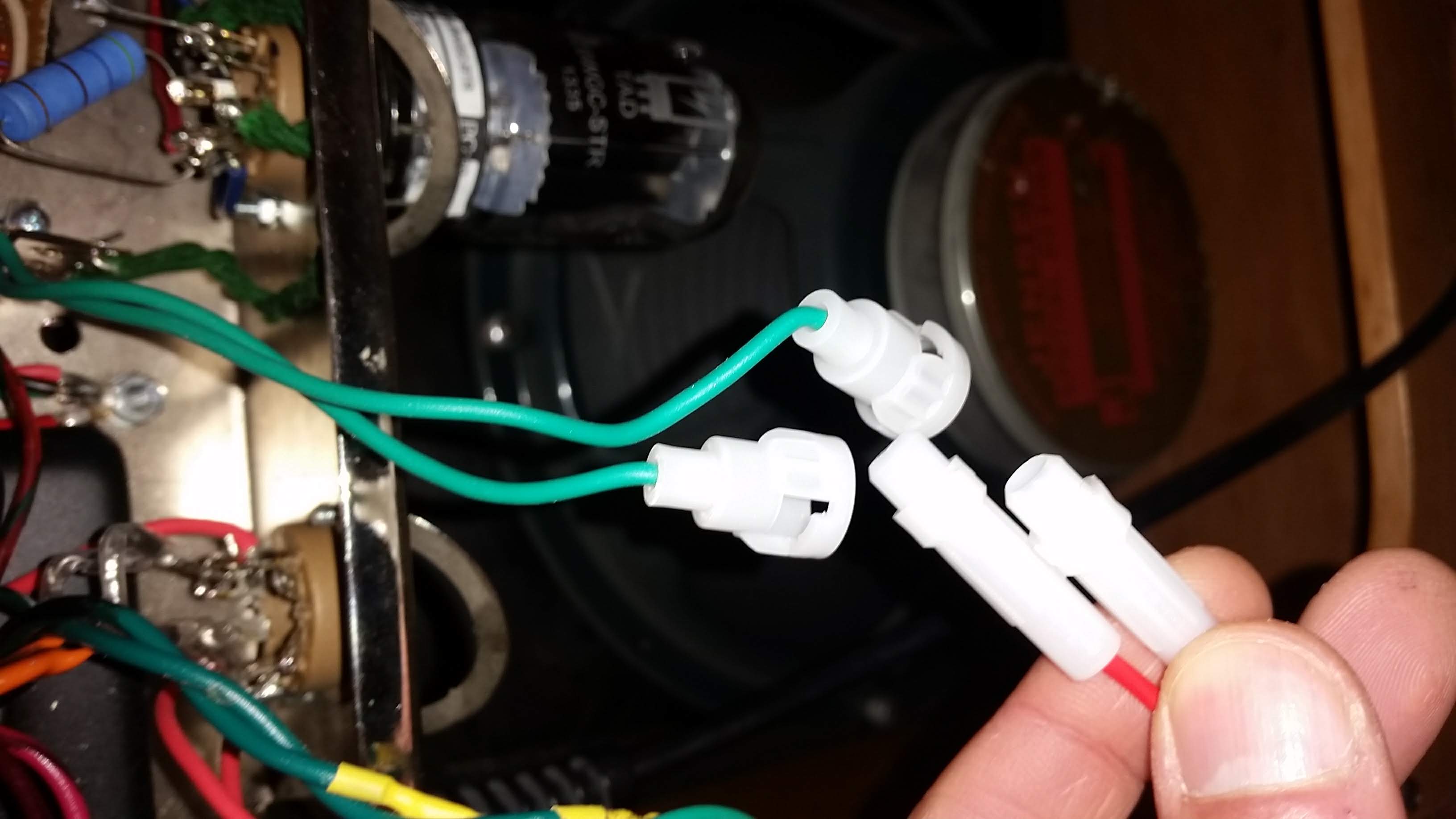

I noticed that fuse holder that contain 4A fuse for heaters wires were hot, I do not know if it is normal

The heater voltage should be right if the mains is right and the transformer is rated correctly.
In your case the mains is upto 10% down so that means the heater voltage will be 5.5VAC.
Temp solution would be to use auto transformer to lift voltage back up.
Or use DC heater volts and regulate it.
Or buy separate transformer with 6v3 plus +10% with current rated well within what heaters will take.
